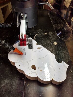

Tallbald Posted April 20, 2023 Report Posted April 20, 2023 (edited) Have a small selection of Pegas MGT and Olson blades from #1 to #5. Few small radii. Suggestions for starting blade appreciated. Thank you. Don Edited April 20, 2023 by Tallbald OCtoolguy 1 Quote

Tallbald Posted April 23, 2023 Author Report Posted April 23, 2023 Today I jumped in and cut the prepared 1 inch thick oak (rescued stair tread offcuts from a neighbor's remodel job) into a delightful interlaying elephant family decoration I found in a book I bought. My Jet 18 inch saw and the Pegas 7R MGT blade took the piece in stride. This was my first serious, planned piece and honestly it was a rather zen-kinda experience with my mind focused well on the cut line and Journey, Tina Turner and Cher playing on the radio in the shop. Following suggestions gleaned here and elsewhere I used the painter's tap, spray adhesive, pattern then packing tape layering prep method and it worked really well. No burning, smooth cutting and well fitting parts. My daughter will be tickled with the results. She is an "elephant fanatic". Thanks everyone for your suggestions. Don Quote Wichman, barb.j.enders and OCtoolguy 3 Quote
