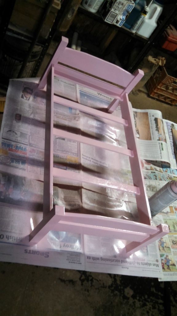

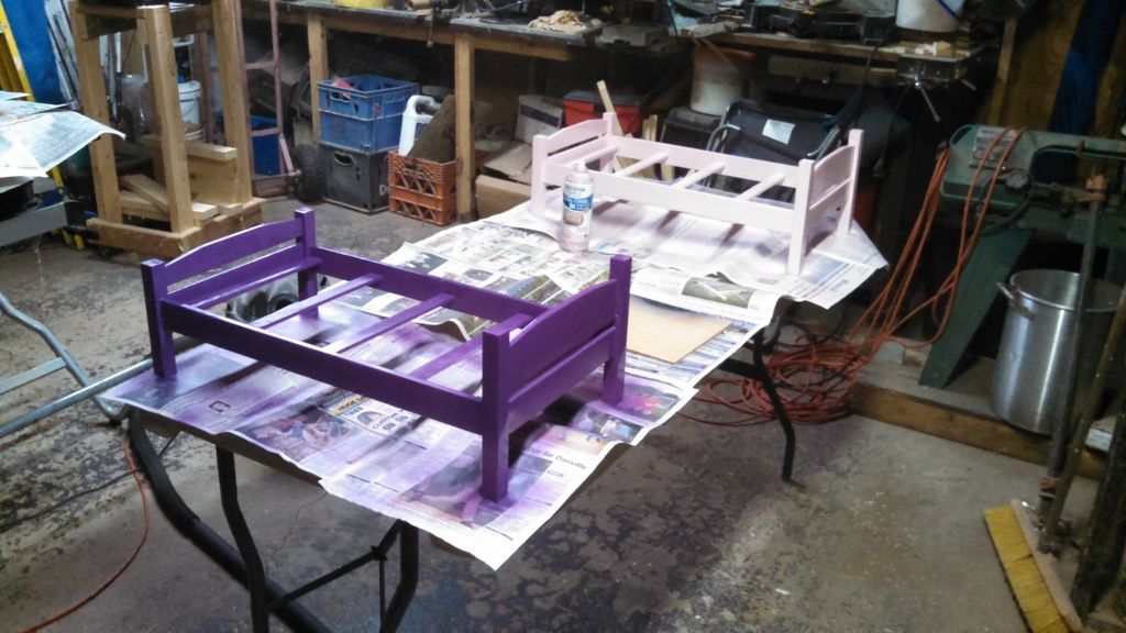

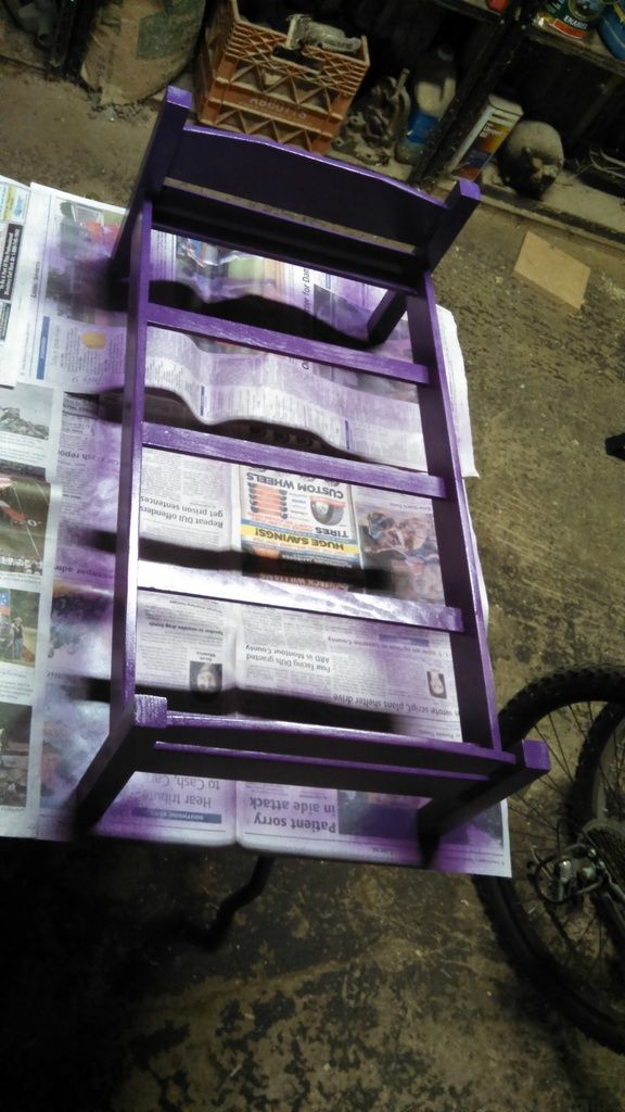

CMHN Posted October 23, 2015 Author Report Posted October 23, 2015 I have a couple beds made that I am finishing up. Here are a few paint photo's. I had these 2 started and glued up since last spring, just never got around to get them painted and finished up. When I start making new ones I will show some in process photo's of them. Quote
