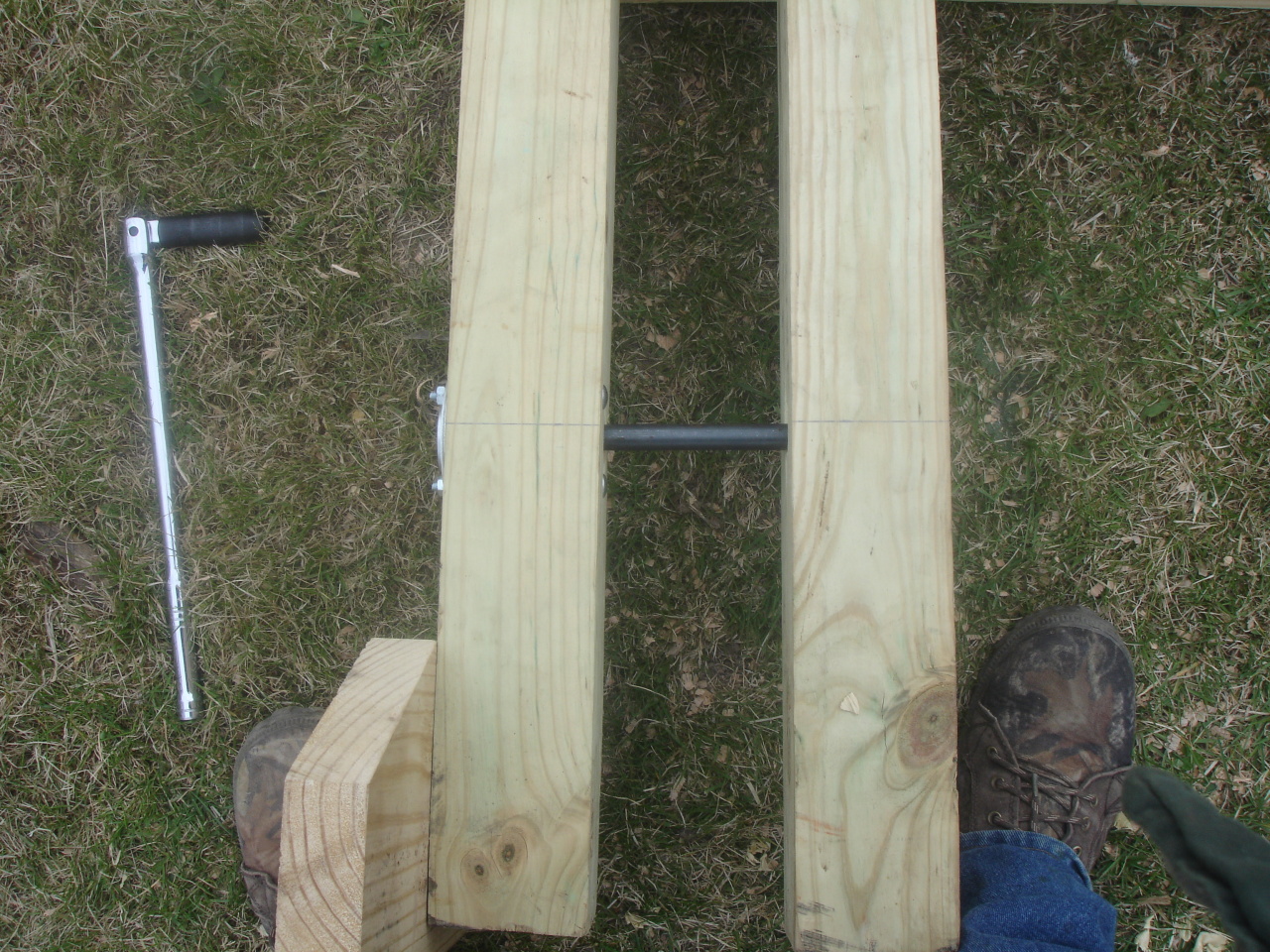

blame Posted March 25, 2009 Author Report Posted March 25, 2009 today's been a really busy day but i found some time to work on my lathe project abit i'm working on this in the tractor shed not much room :( Quote
