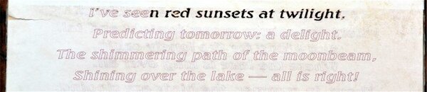

Well, that did not work out very well!  I used 6mm thick plywood rather than the 3mm thick ply that I used for ‘I Long for the Northland’.  I thought that the thicker panel would  make it more difficult for me to go off-track when cutting.  That turned out to be true.
But I ran into a problem.  The thicker panel is too heavy for me to hold up with one hand while threading the saw blade up through the hole from below.  In cutting 21 letters, I broke about 20 blades:
HeavyPanel-Ibrokeabout20bladeswhilecuttingonly21letters.thumb.JPG.312afe42c8393e556d36cf4373cdf4b0.JPG
Only one blade was broken while cutting.  All the rest were broken while attempting to bottom-feed.
I gave up with the heavy panel and glued the revised pattern to a 3mm thick Baltic Birch plywood panel.  I also took the opportunity to tweak the wording of the poem.
I've done a bit of cutting and, so far, have not broken any blades
