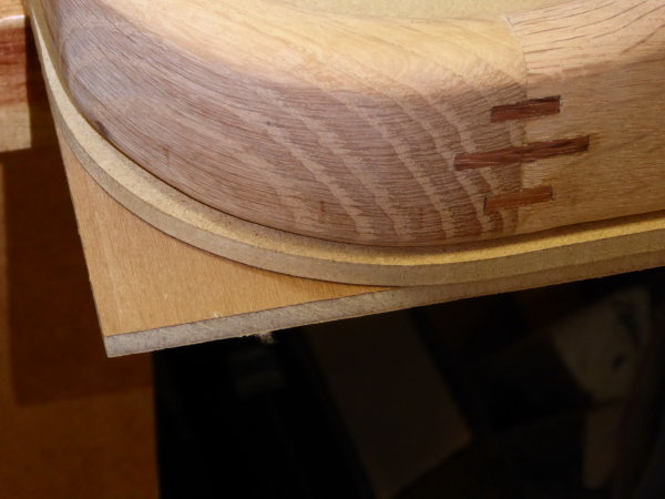

The bottom is 1/4" cherry, mdf core, pw. Here's the process I used. I "sandwiched" and held together with double sided tape: a) the cherry pw; b) 1/4 hardboard for a template; c) the glued up tray. See pic
I then routed the perimeter with a flush trim bit, guiding against the sides of the tray, cutting both the template and the bottom. (The tray is removed in this pic for clarity)
