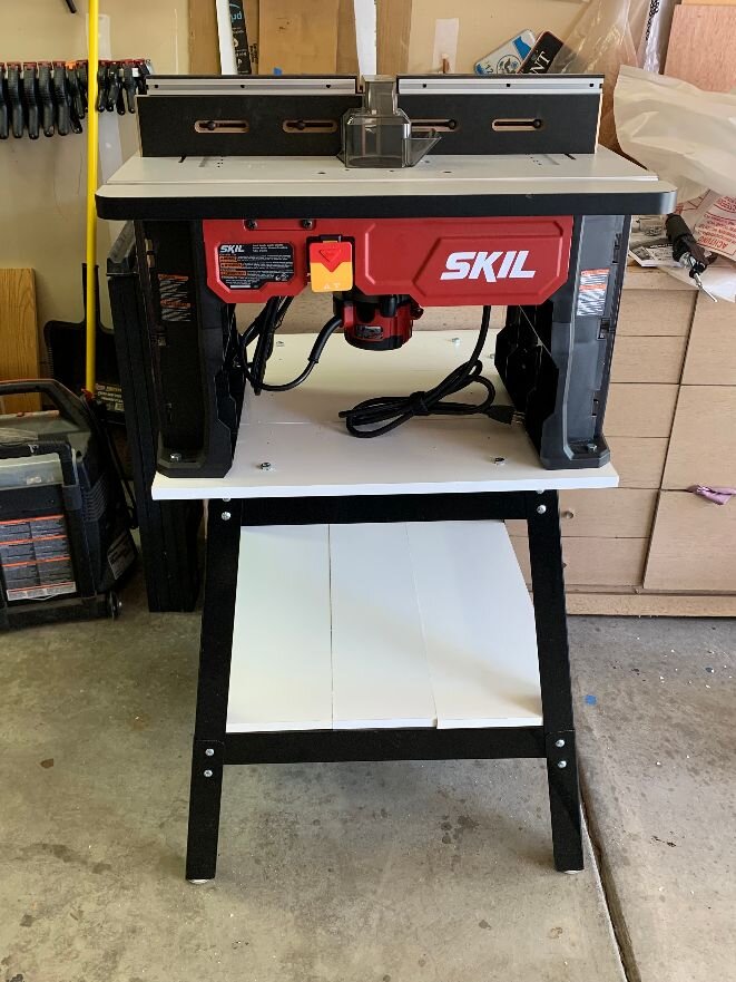

jerry walters Posted May 2, 2025 Posted May 2, 2025 My Christmas and birthday present to myself was a router table and router. After getting it assembled and placing it on a workbench it seems too high to operate it safely. I would like to know what some of you have done to perform routing procedures safely. I thought of placing the router table on a black and decker workmate with the legs folded. That would place the top of the router table at 37 ½ inches high which seems to be the right height for me. I’m a bit height challenged standing about 5’ 6”, shrunk some since my high school days. I’ve looked for tool stands that I could place my router table on, but to no avail. Suggestions would be much appreciated. Thank You, Jerry OCtoolguy 1 Quote

Wichman Posted May 5, 2025 Posted May 5, 2025 HF has a universal too stand that is height adjustable. The lowest setting would put your router table at 39 inches off the floor, assuming you RT height is 13". When I put my tall tools (RT, bench bandsaw, belt/disk sander) on the miter saw stand, their tables are at about 45" off the floor. That height works well for me (5' 9") as I have back and shoulder issues. I use that high a work surface for drilling holes for fretwork with my Dremel plunge router accessory. https://www.harborfreight.com/universal-tool-stand-69805.html jerry walters and OCtoolguy 1 1 Quote
jerry walters Posted May 11, 2025 Author Posted May 11, 2025 On 5/4/2025 at 8:57 PM, Wichman said: HF has a universal too stand that is height adjustable. The lowest setting would put your router table at 39 inches off the floor, assuming you RT height is 13". When I put my tall tools (RT, bench bandsaw, belt/disk sander) on the miter saw stand, their tables are at about 45" off the floor. That height works well for me (5' 9") as I have back and shoulder issues. I use that high a work surface for drilling holes for fretwork with my Dremel plunge router accessory. https://www.harborfreight.com/universal-tool-stand-69805.html Took your advice Wichita, made a trip to Harbor Freight. The first employee sent me to the wrong area. Chased down a second employee and asked him for a height adjustable tool stand. Told me there where no such tool stand. Told him it was on the web site. He took a peek and when to another area but told me the one there was not adjustable. I looked at the box and it said it was adjustable. I told him his day was not wasted because he learned something new. Brought it home and assembled it. Lot easier to assemble if you have a helper. Thanks for the tip Wichita. Attached is a picture. OCtoolguy and Wichman 1 1 Quote
