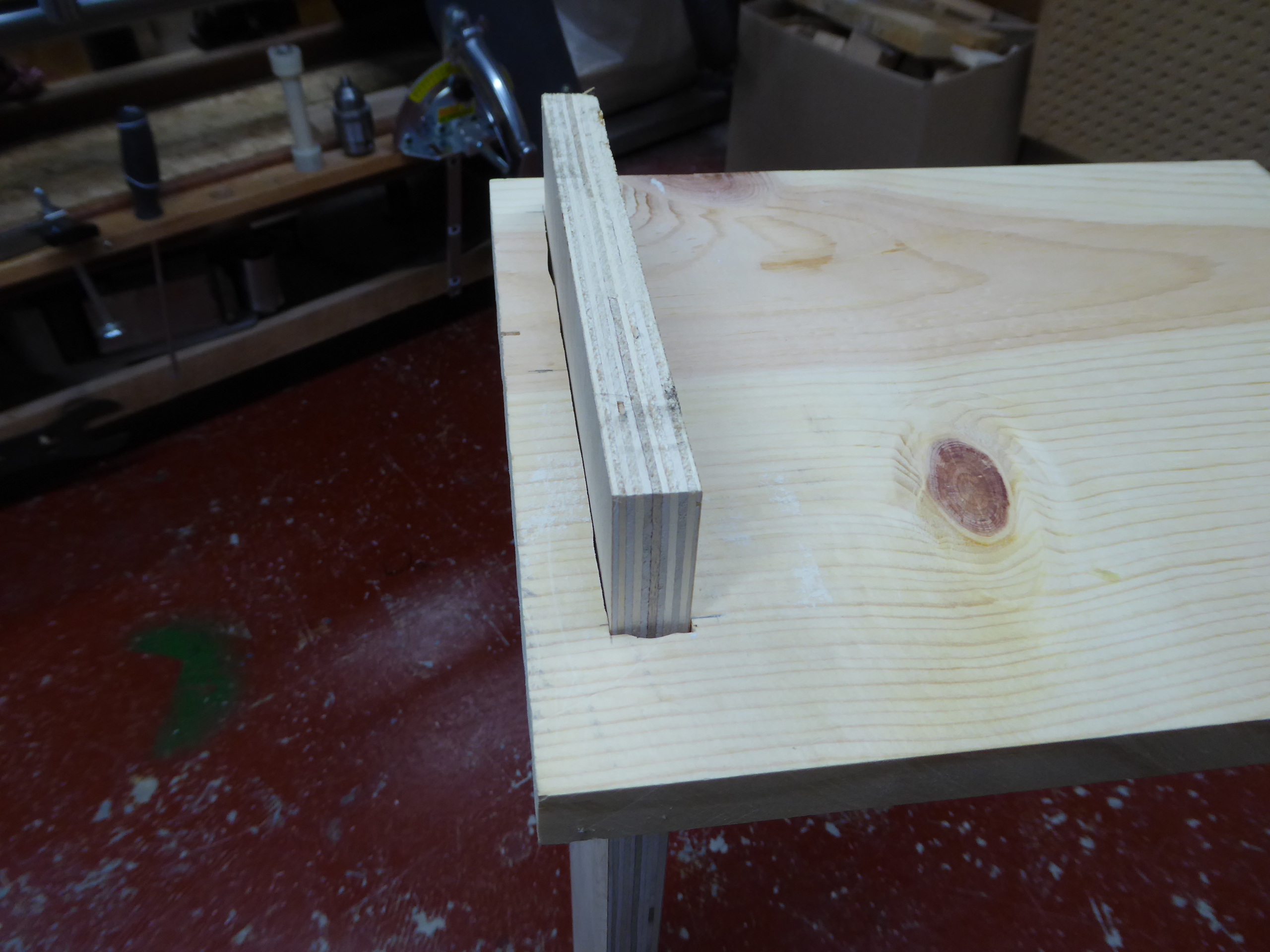

I started with feet for the project. (As part of our remodel we threw out an old, but nice TV cabinet.)        I cut off trim pieces to use as feet. I thought a piece of ¾” pw would make a good up-right and I had an off-cut of pine that I thought would make a table top.
Just because I’m a woodworker I like making projects without nails, screws or other mechanical fasteners. I’d prefer a more traditional approach. So this has none of those and, at least at this point, not even any glue.
I used the table saw to cut notches in the feet. Then I drilled and inserted dowels from the heel of the foot (look at the first pic). For the table I routed a slot and it just hangs on the upright. It moves up and down to accommodate the height of the sofa/chair arm. (Maybe the best feature of this unit and as far as I know the only unit that's adjustable?) The upright is plumb but the table hangs a full bubble off level. And I'm concerned that if bumped it may slide down....so I think I need to add a wedge(s) or dowel(s) to support it.

So I've fooled around with this project and by and large I'm happy with the size. (It ended up being made from pine, birch pw, polar, and red oak.) I've added a handle at the top from more big box pine. It's attached to the original portion with  dowels. To prevent the top from accidentally sliding down I drilled 6 - 1/4" holes and made two stoppers. Cut the stoppers with a hole saw and the center just happened to be 1/4" so I glued in a short dowel. Works great. I added some stain and a few coats of poly. Concept wise I'm pretty happy and will make a 'keeper' when the spirit moves me.  Thanks for looking!
