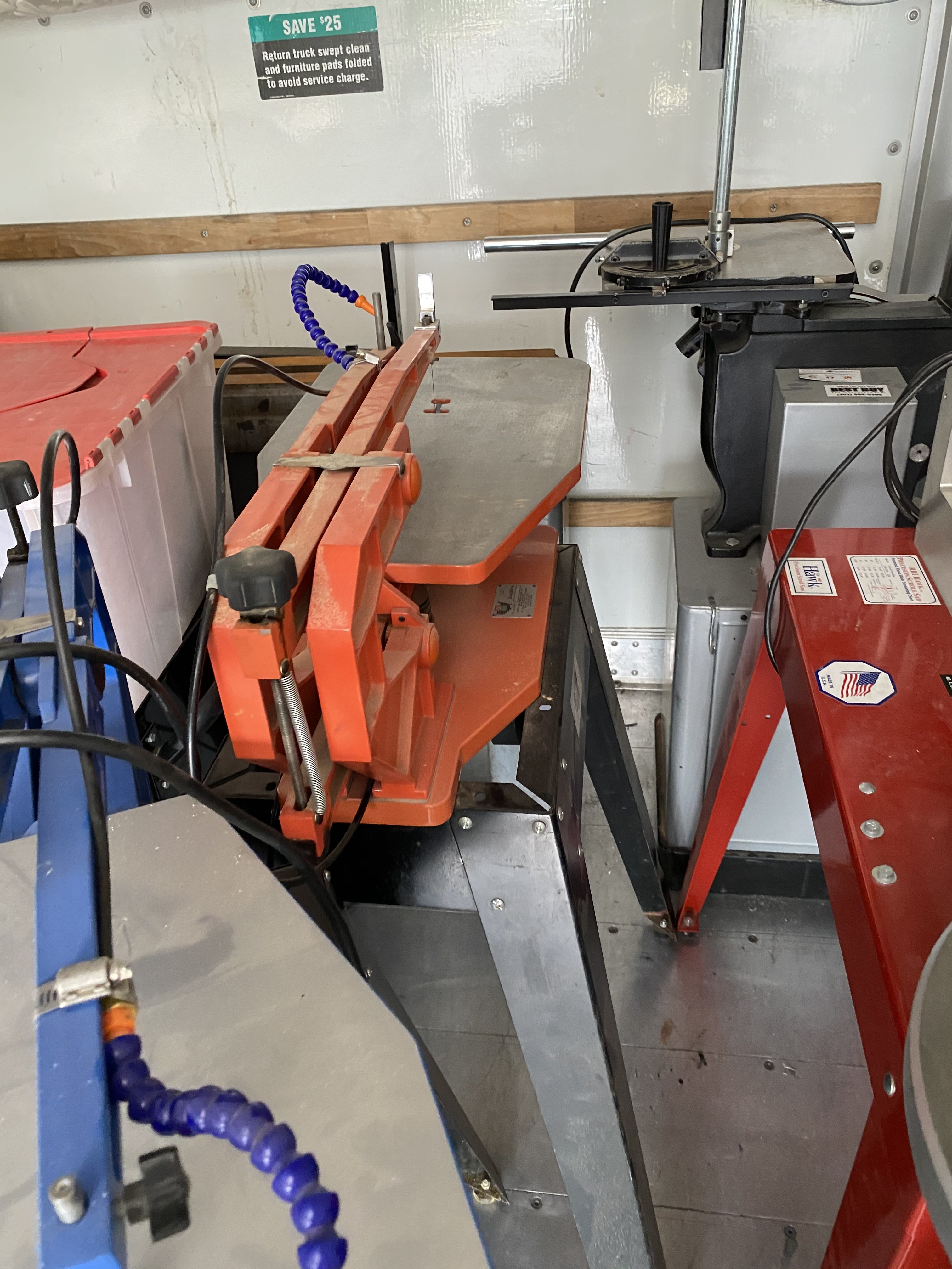

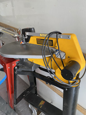

Here are a majority of my saws I put into storage before I moved   They should help you see the differences in them. The fact that I have so many I obviously enjoy all of them the same. In one picture you will see an excalibur its sitting underneath a hawk   Just for size reference that hawk is a 26 inch and the excalibur is a 30” they take up a lot of space and are heavy  one thing to consider is size and floor space triangle stands help you achieve more room. That big arm on the 30” after a day of fret work wears out my back, shoulder and neck lifting it   For me I am more of a constant tension parallel arm guy than a linkage and I prefer to tilt my table than my head   I see better cutting that way.   I hope these pictures help you see differences in the saws.   Your little wen is an awesome tool and you can work around the throat size I promise.  With a couple products and a knob epoxied to your set screw, sharp blades and cleaning and scuffing the blades before you first put them in the blade holders your gonna have a fun experience just like the bigger “fancy” saws.  8F18E392-AE1E-4585-9B7C-DAAD5D0C739B.thumb.jpeg.a22d559bbafd8c37f8ef15e78adb6928.jpegC7475617-AAAF-4DDE-900D-DAECEE1B6EA0.thumb.jpeg.50c132bc765acfd961467ca39d20f1c1.jpeg
