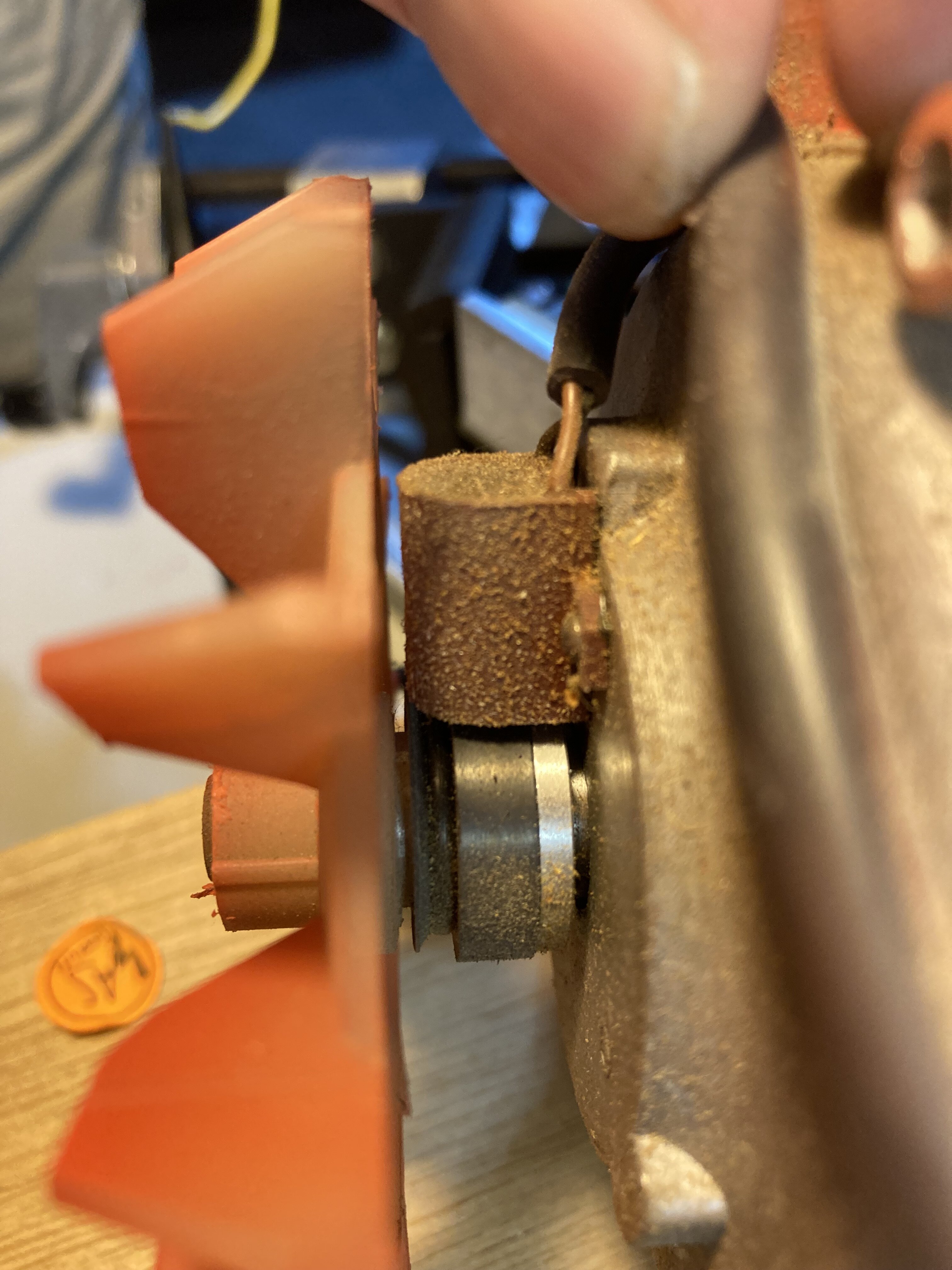

Chris Raymond Posted July 1 Report Posted July 1 Hi, my old (1990) Hegner Multimax-18 speed control has stopped working (max speed all the time regardless of the knob setting). Being an EE I probed the speed control PCB and I believe it's functioning OK. However the tachometer pickup coil on the motor (see photo) reads open when I measure it. If it's really a coil and not some Hall Effect sensor or something I would expect a few hundred or maybe a few thousand ohms when measuring the coil but it's definitely reading open. So it appears to have failed, which would explain why the speed control isn't working. Can anybody tell me: 1. Is the pickup on the motor just a simple coil? Or something more exotic? This saw was built in 1990 so I suspect it's not too exotic. 2. Can I buy a replacement coil? If so, where? A replacement motor is something like $750 so definitely not going that route 3. Does anyone have fried motor they'd like to sell, so I can salvage its coil? The coil is shown in the third photo, it's the device above the motor shaft with two wires coming out. Thank you! OCtoolguy 1 Quote
kmmcrafts Posted July 1 Report Posted July 1 Welcome to Scroll Saw Village! I don't have an answer to your question but, I thought if you had a local electric motor repair shop they may be able to get you the part you need. Also if you're on FB there is a page on there where the guy rebuilds Hegner saws including motor repairs etc.. Though I believe he is in the UK he may be able to answer questions or maybe even be able to help you get the part you need. I'm not certain of the name of the FB page but I think it's something like "A Saw Subject" or something along those lines. Maybe someone else will respond with the link to the FB page or if I run across it I will. I believe @JTTHECLOCKMAN works with electrical stuff maybe he knows something? OCtoolguy 1 Quote

JTTHECLOCKMAN Posted Sunday at 03:39 AM Report Posted Sunday at 03:39 AM (edited) Hello Chris. I am sorry but I will be of no help to you. I had a hegner years ago but never dove into the workings of the motor and or controller because I never had a problem. i do not know how the speed is regulated with that saw. What I suggest you do is contact Advance Machiery and talk to their tech. They will be able to answer your question and possible sell you the part if that be the case that it is bad. Being you can obviously speak the lingo it should be easy for you to hold that conversation. I will tell you this with all certainty that motor is indistructable and you do not need to buy a new motor. That is an industrial motor. Maybe at some time the capacitor may go but again I doubt it. I believe this is a coil but does it collect data or does it produce data. That I do not know. I do know this is tied into that circuit board and you may have a different problem on the circuit board. replacing that coil may not be the answer. The speed is magnetically controlled. As I said the techs at Hegner are really good and very helpful. Great customer service. They can help. https://www.advmachinery.com/collections/hegner-scroll-saw-parts Edited Sunday at 04:06 AM by JTTHECLOCKMAN OCtoolguy 1 Quote
