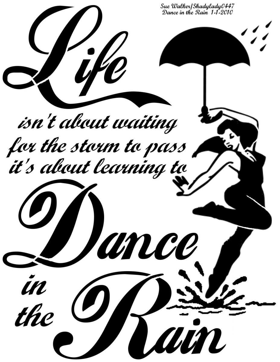

Frank Pellow Posted January 9, 2016 Report Posted January 9, 2016 (edited) (part 1 of 2) I found the attached pattern by Sue Walker and thought that something like it would be appropriate for my granddaughter Brooke's 14th birthday. Brooke is a serious tap dancer, so I searched the web for a tap dancer in drawn in profile and was successful in finding a profile that could, indeed be Brooke. That drawing is also attached. Edited January 16, 2016 by Frank Pellow Quote
Frank Pellow Posted January 9, 2016 Author Report Posted January 9, 2016 (edited) (part 2 of 2) I realized that the hardest part of this project for me would be to saw out the smaller script. So I expanded the size of that somewhat. I also rearranged the layout in order to replace the original dancer. The resulting design can be seen in the first photo below. The piece is quite large. It's 45cm x 35cm (or about 18 inches by 14 inches) so I decided to make a larger table to temporarily replace the standard table on my scroll saw. That can be seen in the second photo below. It's much easier to handle the bigger piece on this table and it's really easy to switch tables. But, as can be seen in the third photo below, I'm not doing a good job on the smaller script. I've tried both Olson Crown Tooth 2/0 blades and Flying Dutchman New Spiral 3/0 blades and am having difficulty with both of them. The word "waiting" that I have sawn out is probably marginally acceptable but I am quite unhappy with it. I might start all over again tomorrow using thinner and/or different type wood. Right now, I am using 6mm thick Baltic Birch plywood. Edited January 9, 2016 by Frank Pellow Quote
