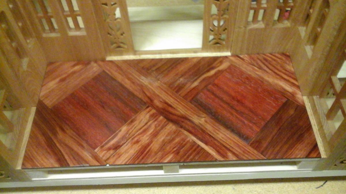

a night of dring, them time for a coat of satin. i really like how the bloodwood where the clock face goes look. plus the bubinga flooring doesnt look too shabby either.

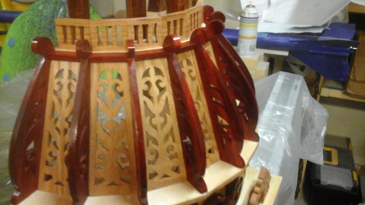

as for me, it finish day. probably an all day affair but thats allright. so, while im waiting for a coat of satin to dry, i thought id show what im using to get the poly onto the surface. have a couple different spray guns- a devilbiss starting line with 1.8 tip,a devilbiss startingline with 1.3 tip, a devilbiss mini gun with 1.0 tip, and a cheapo harbor freight with what i think is about a 1.7 ish tip, and my baby pictured here- a devilbiss copper tekna with 1.3 tip. all guns i picked up during my venture into auto body work. all have their place- the starting line with 1.8 i use for primers and heavy/thick(er) finishes. the HF i use when my only concern is getting product onto the surface and its going to be sanded. the mini gun i use for small projects and thinner product.the startingline with 1.3 tip....well, i dont use that any more since i got the tekna. its devilbiss's entry level gun and,on auto finishes, leaves orange peel in clearcoat and single stage paints. i found that with finishes used for woodworking, if the finish being sprayed dries rather quickly( like lacquer) it will leave orange peel. finishes with longer open time seem to have more time to level out and there wont be the orange peel. the gun doesn't have the greatest atomization.
which leaves my baby, the copper tekna. it has amazing atomization. the finish- with the right air pressure- comes out like a dust-great atomization. the fan pattern when wide open is about 10" wide or so and i can dial it down on projects like this. the regulator that came with the gun is awesome,too. some pro finishers prefer to have the gage on the compressor regulate the air pressure- saying that the gage on the gun regulates pressure, but diminishes CFM at the gun. it makes sense, but i haven't noticed a problem. maybe if i sprayed more often i would, but for now, ill stick with the gage at the gun.
being able to regulate pressure at the gun is pretty nice as there are times im spraying a finish and want a little more or a little less pressure and its a simple task to just read down and turn the knob. the adjustment for paint volume seems to be more smooth/accurate than the other guns,too.
its a rather pricey gun, but when i was doing autobody, i had to have something that laid base and clear real good. where i really noticed how good this gun is was when i  did a pretty big body restore on an 87 blazer. it was a metallic brown and the gun laid the metallic out perfectly- no tiger stripes!! which i did my 1st metallic paint with the startingline gun.yeah, that didn't turn out too good but glad it was my own project.
its been a real nice gun for spraying finish, and another thing i see on this project- the atomization helps get the finish into the nooks and crannies better.
and the compressor is just yer basic 60 gallon twin cylinder single stage 3 hp. its been a great craiglist find!

I think you would find the qualities of shellac to be almost ideal for fretwork.  Being thin and quick drying, it makes it easier to hit the piece from all the angles necessary to get full coverage in all the nooks & crannies, without the puddling and runs that you can get with slower drying, thicker poly.  I spray shellac on about 95% of my scroll saw projects.  Nothing else I've used is as fast, easy to spray & clean up as shellac and it makes a very nice finish as well.  Mix your own flakes and you have a wide variety of colors & tones available to you, without using separate stains or dyes.
