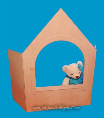

I made this game house-screen for a kindergarten. I used birch plywood
1/4", the sheet size is 5 * 5'. From the tools, I used a circular saw with a guide and a router. The side walls I attached to the facade on the piano loops. Unfortunately, I did not make other photos. I was in a hurry to finish and give it to the customer.
Below, I posted a free drawings . There are 2 options. 1 - economical variant from 1 sheet of plywood. The second requires an additional piece of plywood for the sidewall.
