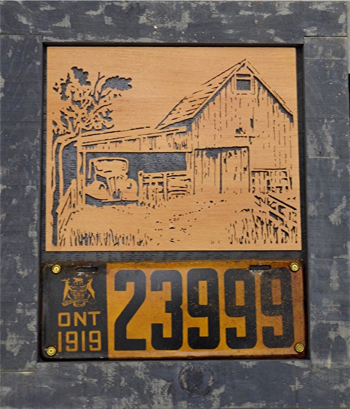

Frank Pellow Posted October 18, 2018 Author Report Posted October 18, 2018 (edited) Completed: First, some words about the pattern and the cutting of same: This pattern such that all the red parts are to be cut out. This is the first such pattern that I have tried and it does make things much easier for me than all black. My first preference is red lines, but red areas is good. The foreground was cut out of 3 millimetre thick quarter sawn white oak plywood . I used Flying Dutchman New Spiral 2/0 blades. The backer is 6mm thick quarter sawn white oak plywood stained black using Saman stain. Gorilla Heavy Duty spray adhesive was used to attach the foreground to the background. After mounting, both the barn and the plate were sprayed with three coats of Rust-oleum Painters Touch Ultra Cover semi-gloss clear rattle-can stuff. Now, a photo of the completed piece: The licence plate has a rim around the edge, so before mounting it on the backer, I inserted a thin piece of plywood of the correct dimensions behind the plate. I attached the plate to the backer using brass screws and cup washers: The frame is a variation of my "standard" Rosseter-Pellow frame. In an attempt to simulate the wood on the old barn, I used rough-sawn pine and attached the pieces using two 7 centimetre long hex screws at each joint: I stained the boards using my own combinations of Saman stains in multiple applications. Here is a photo of the back of the frame, showing how the backer was mounted: Edited October 18, 2018 by Frank Pellow bobscroll, bradnjackie, RabidAlien and 1 other 4 Quote
Scrappile Posted October 18, 2018 Report Posted October 18, 2018 Frank, that really turned out nice. Job very well done. My favorite pattern colors are red lines with the cutout pieces in a light gray. Easy to keep track of what is to be cutout and saves ink. bradnjackie 1 Quote
Frank Pellow Posted October 18, 2018 Author Report Posted October 18, 2018 7 minutes ago, Scrappile said: Frank, that really turned out nice. Job very well done. My favorite pattern colors are red lines with the cutout pieces in a light gray. Easy to keep track of what is to be cutout and saves ink. Thanks. Yes, I should have thought about red lines with grey areas. I have cut one such pattern and that combination is, indeed, the best. bradnjackie 1 Quote
Frank Pellow Posted October 18, 2018 Author Report Posted October 18, 2018 17 hours ago, Kenny Hopkins said: Absolutely Beautiful Cut! Thank you so much for taking the time to show this off! Thanks Kenny! One can not do better than to receive a compliment from the designer of the pattern. Please note that I did give you credit on the back of the mounted piece. Your design inspired me to do this. Quote
innar20 Posted October 18, 2018 Report Posted October 18, 2018 Good overwiev of the job and very nice finishing touch! Quote
Bill WIlson Posted October 18, 2018 Report Posted October 18, 2018 Nicely done! I have that pattern in my "to do" pile and I have some old, weathered boards I can use to make a frame. I may have to move that project a little closer to the top. Quote
RabidAlien Posted October 26, 2018 Report Posted October 26, 2018 Excellent cut and framing! Thanks for posting your finishing routine, I usually just BLO stuff and hang it up. Items that will get used (end table, bathtub tray for my wife) get a coat of poly brushed on. I'll keep an eye out for your rattlecan cover. I've cut both red/white and black/white patterns, but I have a laserjet printer (company was getting rid of it and said they "wished it would just disappear, it'll cost more to have it scrapped than its worth". So....I'm slowly in the process of scrapping it. So regardless of the color of the pattern, mine come out in shades of grey. I do appreciate those pattern makers that put "remove red" or "remove white" on their pattern somewhere so I don't have to stare at it trying to decide which to cut out. Quote
