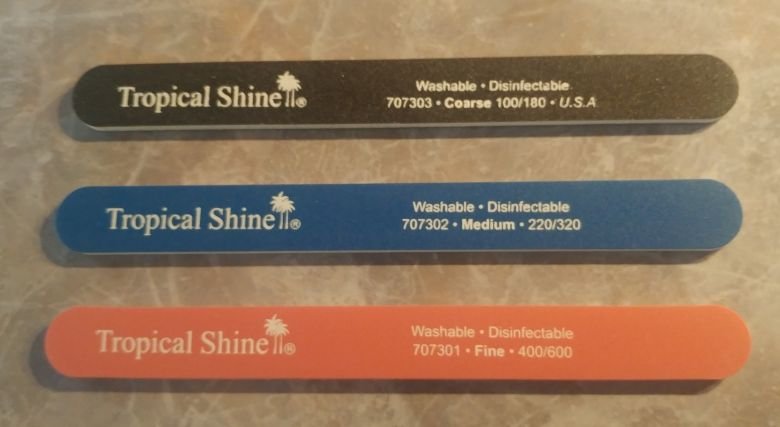

tgiro Posted July 3, 2019 Report Posted July 3, 2019 My daughter showed me these. I have Judy's bowed and flat detail sanders, but these work great, also. They are flexible, but firm and have good sharp edges. If they start to clog up - they're washable. I run some warm water on them and hit them with a fingernail brush. Cleans them right up. They are pretty cheap - we bought them at a Sally Beauty Supplies store at 79 cents each. I've seen them on Amazon, but I've seen some prices at $7.50 +/-, although that may be for packages of ten. Just another trick for the job. Wilson142, meflick, amazingkevin and 3 others 5 1 Quote

Sycamore67 Posted July 4, 2019 Report Posted July 4, 2019 I make my own like that using craft popsicle sticks, spray adhesive and sand paper. I put a bunch of sticks side by side, glue sand paper on and then cut apart. You can make sanding sticks of all kinds like this. lineman 1 Quote
