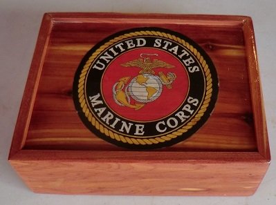

John B Posted December 17, 2019 Report Posted December 17, 2019 I have used this method to make a perpetual trophy (Small Honour Board) for the RFDS Here is a pic of the sample I did before doing the actual thing. It is actually much brighter than the pic and looks real good with a couple of coats of gloss lacquer. https://www.youtube.com/watch?v=ERkZfL8lob8 Gordon 121 and OCtoolguy 1 1 Quote

John B Posted December 21, 2019 Report Posted December 21, 2019 I have used Iron on transfers before, the type designed for tshirts. I made quite a few dartboard boxes with a design on the doors using this method. Just print them out and iron on like you would a shirt and give a couple of coats of clear over the top. Jim Finn and OCtoolguy 1 1 Quote
