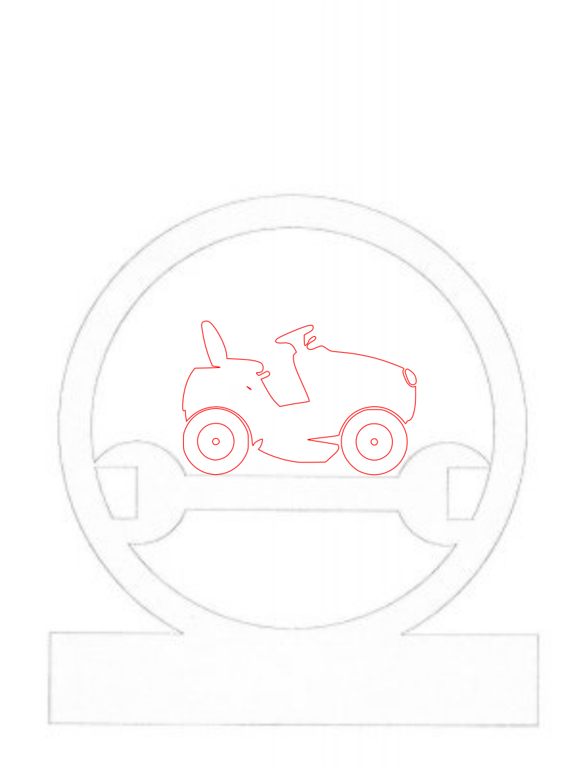

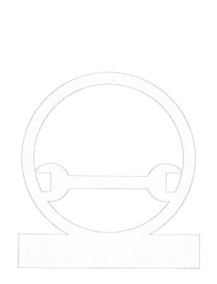

OzarkSawdust Posted June 21, 2020 Report Posted June 21, 2020 I'm trying to design a business card holder similar to the scroll saw artist Steve Good pattern. I've got most of it in Inkscape, but need a lawnmower. I found this on the web somewhere...but when I copy/paste it has a dotted box around it that blocks out the rest of the design. How can I avoid that? Need a garden tractor like this...that I can change size to fit. The idea is to set the tractor on top of the wrench and put "The Rustic Wrench" across the top. Quote
jollyred Posted June 22, 2020 Report Posted June 22, 2020 When I pasted the photo into Inkscape, I had no problem tracing it using the trace bitmap function. Did you remember to turn off the fill and turn on the stroke? And move the traced drawing off the photo? Tom OzarkSawdust 1 Quote
JimErn Posted June 22, 2020 Report Posted June 22, 2020 See if this helps rustic wrench.svg amazingkevin, OzarkSawdust, Be_O_Be and 1 other 3 1 Quote
OzarkSawdust Posted June 23, 2020 Author Report Posted June 23, 2020 23 hours ago, jollyred said: When I pasted the photo into Inkscape, I had no problem tracing it using the trace bitmap function. Did you remember to turn off the fill and turn on the stroke? And move the traced drawing off the photo? Tom Don't know what the "trace bitmap function" is. Looks like I need to learn something new. amazingkevin 1 Quote
jollyred Posted June 23, 2020 Report Posted June 23, 2020 34 minutes ago, OzarkSawdust said: Don't know what the "trace bitmap function" is. Looks like I need to learn something new. When you bring in a raster image into Inkscape, you can get the program to draw an outline of the image, using the trace bitmap function. Sometimes it works great, sometimes it doesn't. How it works is once the image is in your drawing, select it and under the "path" menu, there is a "trace bitmap". This pops up a window, where you just tell it to go ahead. Once the tracing is done, use the selection tool to move the raster image and the path apart. Once they are apart, you will want to set the stroke of the path and turn off the fill to see what you have. The raster image can be deleted out of the drawing and the vector will stay. If the trace does not work well, another method will need to be used, such as manually tracing the outline of the image. Tom Tomanydogs, OzarkSawdust and amazingkevin 1 2 Quote
OzarkSawdust Posted June 23, 2020 Author Report Posted June 23, 2020 14 hours ago, JimErn said: See if this helps rustic wrench.svg 539.92 kB · 1 download Thanks Jim! It took me a few tries, but I got it onto my work. Now I have to go find the video Travis did on setting text on a curve. I saw it once but have never done it. I need to watch it again before I attempt it. I need to do more design work to get this down...not just once every 5-6 months...lol. amazingkevin 1 Quote
