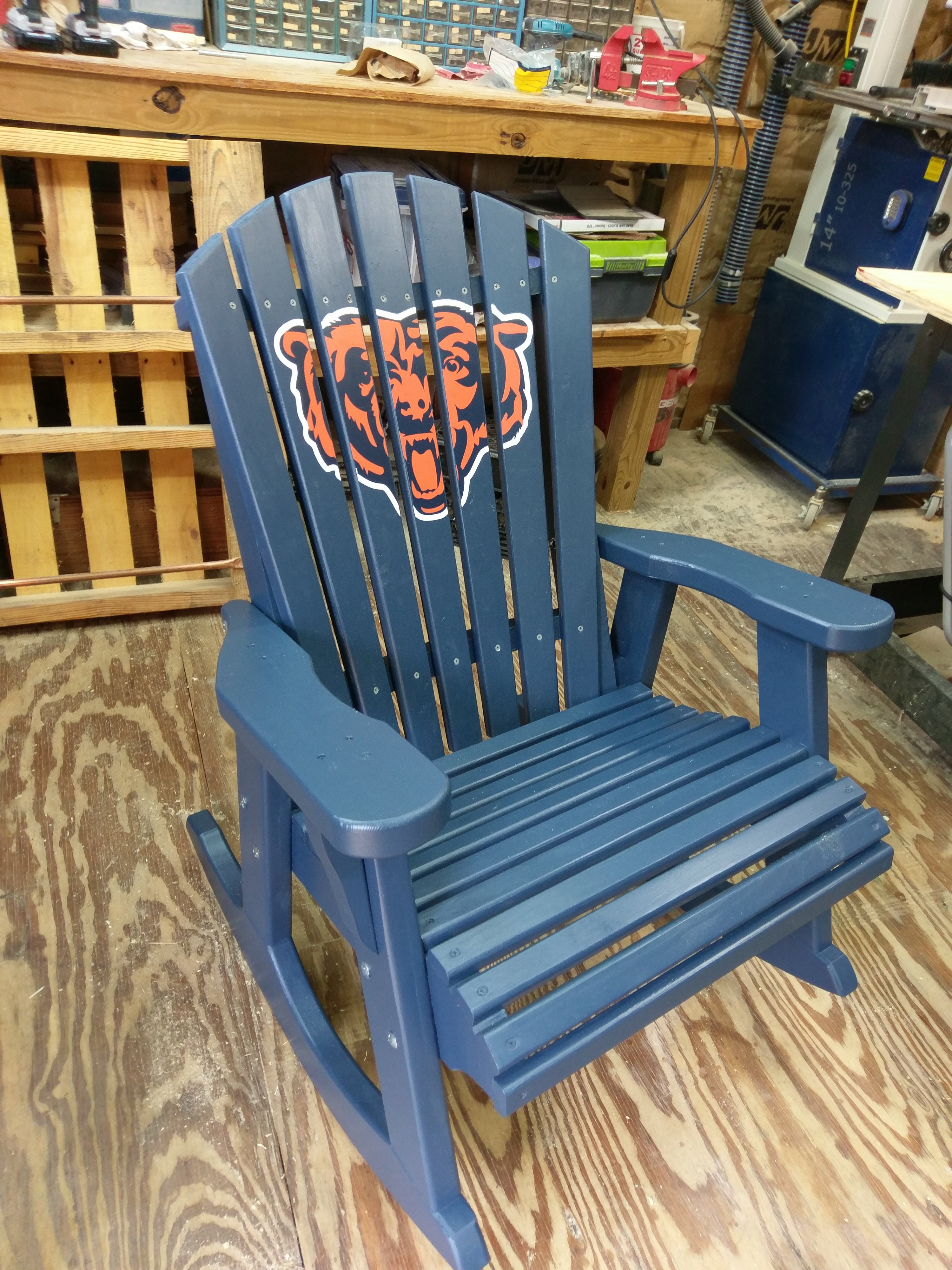

I've made about a dozen over the last couple of years.  I have 4 more on order, I have just been putting them off.  I too made templates but from cardboard.  Mine aren't a true Adirondack chair,, I make mine into rockers and I have them sit up higher.  As we get older it gets harder to get up out of a true Adirondack.  LOL
IMAG5122.thumb.jpg.156b02d511df3df5085baf33c86965a7.jpg         IMAG5718.thumb.jpg.28e5035b5afdbacd27a128f04a8c5e04.jpg    IMAG6699.thumb.jpg.6679bc53d71f6e3b2ec13b9c67e62864.jpg
