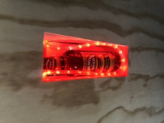

Fedido Posted November 3, 2020 Author Report Posted November 3, 2020 Just a short update, installed LED lights and did some more sheet metal work. Tomorrow’s agenda is back to what I like, work on the wood. Tomanydogs 1 Quote

Fedido Posted November 6, 2020 Author Report Posted November 6, 2020 Well, been really busy the last two days, but finally can show some work. It is the toast for the unit. Used a jig saw with 20 teeth per inch Bosch blades. I am now sold on these blades. Quote
Tomanydogs Posted November 6, 2020 Report Posted November 6, 2020 This is looking very good Dan. Very nice cutting with the Jig saw. I like the lights. This is an exciting project. Fedido 1 Quote
