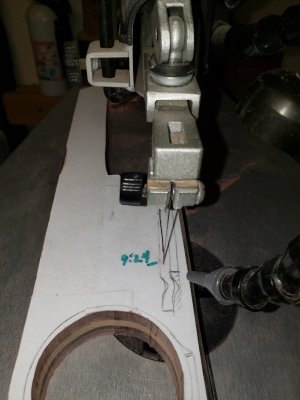

preprius Posted January 2, 2021 Author Report Posted January 2, 2021 progress and observations, and questions... Progress: see 1st pic below... Ribbon thickness varies alot. blade seems to jump sometimes. Thus making quicker cuts. Observations.. Newbie frustrations changing blades takes 10 mins. bottom thumbscrew keeps turning the blade toward the front and pops out of clamp. I did glue sandpaper to top saw arm so I can sand off the tips of blades. angles for cutting straight lines change based on wood thickness. olsons pgt on 1/8 inch thick needs about +10 to 14 deg to make straight cut.. on 1 inch thickness it needs about -3deg. Questions: Blade jump ahead sometimes. Is this due to hitting different thicknesses of glue? There is 2 layers of purple heart. So I dont think it is less dense wood. I cant make cutting progress unless the back of the blade presses against plastic table cap. pic2 . The plastic cap slot is getting bigger and wider. If I make blades tighter they break. I went through 4 in a row without making any cuts. So i backed on tension. Sometimes they slip out of bottom clamp. So what techniques am I missing? What technique do I need for clamping bottom of blade? What do the pros say? Mark. OCtoolguy 1 Quote
Foxfold Posted January 2, 2021 Report Posted January 2, 2021 13 hours ago, preprius said: I cant make cutting progress unless the back of the blade presses against plastic table cap. pic2 . The plastic cap slot is getting bigger and wider. Not sure about some of the questions as I've never made a bow, but I do know that if your blade presses against the insert then you are pushing too hard. I've had my insert for almost a year and it's pretty much the same size as it was when I got it. Let the blade cut the wood, don't force it to cut the wood is what I was taught. John B 1 Quote
preprius Posted January 2, 2021 Author Report Posted January 2, 2021 i guess the scroll saw is the wrong tool for this. I dont have a band saw or table saw. I do have cutoff saw but that does not do well with small parts. Oh well. these cuts will take 8 hours per inch. Another lesson learned. Dont choose thick projects. Quote
preprius Posted January 2, 2021 Author Report Posted January 2, 2021 2 hours ago, preprius said: i guess the scroll saw is the wrong tool for this. I dont have a band saw or table saw. I do have cutoff saw but that does not do well with small parts. Oh well. these cuts will take 8 hours per inch. Another lesson learned. Dont choose thick projects. so i had to verify 8 hour per inch. here is pictures before & after with maximum pressure before the blade hits plastic inser for 1 hour. 20210102_103155.mp4 20210102_095559.mp4 Quote

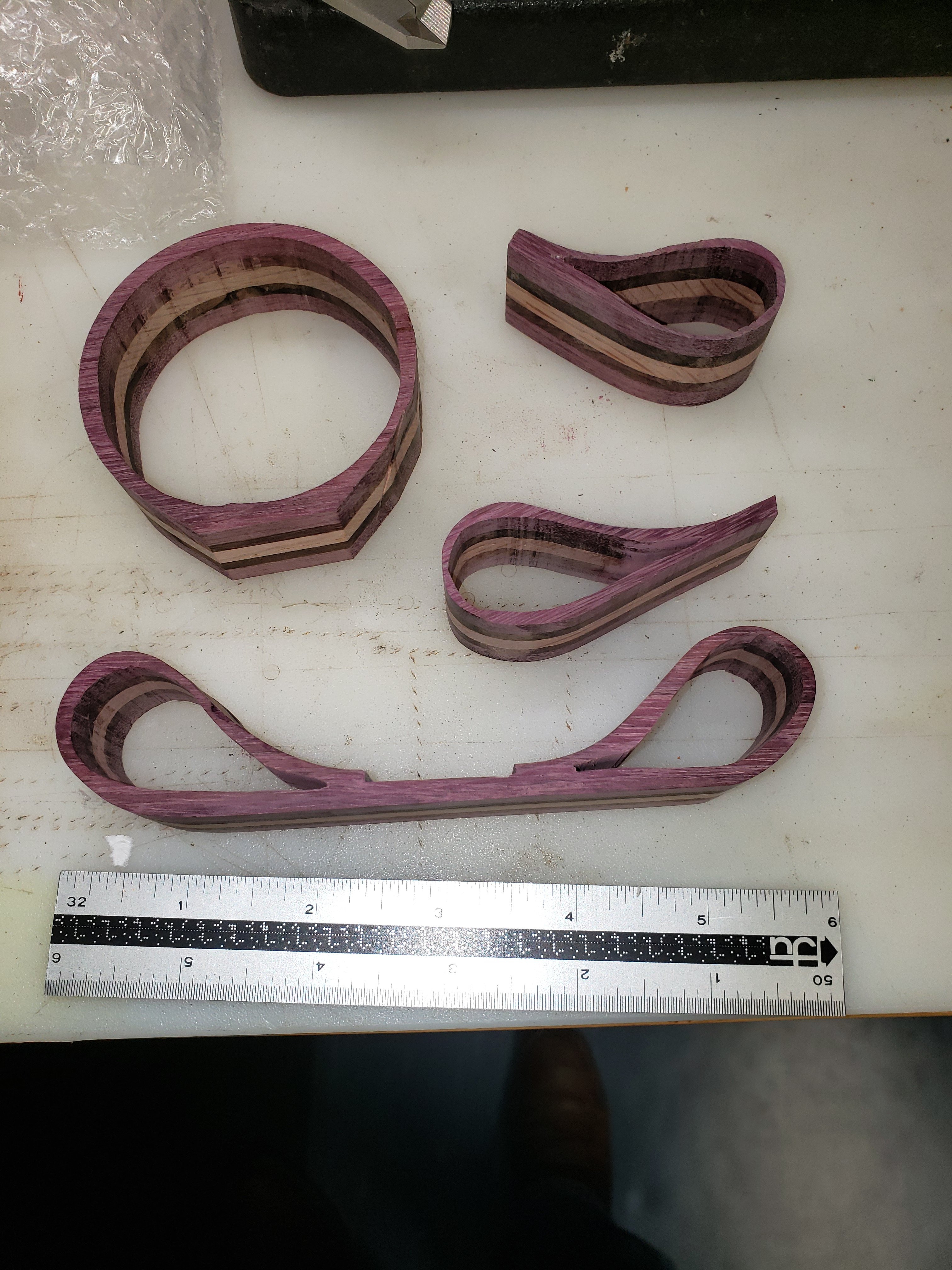

preprius Posted January 2, 2021 Author Report Posted January 2, 2021 Update.. pic with big loop. Every thing needs finer sanding and finishing. Straight pieces are still in work. Still thinking about final application. Probably no box. There are 4 pieces. one piece has small loops. (2)side loops. (1) center loop. Okay that was confusing so I added a second pic. Quote
