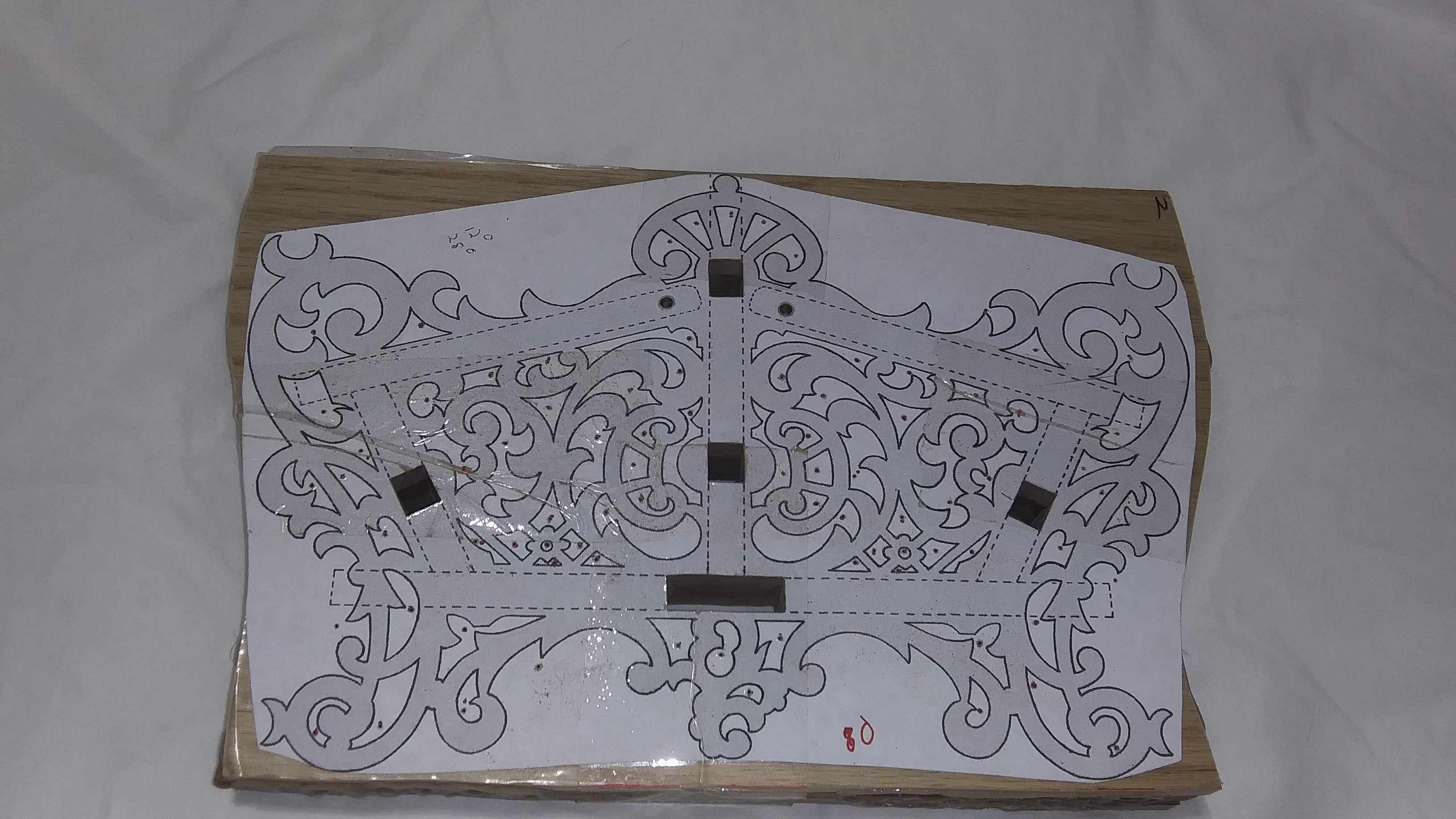

I am working on the double lidded work basket pattern from the Classic Fretwork Patterns book. I am cutting a stack of three 5/16" boards, 1 oak and 2 walnut. I am using a #65 drill bit, cobalt alloy, in a drill press, 3500 rpm, against a fresh wood backer. And I'm still getting a lot of blowout on the bottom walnut piece and I have broken three drill bits in the process (these drill bits generally last for more than a year apiece. The drill bits were also bending during the drilling so that I couldn't depend on the exit hole being inside the waste area in the pattern. So far it's not a total disaster, but the bottom layer will not be a premium piece.
Any suggestions as to what is going on and tips or tricks going forward?

Hard to see in the photo for sure but it also looks like the boards are warped / cupped.. That can affect how the drill goes through the stack as well.. ( especially on cheap or dull bits ) When I have a slightly cupped board I will sometimes use a awl to make little indentations so the bit has more of a direction to follow.. IF it's cupped some these tiny bits do track off of where it intended to start and then it starts off crooked.. then the bits are small and a little flimsy, they will bend because they start off crooked and track the rest of the way crooked.. Chucked in the spindle in one spot and drilling off that center makes the bit bend..
