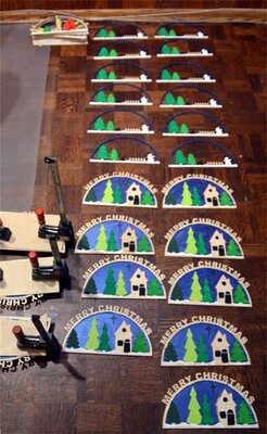

Frank Pellow Posted November 3, 2024 Report Posted November 3, 2024 For the ninth year in a row, I plan to send out wooden "Christmas" cards in December. Here are photos of the cards from previous years: . This year, my cards are being created from a Steve Good pattern that I modified a little bit. It's a four-layer scene that I'm cutting from 3mm-thick Baltic Birch plywood. I'm going to create 40 cards. Here is a photo of the glue-up of 12 of the cards that I have cut and painted: I'm gluing and clamping these one layer at a time then letting the glue dry for at least an hour. This is a background activity that will continue for many days. jollyred, Roberta Moreton, barb.j.enders and 4 others 6 1 Quote

Frank Pellow Posted November 13, 2024 Author Report Posted November 13, 2024 Steve Good's 'Multi Level Christmas Dome' pattern suggests four 6mm thick layers which is close to one inch thick. I need to mail most of these and several to other countries. Therefore, I reduced the width to be half of what Steve suggested. With Steve's design, a base to hold the dome upright could be optional. My thinner dome, could easily topple over without a base. I designed my "cards' so that each card has two 6mm thick tennons and designed a base with both a groove to hold the dome upright plus two mortices to capture the tennons. This is depicted in the dome and base on the left-hand side in the photo below: I made 4 domes and 4 matching bases. The dome and the base need to be mailed, unassembled, in a flat envelope: Having tested the prototype, I carried on and made 24 additional domes with notches. Next, I started in on the bases. Making bases with mortices in exactly the right spot proved to be quite time-consuming. I decided that the notches, altough they provide a firmer assembly, could be eliminated. The groove in the base is good enough. That is what is shown on the right-hand side of the first photo. I've now made 12 domes without tennons and am about to cut the (labouriously made) tennos off 24 domes. danny and barb.j.enders 2 Quote
