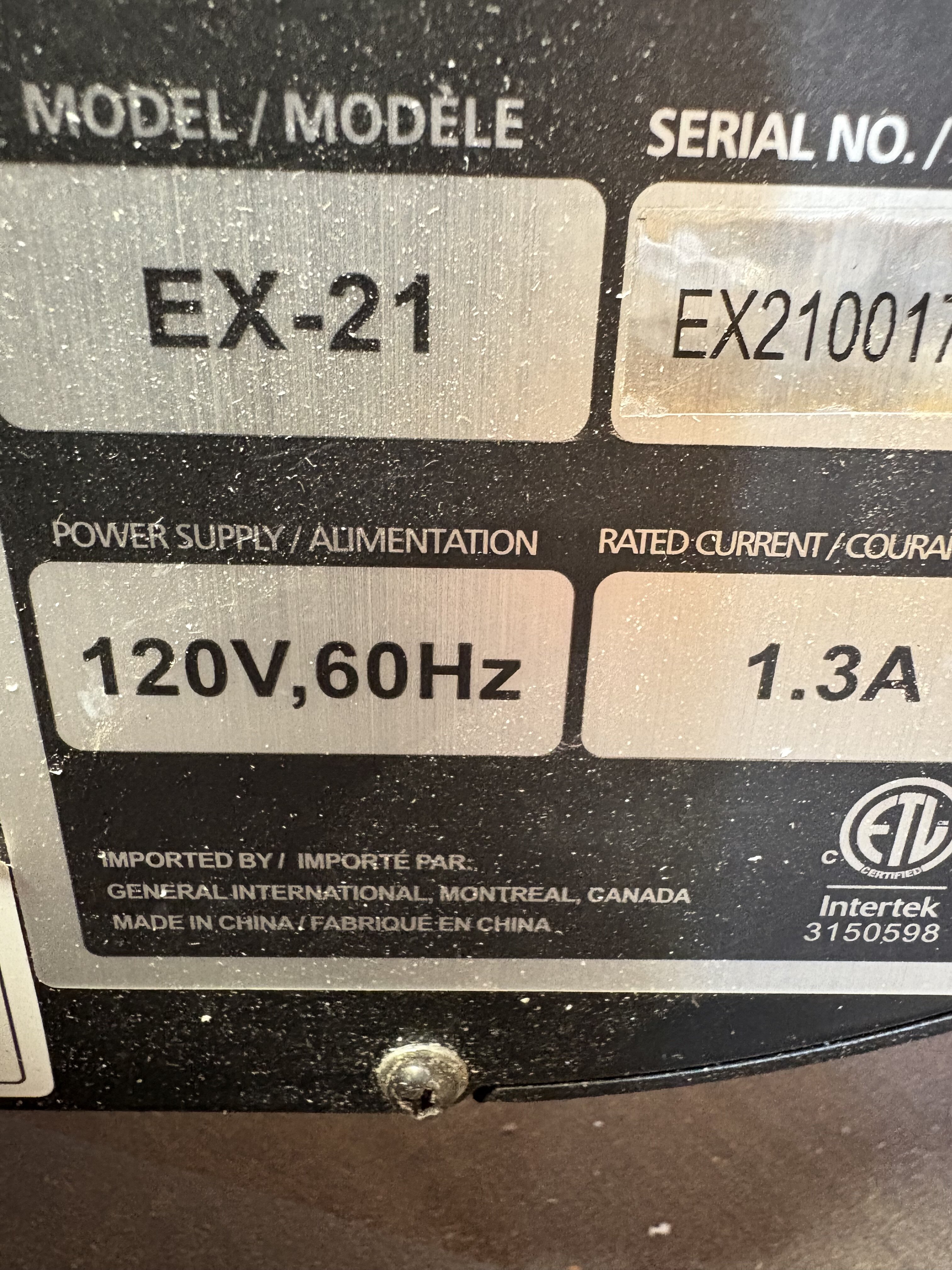

kmmcrafts Posted June 7 Report Posted June 7 I.D. tag is blurry but it looks like it says made in Canada. Pegas blade chucks would fix the more important issues as far as blade clamping and tensioning but they're more around $100 ish so that's not going to be in the budget you mentioned.. Not sure how much the replacement original style chucks are but I really wouldn't waste my money on them when the Pegas are so much better made. OCtoolguy 1 Quote

Allen levine Posted June 8 Author Report Posted June 8 I'm at park with kids when I get home I'll see where it was made OCtoolguy 1 Quote
Allen levine Posted June 8 Author Report Posted June 8 Made in China so I'm already guessing it won't be worth to fix unless it's only 25 dollars worth of parts the tinkerer has a hoarde of parts so I'll let him examine it anyway i remember years ago a metal gear broke in my powermatic bandsaw and powermatic part was 20 bucks We ordered the gear from e replacement parts for 2 bucks and my son took the saw apart and it's worked better since so I won't lose faith until he tells me it's not worth the effort OCtoolguy 1 Quote
