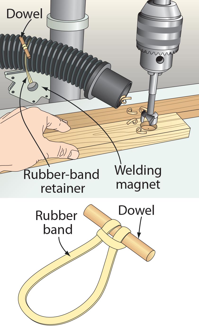

I use the HF Sanding ball a lot. Like you, I have to careful about how much pressure I put on the piece and it does generate a lot of scotch-brite fibers. I believe your set up should work good to reduce the fibers from flying all around. I stumbled on this DYI attachment in Pinterest and plan to build it in the next few weeks. Forstner bits definitely create a lot of wood chips.
Yah, I saw/have that plan also - I have another one that uses a welding magnet I want to try first.
I'll see if I can find it and post it
Found it - every easy
Being trying to figure out a collection port for my drill press for awhile now. I think I will get this a shot.
