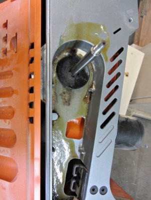

Scrappile Posted May 4, 2018 Report Posted May 4, 2018 (edited) Went into my shop this afternoon to play, and wanted to get my can of Shellac out of the cupboard. This is what I found. Do not know why I didn't notice this a day or two ago, or even smell it. The can of Shellac had a little hole "pin hole" in the bottom of the can. It wasn't there when I used it a week ago. But must have started when I put it back in the shelf because it is pretty much dry. Anyway, It ran down the wall in back and ran out the front of the cupboard onto my Ridgid oscillating belt/drumb sander. I do not know how I will clean this up or if I even can. Looks like it may have gone down into the motor.... the sanding belt part is froze up... Not a tool I use often,,, but I did not want it to go this way. Edited September 18, 2018 by Scrappile Scrolling Steve and meflick 2 Quote
WayneMahler Posted May 4, 2018 Report Posted May 4, 2018 I feel your pain Paul. So sorry to hear all of this, maybe using solvent will help soften it ? The stuff I have in my shop is mixed with Denatured alcohol which dries really fast. Best of luck my friend . Quote

Scrappile Posted May 5, 2018 Author Report Posted May 5, 2018 Well, well! After about 7 hours of work, it is up and running again. Anyone every wants to know how to tear one of these sanders down and put it back together, I think I can help...! Been apart and back together three times now! meflick and Phantom Scroller 2 Quote

Scrappile Posted September 18, 2018 Author Report Posted September 18, 2018 Well pulled out my sander a couple days ago to use. Guess what, froze up tight. All it would do is hummmmm!! I figures what the heck, I didn't get it as clean as I thought I did.... doesn't work now so what have I go to loose. I tore it completely apart, broke the motor down as far as I could, and cleaned again. I had the motor out broke down and back together 4 times. Worked around 6 hours on it and walla,,,, got it going!! Been working for the past couple days... There was some shellac in the very bottom of the motor, around where the shaft came out of the motor, and extended down in to the little thing on the bottom that causes the sander to oscillate up and down. I just kept brushing alcohol on the shaft above the bottom piece bushing, until it finally broke loose. Once it broke free, I could push it down the shaft and clean the shaft real good. I think it is really fixed this time.... we will see. Maybe I should sell it while it is working!! GPscroller and meflick 2 Quote
