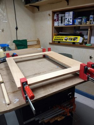

This project is all red oak. Incredibly I found a beveled mirror the correct size on-line at Menards (a big box store in the upper Midwest).  Almost everyone can use a mirror and the shelf works well for a wallet, necklace, earnings, change etc. And even though there's a closet in the room the pegs may come in handy. The frame is put together with 3/8" dowels. All miters cut with a hand miter box.
Around the inside of the mirror and around the edge of the shelf is 1/4" bead molding. I had to re-saw 3/4" stock to about 5/16 and then plane to 1/4". A couple passes through the router table with a round-over bit to get the bead profile.  I don't have much experience making bead molding so that was a challenge.
Under the cap there's cove molding and the bottom is a piece of cove molding as well. That was another router operation, but lots easier than the beading.
The router was used to create a rabbit on the back to hold the glass.
The shaker pegs were off the shelf from Rockler.
Finishing started with a grain filler. Quite a bit of sanding. Blond shellac. Light sanding. Three coats of General Finishes polyacrylic wiht light sanding between coats.
