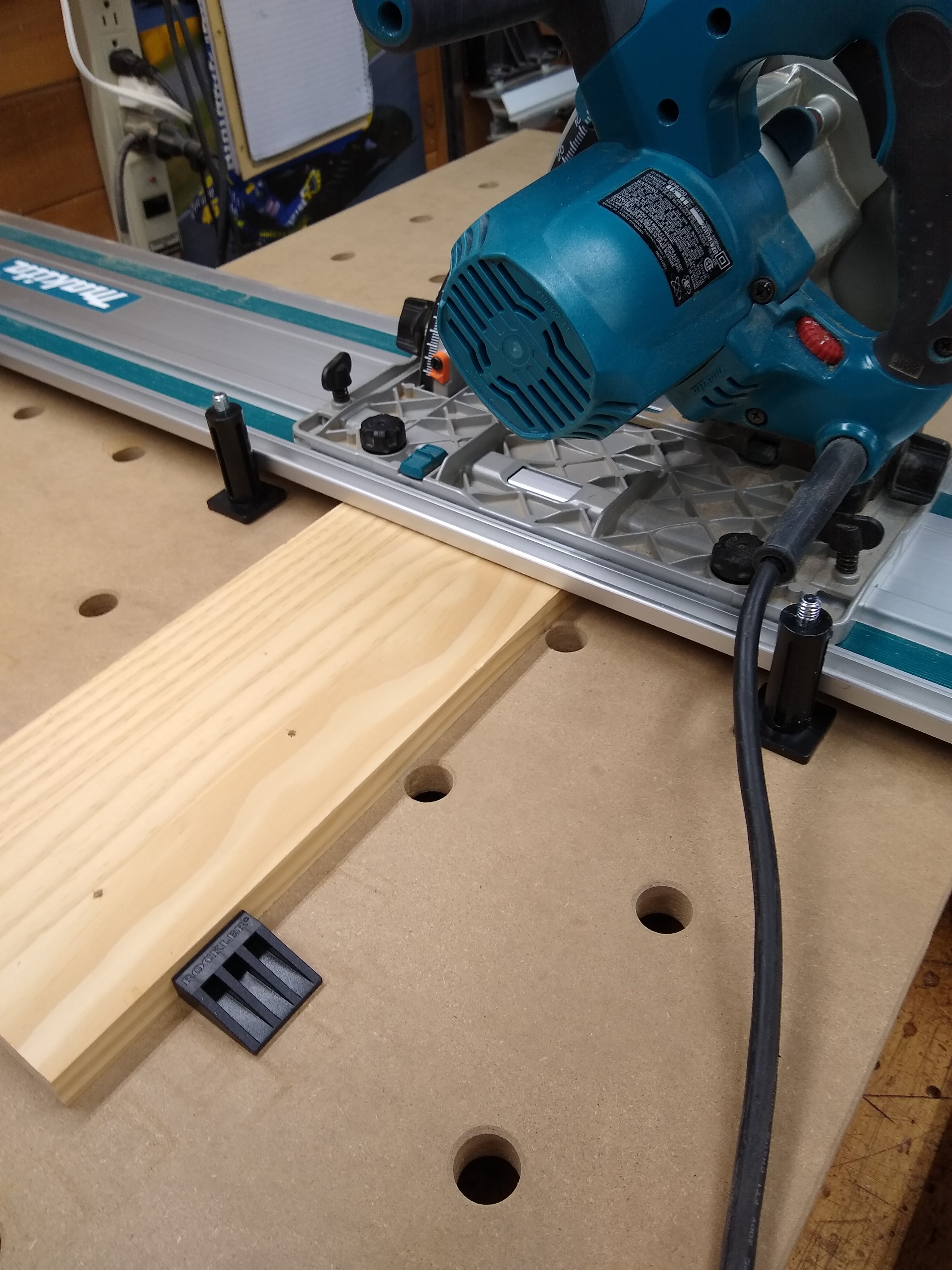

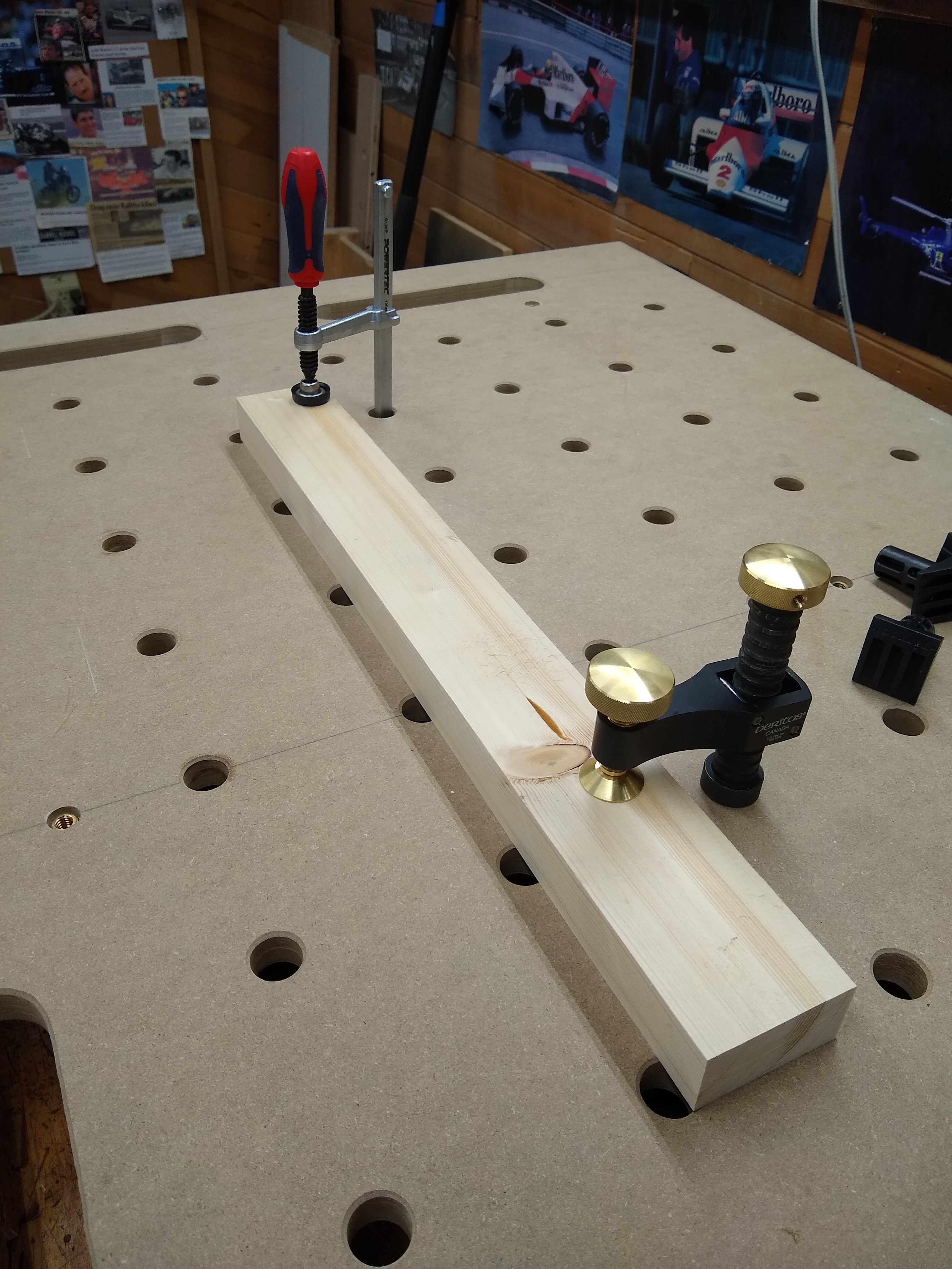

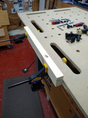

oldhudson Posted January 14, 2020 Report Posted January 14, 2020 I built the workbench in the first couple of shots around 1982. I'm pretty sure I got plans from Popular Mechanics or something like that. The top was a butcher block top I purchased whole. It's supported by steel legs and the cabinet is made from 1/8 Masonite. I added the vice, holes and hold downs over time. It's served me well but I wanted more flexibility. For quite a while lusted after the Festool mft (multi-function table). But those things cost $600. I finally decided I'd make one using idea gathered from watching YouTube videos of others who've made them. (Approx. Money Spent: stock about $10; clamps about $150; bench cookies $60; bushing and drill bit$40) Mine has 3/4" dog holes, not the 20mm that are so popular. It's about 1/4 sheet of mdf. I was VERY CAREFUL laying out the table and use a bushing so the hole were as vertical as I could make them. I've added 6 holes with rosen inserts so I can screw on Rockler Bench Cookies and lifts. The dog holes are 4" on center. The two advantages I was looking for was a bench that was portable. I can toss this in the car with clamps and track saw and be able to get a lot done. And it's much more flexible for clamping that a conventional set-up. When not in use it simply hangs on the wall in the shop. For me it's a two sided bench. The top is for assembly and if I turn it over I'll use the bottom for cutting. Thanks for looking. If there any questions (about the project) I'll be happy to answer them. jollyred and Scrappile 2 Quote
