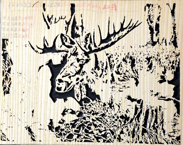

Frank Pellow Posted February 2, 2020 Report Posted February 2, 2020 (edited) Week 1: I started another Mike Williams pattern this week. It's the fourth one of Mike's patterns that I have tackled. Like the others, it's a big challenge. As I have done with his other patterns, I will keep track of progress here with weekly reports. Here is a photo of the finished 'Moose' that I found on Mike's web site: I’m cutting this out of 6mm thick mahogany veneer; a material I have never used before. In this photo, I am making the first cut: The photo below shows the back side of the veneer after about four hours work. The back side is Ash. I’m spending a lot of time cutting very small holes all over the panel. This work is very tedious. I have to use a 3/0 spiral blade for the task and these blades are quite brittle and break frequently. It takes considerable time, I would say an average of 1.5 minutes per hole, to get things set up and then only about 3 seconds to make the cut. Another problem with these small holes is that one does not see much progress. I’m using a 2/0 spiral blade for the larger holes, starting at the middle and working outwards. The 2/0 blades are much stronger, with no breaks so far. It’s much more satisfying to cut these holes and progress is obvious. One thing that I am being particularly careful with while doing this cutting is not to leave any long narrow "peninsulas". With this material, peninsulas are very week and have a high risk of breaking while one forgets about them and cuts something else. There are lot of peninsulas in the design and I plan to cut them last. The photo below shows progress at the end of the week, after 370 holes have been drilled, many of them cut, and 11.25 hours spent on the project: Edited March 5, 2020 by Frank Pellow jollyred, JimErn, GPscroller and 5 others 8 Quote

Frank Pellow Posted February 9, 2020 Author Report Posted February 9, 2020 (edited) Week 2: Here is a photo showing the state of the project after 2 weeks elapsed time, 15.5 hours actual time, and 690 holes drilled: Edited February 16, 2020 by Frank Pellow barb.j.enders, Hawk, meflick and 1 other 4 Quote

Frank Pellow Posted February 23, 2020 Author Report Posted February 23, 2020 (edited) Week 4: Here is a photo showing the state of the project after 4 weeks elapsed time, about 28.5 hours actual time, and 900 holes drilled: That is almost all the holes drilled. I hope to finish all the cutting next week. Edited February 23, 2020 by Frank Pellow Quote
Scrappile Posted February 23, 2020 Report Posted February 23, 2020 Really coming along nice. What your are showing is the back of the picture, right. I have the one I did hanging on my wall and it looks quite different and at this point in your cut I was not sure it is the same pattern. But after staring at them I finally go myself orientated and realize it is the same or maybe I framed my wrong..... Quote
Frank Pellow Posted February 23, 2020 Author Report Posted February 23, 2020 4 hours ago, Scrappile said: Really coming along nice. What your are showing is the back of the picture, right. I have the one I did hanging on my wall and it looks quite different and at this point in your cut I was not sure it is the same pattern. But after staring at them I finally go myself orientated and realize it is the same or maybe I framed my wrong..... Yes, It's the back that I am showing in the photos. I find that I can see progress batter looking at the back than I can looking at the pattern on the front. The veneer layer on the back is light Ash. The front veneer layer is much darker Mahogany. Quote

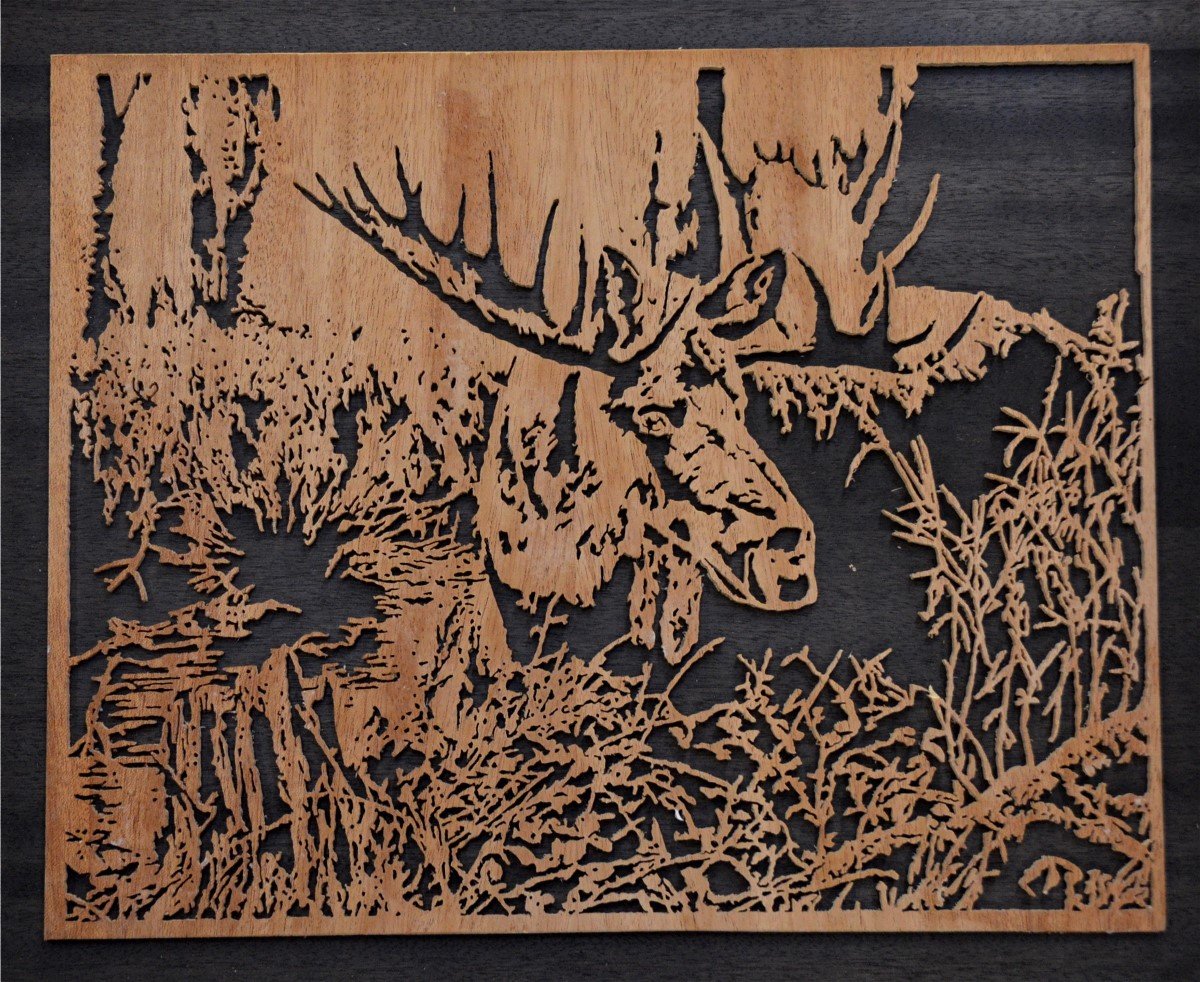

Frank Pellow Posted March 1, 2020 Author Report Posted March 1, 2020 (edited) Week 5: The total actual time spent drilling and cutting this was about 38 hours and about 920 holes were drilled. The last thing that I cut was a number of long peninsulas and this cutting can be very tricky because the material at this point is very weak. Here is a photo of one such peninsula being cut: Here is a photo of the cut piece sitting on a stained piece of the same material that was used in the foreground: I still need to clean up the piece a bit, glue on a piece with I accidently broke off while move things around, glue the foreground to the background, spray varnish it, make a frame, and frame the work. I hope to have all that done some time in the next week. Edited March 1, 2020 by Frank Pellow Dave Monk, Scrappile, meflick and 4 others 7 Quote
