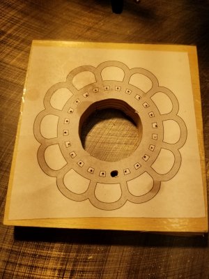

barb.j.enders Posted November 9, 2020 Author Report Posted November 9, 2020 Next step - patterns are all glued up. Stacked 4 layers. I did not pre-stain anything as I thought I might. I have the day off today so the cutting will begin. I am planning to use the Niqua 2/0 blades, but will see how that goes. don watson and danny 2 Quote
barb.j.enders Posted November 9, 2020 Author Report Posted November 9, 2020 Very quickly moved to Pegas mg#1 blade. Will finish this piece and see if I can salvage the inner circle. don watson 1 Quote
barb.j.enders Posted November 9, 2020 Author Report Posted November 9, 2020 On 11/5/2020 at 10:37 AM, Fedido said: As far as staining, you can pour stain into a aluminum cooking tray and dip the projects to get everywhere. I have done that and it works great. Just a thought. I have done that for other projects as well don watson 1 Quote
barb.j.enders Posted November 10, 2020 Author Report Posted November 10, 2020 2 1/2 layers done yesterday. Switched to a #1MG blade. Layer 1, 37 holes, approximately 1.5 hours. Did some sanding between cutting. Layer 2, 29 holes, approximately 1.75 hours. Layer 3, 101 holes. So far about 45 minutes of cutting. danny and don watson 2 Quote

barb.j.enders Posted November 12, 2020 Author Report Posted November 12, 2020 Three of six layers cut. Layer three has 101 holes. Took about 2 3/4 hours. Hopefully will get layer 4 cut this weekend! It has 207 holes!!! cashew, Fedido, don watson and 1 other 4 Quote

barb.j.enders Posted November 27, 2020 Author Report Posted November 27, 2020 More progress on the 4th layer. So far it has been about 5 hours of cutting over 2 sessions. don watson and danny 2 Quote
barb.j.enders Posted November 29, 2020 Author Report Posted November 29, 2020 Fourth layer is complete!! it was about 2 1/2 more hours. Total approximate time 8 hours. don watson 1 Quote
