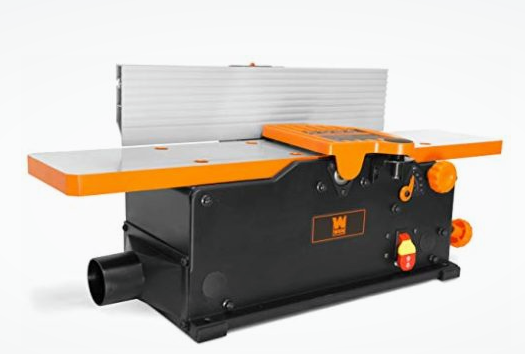

John B Posted May 4, 2022 Report Posted May 4, 2022 (edited) Barb, Have you considered a small 6" bench top buzzer, something like this one.? https://www.homedepot.com/p/WEN-10-Amp-6-in-Spiral-Benchtop-Jointer-JT630H/315052417?=&irgwc=1&cm_mmc=afl-ir-2237065-456723-&clickid=WPs0-qQPmxyITJW0fEwxs2ifUkGSpHy5tTqRVQ0 Edited May 4, 2022 by John B OCtoolguy 1 Quote
barb.j.enders Posted May 4, 2022 Author Report Posted May 4, 2022 2 hours ago, John B said: Barb, Have you considered a small 6" bench top buzzer, something like this one.? https://www.homedepot.com/p/WEN-10-Amp-6-in-Spiral-Benchtop-Jointer-JT630H/315052417?=&irgwc=1&cm_mmc=afl-ir-2237065-456723-&clickid=WPs0-qQPmxyITJW0fEwxs2ifUkGSpHy5tTqRVQ0 I have not considered something like this. At this point, I only have a 4' "bench" in my shop. Currently it is holding my air compressor for the airbrush. I guess before I get around to buying anymore tool, I really need to redesign the space and build a longer bench. John B and OCtoolguy 2 Quote
