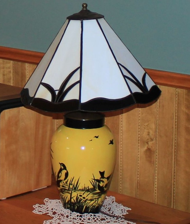

planeur Posted September 1, 2022 Report Posted September 1, 2022 Hello scrollsaw pro ! After my garden flowers season , I will have that interesting project ! I have a ceramic lamp that my mother at the age of 17 in 1927, had painted at her school with the nuns , and I would like to make a wood lamp-shade , on my scrollsaw. Birds and flowers will be most of the patterns as the lamp, and as you see I will make it octogonal . The actual lamp-shade in stained glass was made by my sister, which is beautiful but I want to try a wood version! The actual lamp-shade (glass part ) is 10 " hight, and 15 ” in dia. at the largest point at base. The rod supporting the lamp-shade, and the top plate over the ceramic lamp are in brass, that I has just cleaned. The top round plate is 4”, and has to be there for supporting the lamp-shade. I want that we see more the brass plate than presently , with a shorter lamp-shade ) I made a test in paper to see the shape , which is smaller at 10” at the base and 8 “ hight and 4” at the top . And I would also bend the shade at 3/4 near the top , to have smaller top than 4" , but my drawing is not yet finished, still thinking about it. With the lamp colors and patterns, what would be your suggestions for the wood, or others patterns. I was thinking of a bit of ebony , mixed with others woods. Do you have, some ideas, sites, for a lamp-shade of that kind . I saw some on the web. and I try to reach one of them with no result. So I would appreciate very your advises and thank you in advance! planeur OCtoolguy, frankorona, Loskoppie and 3 others 6 Quote

planeur Posted February 19, 2023 Author Report Posted February 19, 2023 Hello scrool saw experts, at last my lamp shade is on its way! It will be with cherry wood! À suivre planeur OCtoolguy 1 Quote
planeur Posted February 19, 2023 Author Report Posted February 19, 2023 I began to cut my 8 pieces of wood , without knowing yet how I will do the top part of each 8 pieces. As on the photo, will it be straigh as on the actual shade in stained glass or the final 2" with an angle ???? This way will be lot more difficult , with the cutting at an different angle than the buttom part. So what are your suggestions or ideas ? Those pieces will be around 1/8" thick or more. First cuts today from a big piece of cherry, left from my rocking chair. À suivre....! planeur barb.j.enders, meflick and OCtoolguy 3 Quote

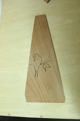

planeur Posted March 2, 2023 Author Report Posted March 2, 2023 (edited) Now I have to decide what are the patterns I will put on it, looking partialy as my Mother did on the base in 1930 Will be as this one If you have some ideas I am interested ! Need your advise .... about that .... How would you do to hold the center part of the birds , once I cut it from one of the 8 parts. I want to cut only the thickness of the blade. I tought putting a small piece of plexiglass glue behind . What do think about it ? You have surely others ideas.... Today.... First test of cutting and light behind.... without light with light so completed cutting around the bird flower would need something at the back. I could cut a larger stroke to be more visible, or it is OK. And I will also add some flowers and patterns , so the light may be more visible. What do you think .... Thanks ! planeur Edited March 2, 2023 by planeur Scrappile and OCtoolguy 2 Quote

barb.j.enders Posted March 21, 2023 Report Posted March 21, 2023 Looking great. For a shade behind the cutting I used a translucent paper. OCtoolguy and planeur 1 1 Quote

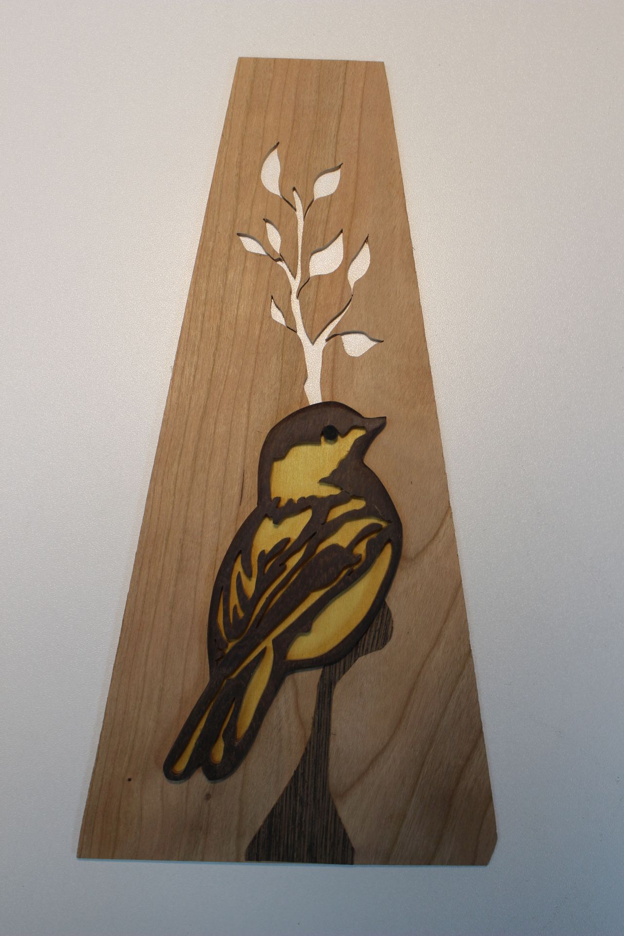

planeur Posted March 23, 2023 Author Report Posted March 23, 2023 Here is somes of my inserts , in ebony , and I put to reinforce at the back of the bird (chickadee ) a MDF with real wood on each side , total of .096" , because the cuttings was very delicates ! Still have some sanding on a couple of them! Not finish yet of cutting inserts , I have lot of fun to create all kind of set-up ! So here they are..... the bird as on the base ... or with an red eye .. not sure yet.... and finally the bird is bigger than the others inserts. Very happy .... but still somes to come, and somes will be cut directly in the 8 panels À suivre planeur OCtoolguy and Scrappile 2 Quote

planeur Posted March 24, 2023 Author Report Posted March 24, 2023 Other eye for my bird.... like it better....! And you ? And I know that the bird's color is not .... real, but as the one on the base! planeur OCtoolguy and Scrappile 2 Quote

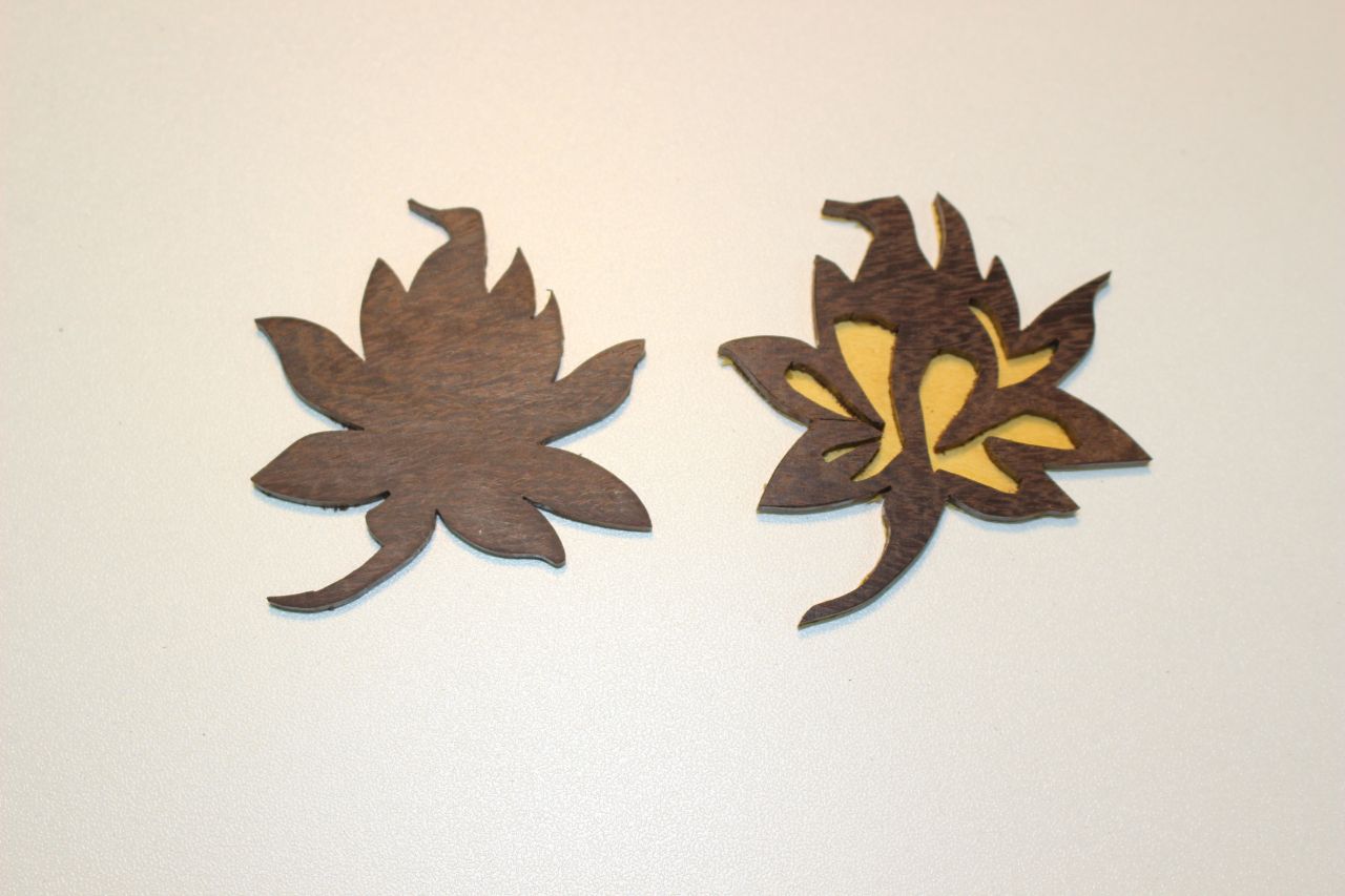

planeur Posted March 27, 2023 Author Report Posted March 27, 2023 La suite... Couple more items to be part of my projet ! Also working on how will I put some of them on my 8 panels. This one is marquetry sheet on a MDF with a thin real wood, + a yellow marquetry on the back so the light may come out. And very delicate cutting once glued , as you see ! And those 2 Love very much that projet ! À suivre planeur OCtoolguy and JessL 2 Quote
OCtoolguy Posted March 28, 2023 Report Posted March 28, 2023 On 3/23/2023 at 7:11 PM, planeur said: Other eye for my bird.... like it better....! And you ? And I know that the bird's color is not .... real, but as the one on the base! planeur I like the red eye. It stands out. Quote
OCtoolguy Posted March 28, 2023 Report Posted March 28, 2023 It's going to be a real work of art. Done with love! planeur 1 Quote
Scrappile Posted March 28, 2023 Report Posted March 28, 2023 The bird is the perfect color to go with that lamp.. I agree with Ray. You are going to have a very unique and beautiful lamp...Can't wait to see the finish. planeur 1 Quote
planeur Posted April 7, 2023 Author Report Posted April 7, 2023 (edited) Bonjour ! After a couple of tests and tries, here are some progress, your advises are welcome ! The finish product is not yet on the panel, will wait after the final assembly , with the adhesive. Some sanding and final touch are also to be done on some! Here they are: And the next is not yet decided ( almost ) with or without the wood bird without with the bird and finaly what do you think of my flower transformed in a butterfly after a couple of cutting and with her antenna Very satisfied of my progress, have a lot of fun to create, choose, testing all kind of items to be inserted. À suivre planeur P.S. All the yellow marquetries will have light coming out. Edited April 7, 2023 by planeur Quote
