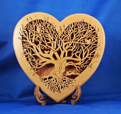

barb.j.enders Posted December 11, 2023 Report Posted December 11, 2023 I did these two in thicker wood because I thought the wood enhanced the picture. The eye has a backer of black poster board. The hand has no backer. Scrappile, OCtoolguy and JackJones 2 1 Quote
