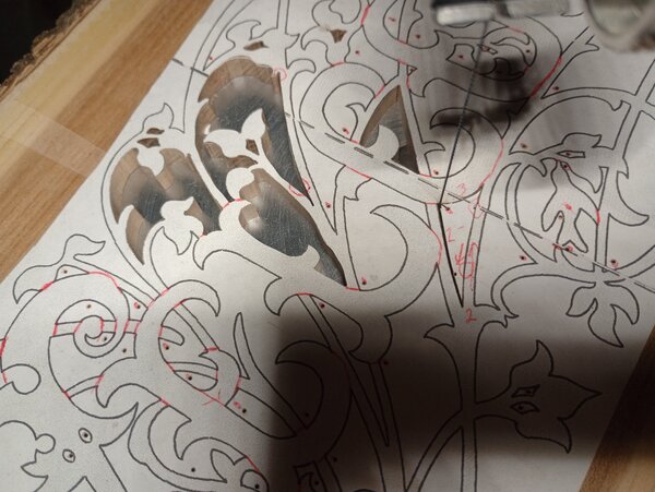

Popular Post Wichman Posted December 13, 2023 Popular Post Report Posted December 13, 2023 I'm starting another fancy welcome sign and thought I'd post the procedure at least how I do it and why. The start, most of the pilot holes drilled. Wood sanded to 220, shelf liner applied, pattern applied, pilot holes drill (most of them): First couple of cuts. Started to make a mistake, I needed to cut the small holes inside the leaf before cutting the leaf itself, no support for cutting: Another couple of holes cut. If you zoom in on the picture you'll see a red circle, that's where I backed the blade out of the cut and spun the blade around went backwards towards the sharp point, then sawed outward to maintain a sharp point. I'm having issues with the new phone, thought I had more pictures but can't find them right now jollyred, bryon c, smitty0312 and 8 others 11 Quote

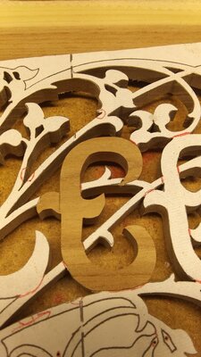

Wichman Posted December 14, 2023 Author Report Posted December 14, 2023 Let me back up a moment. Here is one I finished before: One issue I had with the first one is the letters were too bland so I had to stain them a bit darker than the rest of the pattern. I found that if I scored the wood very lightly with an Exacto knife, the stain would stop at the score line (light coat of stain) knowing this going in I have marked in red where I will be scoring the wood: and I have selected and tested a stain for contrast to make the letters stand out: Quote
Wichman Posted December 14, 2023 Author Report Posted December 14, 2023 (edited) In this picture I am trying to show my method of cutting sharp inside angles . I start on a side and cut down to the sharp angle (1). I then back out a bit and spin the blade 180, cutting to the waste area. Next I back the blade down the kerf to the bottom of the angle, then cut the other side of the angle (2). On this cutout I had to do this twice for the tight angles (3) Edited December 14, 2023 by Wichman Quote
Wichman Posted December 14, 2023 Author Report Posted December 14, 2023 This should be the last update for a while These are closeups of the letter before and after the pattern (mask) is removed. oops danny and JackJones 2 Quote

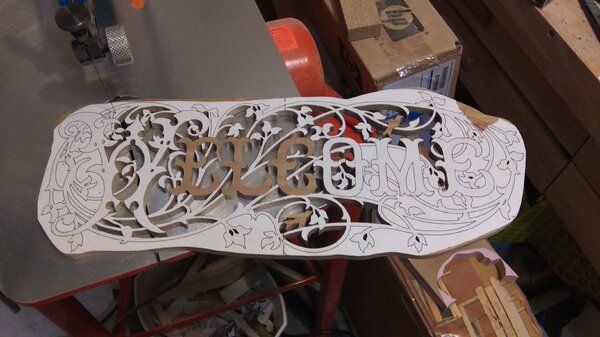

Wichman Posted December 16, 2023 Author Report Posted December 16, 2023 (edited) This pattern is from the Book Classic Fretwork Scroll Saw Patterns by Patrick Spielman & James Reidle. At this point the piece is 13 1/2" long. I used a #3 blade to cut around the pattern and make it easier to rotate past my belly In this picture, I've cut out all the small holes while I still have support. I only drilled the holes I want to cut at this point, so I can find them from the back I had already drilled the pilot holes on this side before I realized, not to drill the holes until I wanted to cut them. And this, Ladies and Gentlemen, is 5 hrs of cutting: Edited December 16, 2023 by Wichman Quote
