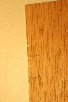

planeur Posted February 23, 2024 Report Posted February 23, 2024 Hello blade experts , I have a question after a test I did with a blade. I was cutting a marquetry sheet with my scollsaw with the blade with the teeth facing down, as normal! But if you take a look at the photos, you will see that the cutting is better under the sheet when cutting and worse the other side ( the top side ) So my question is : do you cut sometime with the blade the teehs facing up? I had to cut a sheet on my projet which was already glued to the projet so I did cut it with that method and it worked as the testings. Will shoe you soon my projet... planeur OCtoolguy 1 Quote
Wichman Posted February 23, 2024 Report Posted February 23, 2024 Since marquetry panels are usually very thin, I need to ask a question: are you using a reserves tooth blade? If you are, there's your answer. If you are cutting a 1/8" thick panel you should be trying for a blade with 42 tpi for a 1/16" panel then upwards of 84 tpi, and that's into jewelers blade territory. (this is bases on the concept of having 3 teeth engaged in the material at any given time). JTTHECLOCKMAN and OCtoolguy 1 1 Quote
planeur Posted February 23, 2024 Author Report Posted February 23, 2024 Thanks Wichman, but what is a reserve blade ? If I understand it should have more than one theeh in the thickness of the piece we cut ! Right ? That make sense. And I do not use a tooth blade with that much teeths. I am using Pegas blades with 12 or 14 or 22 tpi ( # 5 #7 and #9 ) Nerver see saws with so much teeths. planeur OCtoolguy 1 Quote
Solution Wichman Posted February 23, 2024 Solution Report Posted February 23, 2024 A reverse tooth blade has 7 to 10 teeth on the bottom of the blade that saw in the opposite direction, the effeect in thicker wood is that the fuzzies or rough edges are reduced. Typically a reverse tooth blade will have an R in the name or abbreviation, You probably need to look at using a much smaller blade, #1 or #2/0. OCtoolguy 1 Quote
planeur Posted February 23, 2024 Author Report Posted February 23, 2024 Thanks for your infos! Did not know that kind of blade! Have a good day planeur OCtoolguy 1 Quote

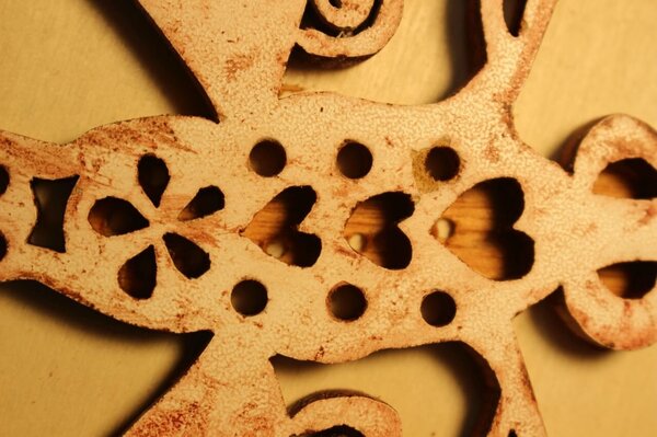

planeur Posted February 23, 2024 Author Report Posted February 23, 2024 What I had to cut is from the back of my piece , because the only place to see the pattern to cut. Back side top side before cutting À suivre... OCtoolguy 1 Quote
Wichman Posted February 23, 2024 Report Posted February 23, 2024 If you just have to cut from the back, then you could use tape ( painters tape, clear packing tape, or shelf liner ) to help minimize the splintering. OCtoolguy 1 Quote
planeur Posted February 24, 2024 Author Report Posted February 24, 2024 Yes ...... I had forgot that trick! And it is a good one for that kind of thickness. Thanks ! My post is coming..... Planeur Quote
