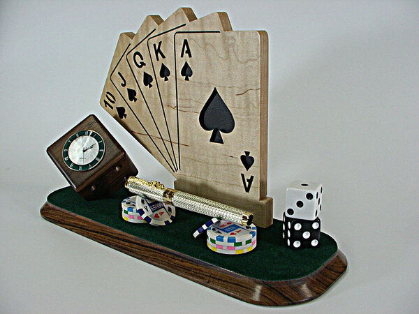

JTTHECLOCKMAN Posted July 23, 2024 Report Posted July 23, 2024 (edited) Agree with Kevin but will take it a step further. If you are painting a piece or just parts of a piece, leave the pattern on the face and spray lightly on one side. But here is the other trick. if you know you are going to paint the piece then use blue painters tape or tape of your choice on the back side as well and now spray the same way as you did the front with light spray. The 2 separate ways of painting will equal one way of painting but globing too much paint in the frets. Not pretty. Now if you are painting the back side of the piece the same color as the fret work then no tape needed on back side. I show a few examples of this. One other thing. if you are using a backer on the piece than it again does not matter if you get paint on back side so no tape needed. Now to take this even further if you are doing multiple colors then make sure you tape off the fret work where you do not want paint to go. That should be self explanatory. On both the playing cards and also the Irish items the edges of the fret work has been painted to match the background colors. I do this because it adds depth to the piece as opposed to just using a backer. It all depends on my mood or the project will dictate what needs to be done. The playing cards is a 2 layer piece with the back piece to be black on one side and maple on the other. Making sure I stayed away from the outside edges. and the Iris piece are also 2 layered pieces but the back piece is painted green both sides. Edited July 23, 2024 by JTTHECLOCKMAN Scrappile, OCtoolguy, barb.j.enders and 3 others 5 1 Quote

Hawk Posted July 24, 2024 Report Posted July 24, 2024 22 hours ago, JTTHECLOCKMAN said: Agree with Kevin but will take it a step further. If you are painting a piece or just parts of a piece, leave the pattern on the face and spray lightly on one side. But here is the other trick. if you know you are going to paint the piece then use blue painters tape or tape of your choice on the back side as well and now spray the same way as you did the front with light spray. The 2 separate ways of painting will equal one way of painting but globing too much paint in the frets. Not pretty. Now if you are painting the back side of the piece the same color as the fret work then no tape needed on back side. I show a few examples of this. One other thing. if you are using a backer on the piece than it again does not matter if you get paint on back side so no tape needed. Now to take this even further if you are doing multiple colors then make sure you tape off the fret work where you do not want paint to go. That should be self explanatory. On both the playing cards and also the Irish items the edges of the fret work has been painted to match the background colors. I do this because it adds depth to the piece as opposed to just using a backer. It all depends on my mood or the project will dictate what needs to be done. The playing cards is a 2 layer piece with the back piece to be black on one side and maple on the other. Making sure I stayed away from the outside edges. and the Iris piece are also 2 layered pieces but the back piece is painted green both sides. Excellent idea, think I'm gonna steal it (lol) for future projects. Thanks for the idea! Scrappile and OCtoolguy 2 Quote
JTTHECLOCKMAN Posted July 24, 2024 Report Posted July 24, 2024 18 minutes ago, Hawk said: Excellent idea, think I'm gonna steal it (lol) for future projects. Thanks for the idea! Hey steal away any or all the ideas. I am sure I have learned them from someone before me too. Just been doing this for so long. OCtoolguy 1 Quote
jimmyG Posted July 27, 2024 Author Report Posted July 27, 2024 On 7/22/2024 at 10:53 PM, JTTHECLOCKMAN said: Agree with Kevin but will take it a step further. If you are painting a piece or just parts of a piece, leave the pattern on the face and spray lightly on one side. But here is the other trick. if you know you are going to paint the piece then use blue painters tape or tape of your choice on the back side as well and now spray the same way as you did the front with light spray. The 2 separate ways of painting will equal one way of painting but globing too much paint in the frets. Not pretty. Now if you are painting the back side of the piece the same color as the fret work then no tape needed on back side. I show a few examples of this. One other thing. if you are using a backer on the piece than it again does not matter if you get paint on back side so no tape needed. Now to take this even further if you are doing multiple colors then make sure you tape off the fret work where you do not want paint to go. That should be self explanatory. On both the playing cards and also the Irish items the edges of the fret work has been painted to match the background colors. I do this because it adds depth to the piece as opposed to just using a backer. It all depends on my mood or the project will dictate what needs to be done. The playing cards is a 2 layer piece with the back piece to be black on one side and maple on the other. Making sure I stayed away from the outside edges. and the Iris piece are also 2 layered pieces but the back piece is painted green both sides. OCtoolguy 1 Quote
