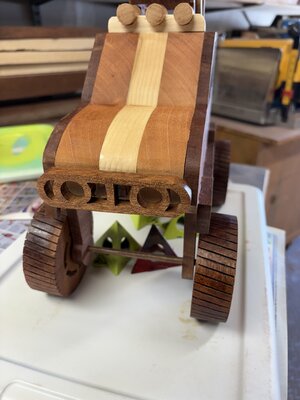

Allen levine Posted Friday at 07:08 PM Author Report Posted Friday at 07:08 PM I got this far today this weekend is gone as I'm picking up the 4 year old little monster and he expects his old crippled grandpa to give him uninterrupted attention morning noon and night I made it a four seater with space in between seats I'll put a shift stick in when I do the dash board and ateeeing wheel and some dials it will get a roof rack some fog lights light guards and whatever else I can make nothing is glued or sanded and I tried to hold it together with tape for a pic outer panels are sapele 3/8 th inch outside body parts are Spanish cedar 1 and 1/4 and inside body part is poplar 1 inch used a Flying Dutchman psr 9 blade for body parts and psr 7 for sapele panels the 7 blade was a bit aggressive maybe could have went down to a 3 but I'm learning have a look JackJones and BadBob 2 Quote

Allen levine Posted Friday at 07:46 PM Author Report Posted Friday at 07:46 PM i was already told the wheel supports grain orientation might make them suseptable to snapping off, but this one is going on a shelf in my office, noone, not even the monster boy coming over tomorrow gets to touch it. so it should be safe when its done Quote
rjweb Posted Friday at 10:53 PM Report Posted Friday at 10:53 PM Allen, looking good, keep us updated, enjoy your weekend, they grow up to fast, RJ Quote
Roberta Moreton Posted 9 hours ago Report Posted 9 hours ago That truck is looking pretty good! Quote
Allen levine Posted 7 hours ago Author Report Posted 7 hours ago I can't work on it this weekend got the little one but he can't seem to keep up with his grandpa I have to remake the wheels they are too thin for the look I want Quote
