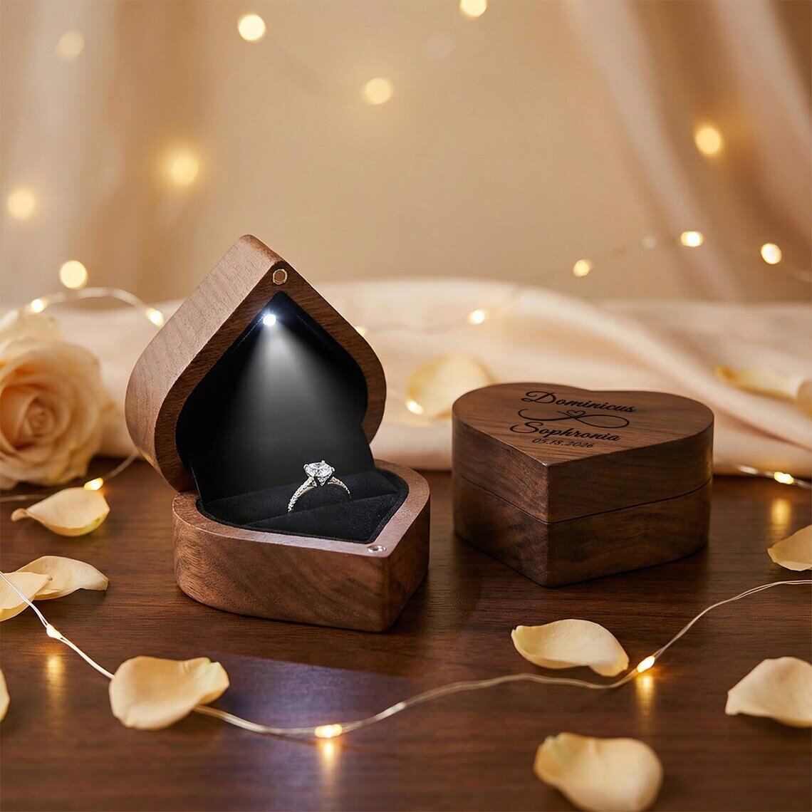

kmmcrafts Posted April 9 Report Posted April 9 I've been making a few ring boxes just playing around and I run across these boxes doing some research. Any idea on where they get the light and parts to make this work. I've done some searching on YouTube and found a person that put a battery tea light into the box to sort of create this but then you'd have to turn on or off the light via tea light switch and seems like you'd have to make a big bulky box to hide the tea light. I suppose you could remove the light from the tea light candle and use the circuit board / battery etc. but still would be stuck with the on/off switch. I'm thinking the people on etsy selling these is buying them and just doing the engraving. I wouldn't mind even finding the blanks if anyone knows anything of that. The video's I've seen make it appear to have the light come on when opened but it may just be already on like would need if using a tea light. Mostly just thought it was a neat idea and mostly just curious on how they work without having to buy one to take apart, LOL GPscroller, OCtoolguy, Archer and 2 others 4 1 Quote
rjweb Posted April 9 Report Posted April 9 Kevin, I bought my wife a necklace that came in a fancy box and when you would open it the light comes on, close it light out, i really cant see how it was done and i know my wife would't let me take it apart. I purchaesd it on youtube durning the holidays, RJ kmmcrafts and OCtoolguy 2 Quote
Scrappile Posted April 9 Report Posted April 9 Might check youtube. looked like there was some info in circuitry with mini-led lights. Would, I think, hollow out the lid some fit battery, mini switch and light in than cover it over with felt or venneer. That would be my guess. kmmcrafts and OCtoolguy 2 Quote

CharleyL Posted April 10 Report Posted April 10 Not exactly what you are looking for, but here is a Youtube link for adding an LED light to a ring box. His switch is rather crude though. There are better ways, a magnetically activated reed switch is one of them. I have been searching for a kit to do this, but haven't found one for sale yet. LED lights of this size generally require about 20 milliamps (0.020 amps) to operate, and they will only light when connected properly. If connected backwards, they will not light. The circuit layout is a loop as he shows. Some LEDs require less and some considerably more power, but with higher power requirements, the LED is going to be much bigger than what he is using. A resistor has to be selected of the correct value to limit this ampere flow depending on the voltage of the power source (battery) chosen and the voltage drop across the LED that is chosen (forward voltage drop). The LED Specifications will give you the needed information. Ohm's Law is used to determine the resistor value required based on the LED parameters and the voltage of the battery that is chosen. One of those coin shaped batteries in the 7 - 12 volt range should work well. Unfortunately, the resistor value needed cannot be chosen, until you pick the battery and the LED that is suitable for your need. Radio Shack used to be a good source for small quantities of these parts, but now you will need to go online and order them from an electronics supply house. Newark and Allied are the biggest in the USA, or from an Electronics (not electrical) Supply near you. Electrical Supply stores sell electricians house and industrial wiring and supplies. Electronics Supply Shops sell electronic parts - there is a big difference. These are "Electronic Parts". Mouser is another that I once bought from. Automation Direct in the Atlanta, GA area would probably have what you need too. I'll try to add a few more sources when I can remember them right now (old age setting in). Charley kmmcrafts 1 Quote
CharleyL Posted April 10 Report Posted April 10 Jameco is a good source of these parts and one of the names that weren't coming to me. They sell a lot of import parts as well as USA made, so for a project like this the cheapest source will likely work fine for the parts that you will need. A tip about the LED - If the LED is designed for a rated voltage, the resistor needed for it to work at that voltage is already part of it, so an additional resistor won't be needed, but the battery must be chosen to supply that LED voltage. Again, the LED will only work when connected the correct way. It will not work if installed backwards. It's a Diode, so only passes electrical current in one direction. If it doesn't work, just swap the connections. Charley kmmcrafts 1 Quote
JTTHECLOCKMAN Posted April 11 Report Posted April 11 I ordered a box from Amazon for $6 and actually is a nice box for a ring. I will look it over and reverse engineer it. These use small watch batteries. They from what I understand work on either a photo eye of sorts or a magnetic switch. But I also hear or read the led is not very bright. That is why you see all the photos with dark backgrounds. I am sure the photos are AI too. Supposibly the life time of battery is about 12 hours continuous use. Can not be replaced. I am sure there are ways around this. Could always use 2 lights if a larger box. Could be a nice addition. Kevin, you said you ordered the lights. Where did you get them? I want to play with some myself. Yes a LED is a light emitting diode so polarity is important. To take it another step. Many many years ago when fiber optic wire first came out, I worked in a plant that produced it and was able to get some to play around with. I thought back then that was the coolest thing invented. Now look what it can do. But I use to make models of all kinds and made a bunch of Ertel semi truck models. This was back when CB's first hit the market and all truckers were using them. Heck I even built my own power mike for my CB with parts from Radio Shack. But the fiber strands I was able to custom make my truck models with working headlights and tail lights and even lights on the dash. Lit the running lights and put lights in the sleeper part of the cab. I hid a 9V battery and light source under the bed with a small switch in the sleeper cab. It turned out pretty cool. Brings back memories. kmmcrafts 1 Quote
CharleyL Posted April 11 Report Posted April 11 I would put a false bottom in the box and hide the battery under it. Possibly one of those flat watch batteries, like a CR2025 or smaller. I haven't looked, but by now they likely have holders for them so the battery can be replaced easily. A very small micro switch with a spring wire lever could be placed under this false bottom too, and a slot for the spring wire actuator could allow it to reach through this hole and sense the box lid to detect when it was open, and turn on the LED mounted in the lid. If you make the false bottom so it can be lifted, but held in place by close fit friction, you have a way to replace the battery when needed. For a 20 milliamp load, the wires can be very tiny, but need to be flexible at the box hinge, so need to be stranded. The latest LED designs are very bright, and the ones with a rounded head have a lens built into them to concentrate the light upward through this lens, perfect for the light in the lid use. The old filament bulbs radiated the light out through the sides. These tiny LEDs radiate most of the light out through the rounded top end. Charley JTTHECLOCKMAN and kmmcrafts 2 Quote
kmmcrafts Posted April 11 Author Report Posted April 11 52 minutes ago, JTTHECLOCKMAN said: I ordered a box from Amazon for $6 and actually is a nice box for a ring. I will look it over and reverse engineer it. These use small watch batteries. They from what I understand work on either a photo eye of sorts or a magnetic switch. But I also hear or read the led is not very bright. That is why you see all the photos with dark backgrounds. I am sure the photos are AI too. Supposibly the life time of battery is about 12 hours continuous use. Can not be replaced. I am sure there are ways around this. Could always use 2 lights if a larger box. Could be a nice addition. Kevin, you said you ordered the lights. Where did you get them? I want to play with some myself. Yes a LED is a light emitting diode so polarity is important. To take it another step. Many many years ago when fiber optic wire first came out, I worked in a plant that produced it and was able to get some to play around with. I thought back then that was the coolest thing invented. Now look what it can do. But I use to make models of all kinds and made a bunch of Ertel semi truck models. This was back when CB's first hit the market and all truckers were using them. Heck I even built my own power mike for my CB with parts from Radio Shack. But the fiber strands I was able to custom make my truck models with working headlights and tail lights and even lights on the dash. Lit the running lights and put lights in the sleeper part of the cab. I hid a 9V battery and light source under the bed with a small switch in the sleeper cab. It turned out pretty cool. Brings back memories. No I didn't order any lights.. I ordered barrel hinges and magnets.. For a different project I did order some LED strip lights that you cut to whatever length you need or add sections together. I don't think these would be a good option since you only need one bulb for the box though. I did watch a YouTube where the person used a tea light candle for the ring box they were making. Looked pretty neat but I feel like it's be hard to hide a tea light within the box.. but those can be purchased in bulk on Amazon or many places for $0.50 ish each. I ordered a bunch for some of the table decorations for my daughters wedding and they were on for a good 8 hours or so then sat out in the cold shed all winter. Lost power a week ago and dug out some of those tea light and to my surprise they worked for another 4 hours or so, LOL. That's an idea for a light source for a box. I took one apart and the inside was just a circuit board with the switch on one side and the light on the other side. This might be more doable.. but it would need to be turned on / off somehow. Quote
JTTHECLOCKMAN Posted April 11 Report Posted April 11 (edited) 1 hour ago, kmmcrafts said: No I didn't order any lights.. I ordered barrel hinges and magnets.. For a different project I did order some LED strip lights that you cut to whatever length you need or add sections together. I don't think these would be a good option since you only need one bulb for the box though. I did watch a YouTube where the person used a tea light candle for the ring box they were making. Looked pretty neat but I feel like it's be hard to hide a tea light within the box.. but those can be purchased in bulk on Amazon or many places for $0.50 ish each. I ordered a bunch for some of the table decorations for my daughters wedding and they were on for a good 8 hours or so then sat out in the cold shed all winter. Lost power a week ago and dug out some of those tea light and to my surprise they worked for another 4 hours or so, LOL. That's an idea for a light source for a box. I took one apart and the inside was just a circuit board with the switch on one side and the light on the other side. This might be more doable.. but it would need to be turned on / off somehow. OK I misread your post. Yes those hinges I bought off Amazon along with the mgnets. That was easy as it turned out. These LED lights used in these boxes look like the light bulbs they use if these LED flashlights. As I said I will take one apart and see what it is all about. Being an electrician I have some knowledge that I am sure I can incorporate. I did not even know they made these boxes untill you posted. Like I said I bought a bunch of the plain ones and the woods used and fit and finish is really good for China made and that is where they are from. Have to take those little stickers off if you buy them and use them. I make pens as you know and have a lighthouse pen that has a led light in the cap that is made to look like the beacon signal lamp. It can change colors and all. Now that wiring system is small as well as the batteries used. So today they can make anything. Edited April 11 by JTTHECLOCKMAN kmmcrafts 1 Quote
JTTHECLOCKMAN Posted April 11 Report Posted April 11 2 hours ago, CharleyL said: I would put a false bottom in the box and hide the battery under it. Possibly one of those flat watch batteries, like a CR2025 or smaller. I haven't looked, but by now they likely have holders for them so the battery can be replaced easily. A very small micro switch with a spring wire lever could be placed under this false bottom too, and a slot for the spring wire actuator could allow it to reach through this hole and sense the box lid to detect when it was open, and turn on the LED mounted in the lid. If you make the false bottom so it can be lifted, but held in place by close fit friction, you have a way to replace the battery when needed. For a 20 milliamp load, the wires can be very tiny, but need to be flexible at the box hinge, so need to be stranded. The latest LED designs are very bright, and the ones with a rounded head have a lens built into them to concentrate the light upward through this lens, perfect for the light in the lid use. The old filament bulbs radiated the light out through the sides. These tiny LEDs radiate most of the light out through the rounded top end. Charley Charley I was going by the reviews on see on Amazon and other sites when I mentioned the light output. Just like my story about the fiber optic cable the more you round over the end of the fiber the more light it puts out and that is how they amplify the signals too. I use to just melt the end with a match to round it over. It was amazing how much more light you got. But if wanted a pin spot then do not melt. I do miss Radio Shack. Quote
JTTHECLOCKMAN Posted April 13 Report Posted April 13 (edited) Just an update. I got the box I ordered from Amazon today $6. have to say I was very surprised to see the light is actually very very bright. You can look them up. It is the red burgandy acrylic octagonal ring box with a gold trim ring around it. Again have to say very well done and looks beautiful. Inside is a beautiful white soft felt linning and soft pillow for the ring. Nice size. The light workings is in the lid. I can feel the flat battery when pressed on the felt. It will take some cutting to get to the works because felt is glued into place. There is no way to change the battery when it dies. It does come on when lid is opened so it has to be a reed switch of some kind. It is not photo sensitive. When I do get it cut open I will take a photo. The paint on outside has a velvet feel to it. Love to know what that paint is. Not one China sticker I believe these are American made. The box it came in is a matching red paper box. probably the cheapest looking part of the whole thing. I am going to have to investigate that paint. It is not an expensive box but not a bad looking one either. Have to thank Kevin for my extra work load and to add to my To Do List, as if I don't have enough on it. Edited April 13 by JTTHECLOCKMAN kmmcrafts and JackJones 1 1 Quote

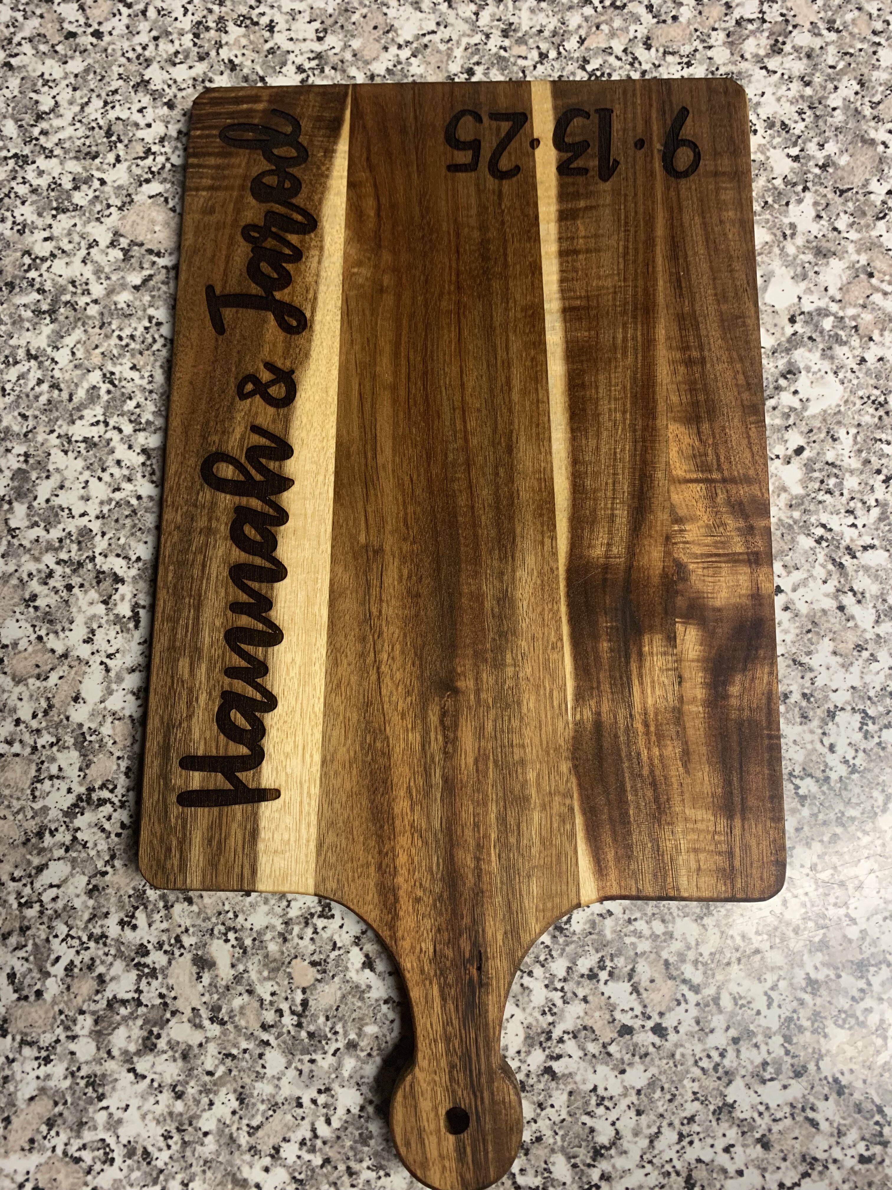

kmmcrafts Posted April 13 Author Report Posted April 13 (edited) Sorry JT for sending you down that rabbit hole. I may have to order a few of these just to do some laser engraving test on them.. Can't make them myself for that kind of money and what a nice box it could be with some personalization added to it. I've done this with some of those charcuterie boards.. they were on sale on Hobby Lobby website last year for $4.99 and they laser engrave beautifully.. I do think those were $10 each normally but, they're not too bad of a board just to use as like a serving board etc.. The wood feels a bit soft in my opinion for using as a cutting board but I just buy them to engrave and sell the upcharge for personalizing them. Edited April 13 by kmmcrafts Quote
