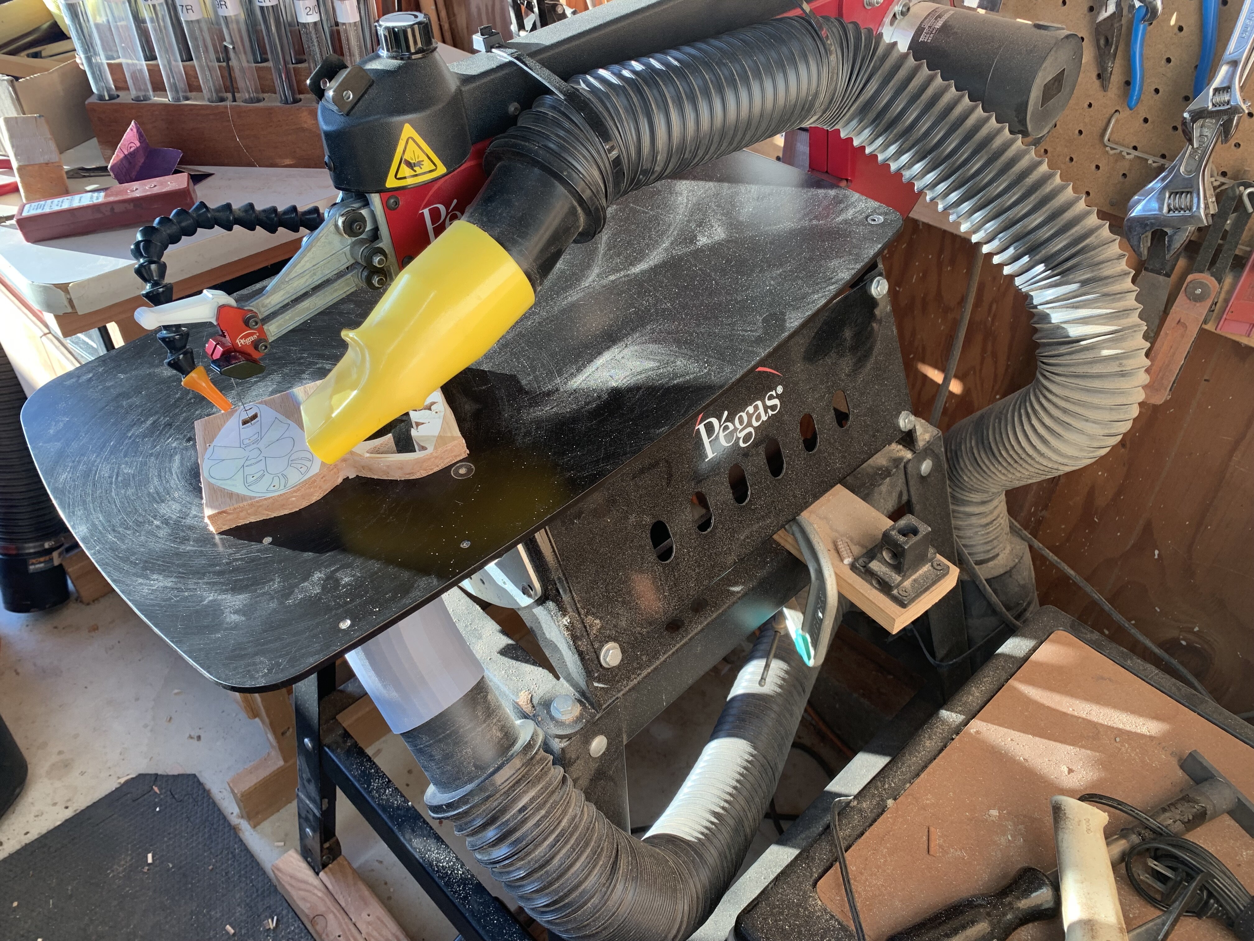

dgman Posted Thursday at 02:06 AM Posted Thursday at 02:06 AM Split the line to collect dust from the top also. That should do the trick! I use a full size dust collector with a 4” hose split into two 2” hoses hooked up to my Pegas. You should be able to to the same with your vac. There are a lot of hoses and adapters available at many woodworking stores and online. Here is a picture of what i use. OCtoolguy 1 Quote
Misha Posted Thursday at 05:27 AM Author Posted Thursday at 05:27 AM Wow, thanks so much for the info. I’ll try to split the hose and run it up top. I ordered a scrollnado hoping it would do something similar, but I’m afraid that choking the dewalt down to such small hoses is going to choke the airflow and destroy the dewalt. It hasn’t arrived yet, and I’m not sure if it’ll work. I like the way your system looks, may I ask where you picked up the yellow hose attachment up top? I’ve looked at the Foredom madc20 that Seyco sells and that’s my next attempt if this doesn’t work. Many thanks for the response!! OCtoolguy 1 Quote

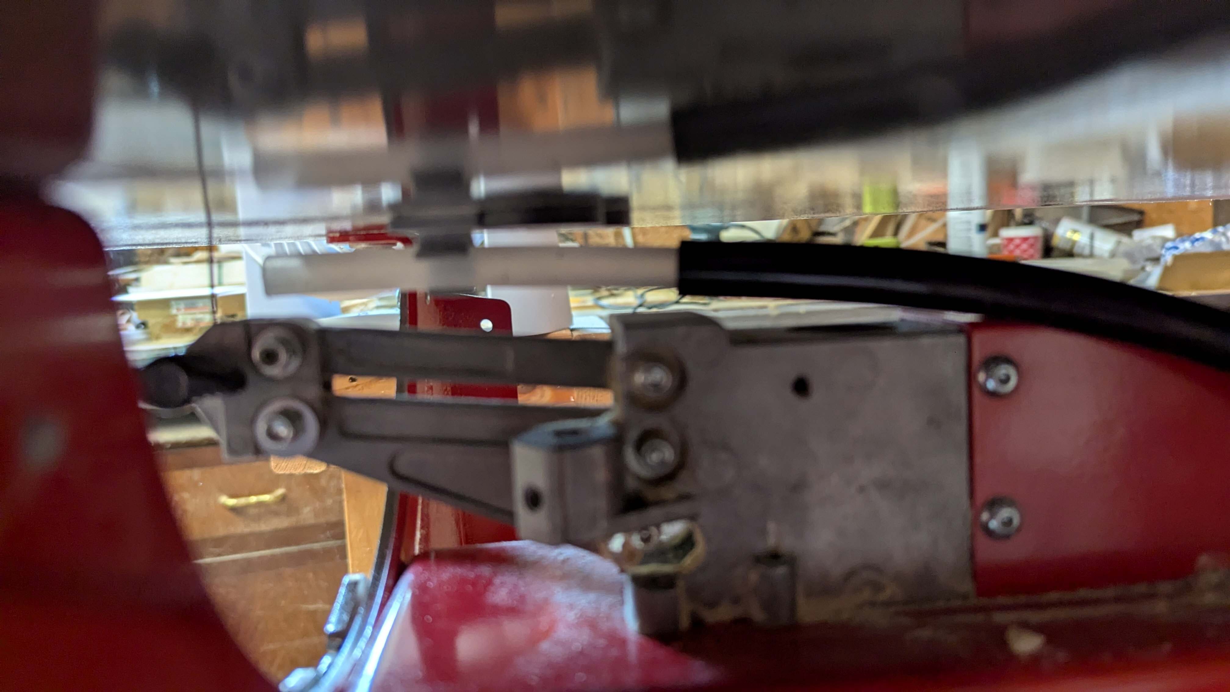

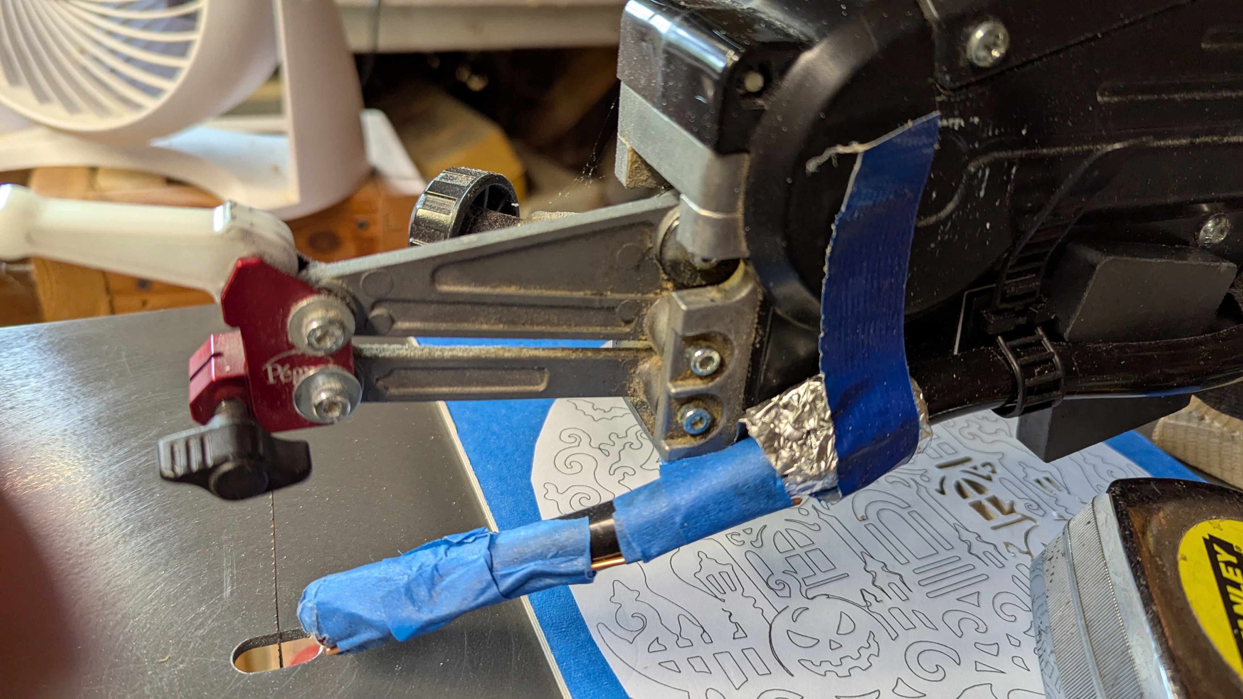

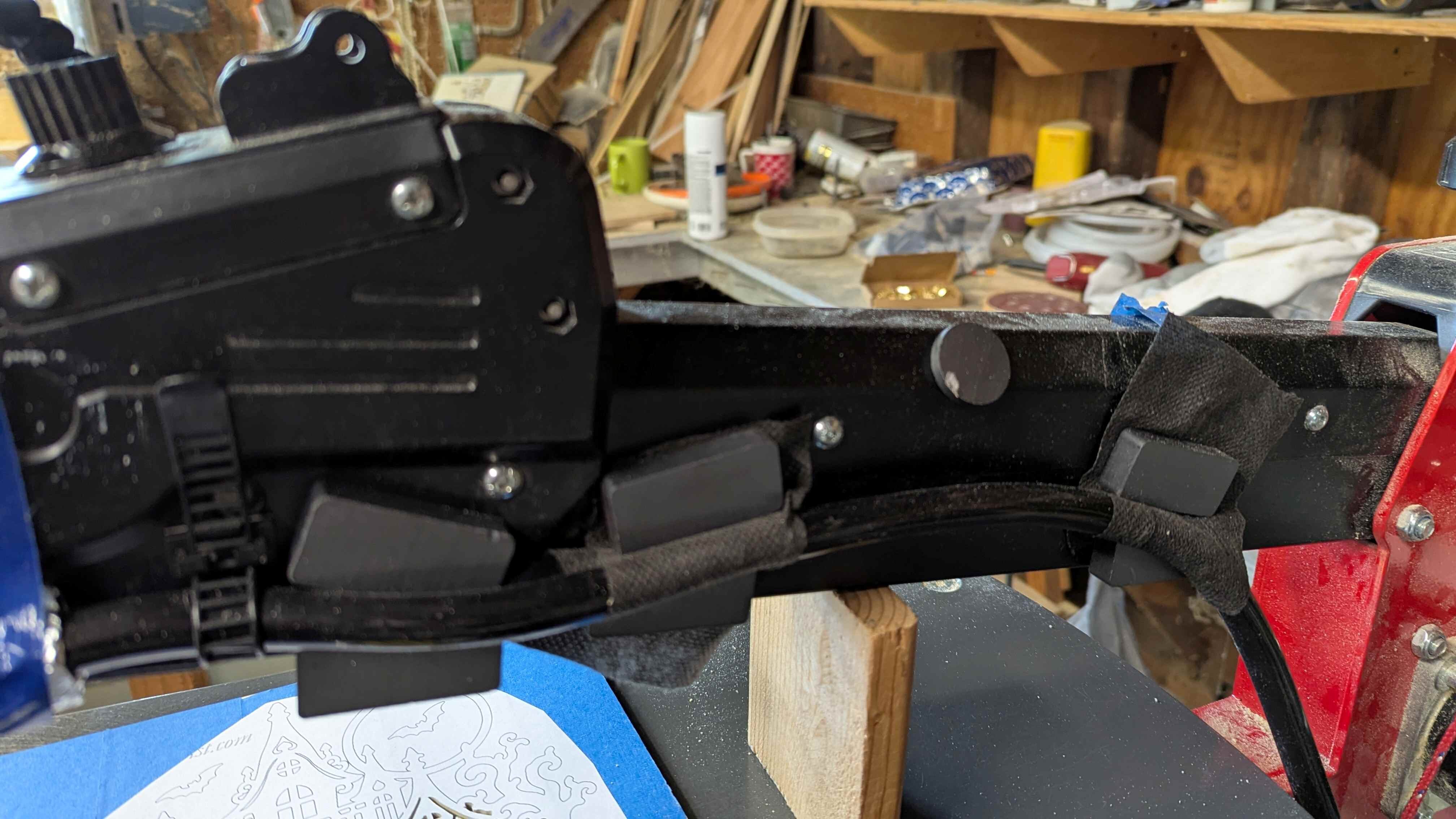

GregBennett Posted Thursday at 03:53 PM Posted Thursday at 03:53 PM I've been using the 12 gallon Stealthsonic with the Scrollnado on a Bauer scroll saw. It's been an adventure. It came with 1/4" flexible tubing at the dust collection end. I found it unworkable and I'm now using the 3/4 black hose by the blade and a 1/4" nylon hose at the base. I found that the attachment strips didn't hold for long. I'm using strong magnets to hold the upper tube in place and a Rube Goldberg adaptation at the top of the table. I've taped an onion bag on the end of the 3/4" hose to keep small pieces from getting wedged in the tube. It's been a work in progress since I started. I had problems with the DeWalt Stealthsonic heating up, which may be the result of using small diameter tubes. DeWalt was no help. They had me file a warranty claim with Alton Industries and 10 business days later i got the entire top of the vacuum in the mail. Guess what? It heats up too. They didn't ask for the old one back so now I switch them out when one gets hot. DGMan's tubes look impressive and I've seen where others have successfully used pvc pipe. I found that the fittings for the bendable suction tubes on the market are threaded, so I don't know how the users got them to mesh with the pipes. OCtoolguy 1 Quote
Misha Posted Friday at 03:51 AM Author Posted Friday at 03:51 AM You would think some company would have solved this already. Just as an fyi the way I’m trying to step down the stealthsonic is by ordering 2 “Y” splitters with blast gates. The first Y will go on the stealthsonic hose, the second Y will go in one of the two connectors on the first Y, leaving me with 3 avenues to vacuum with. I’ll run one hose to the top of the saw, the other to the bottom, and the third one I’ll use the blast gates to partially open and balance the dewalt’s pull. I figure with the gate partially open on the empty connector, the dewalt won’t be starved for air, I can step down the suction on the bottom enough to stop the awful whistling, or just not use the Pegas connection at all and rig a hose like pictured above, and rig a hose at the top. By giving the Dewalt a chance to suck air as needed maybe the whole thing goes into balance. The Y Splitters were 28 bucks each on Amazon and if this works it’s a whole lot cheaper than spending 900 bucks or more on the foredom! Anyway, it’s comforting to know other folks are working at a solution here! Thanks for the info everyone! OCtoolguy 1 Quote

Misha Posted 9 hours ago Author Posted 9 hours ago Sorry, last question. Dan, you do a lot of scrollling, you’re running big hoses up top. When you’re flipping the upper arm up to make an inside cut, isn’t that getting a bit unwieldy? That’s a lot of hose to move up and down, not the weight, just the wiggling mass. Is it something you’ve just gotten used to? Quote
dgman Posted 2 hours ago Posted 2 hours ago 7 hours ago, Misha said: Sorry, last question. Dan, you do a lot of scrollling, you’re running big hoses up top. When you’re flipping the upper arm up to make an inside cut, isn’t that getting a bit unwieldy? That’s a lot of hose to move up and down, not the weight, just the wiggling mass. Is it something you’ve just gotten used to? The weight of the hose is minimal. I have no problem lifting the arm. Quote
