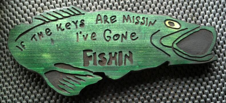

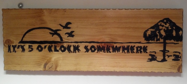

OutoftheWoodwork Posted July 12, 2013 Report Posted July 12, 2013 Here is my other obsession-routing signs, and a couple of my wine bottle holders. The bottle holders I've done have four shapes: Michigan, Standard, Wedding Bells, and a Wine Bottle. Like I've said, at least 90% of my work gets some sort of scroll work. although people have said I could just use my jigsaw I like using my scroll saw for cutting the shapes of them. Especially since I got my Excallibur; using him, there's very little sanding. It's amazing. bobscroll, Fab4, Travis and 2 others 5 Quote

OutoftheWoodwork Posted July 12, 2013 Author Report Posted July 12, 2013 Yes I do. I transfer it all to the wood using carbon paper, then route them. Usually with my trim router, now. I use my full-size router with the round over bit to only do the edges, pretty much now. I used to use the Porter Cable P100 H 100th Anniversary Edition (weighed like 30 pounds lol) for everything. That's what I learned on. He, unfortunately was stolen, and can't find a replacement. Phantom Scroller 1 Quote

OutoftheWoodwork Posted July 12, 2013 Author Report Posted July 12, 2013 (edited) Thank you so much Mahendra All these positive responses, I'm starting to blush lol As for the questions, I'm always available to answer them if I can. If you're going to look up a trim router, the one I use is the DeWalt 611 I believe. (It's in my trunk-since the break in, I don't keep my tools in the camper; at least not until I get it moved-so lets be even dumber and run around with a grand worth of tools in the trunk, right? lol) I use Publisher for my sign making, (with Word running in the background just in case I need it) and I did a google search for free fonts. I found fonts of every type imaginable, and looked at wood sign companies on line to get an idea on the fonts generally used. I will say, however, that I've used only a couple of theirs, and used what I thought worked best for the theme of the sign. I also found some fonts that are "picture" fonts (stars, flowers, plants, etc) and have used those as graphics. The one with John Wayne is actually a font (his picture). Attached is the latest sign I did for a customer. As for bits, I have a veining bit, 'V' groove, (two different sizes) and a few of the flat bits for cleaning out. I'll post a picture of my most used bits when I get over to the shop. Barb As for "stupid questions", the only stupid ones are the ones that no one asks. There's no such thing. Barb Edited July 12, 2013 by OutoftheWoodwork Quote
