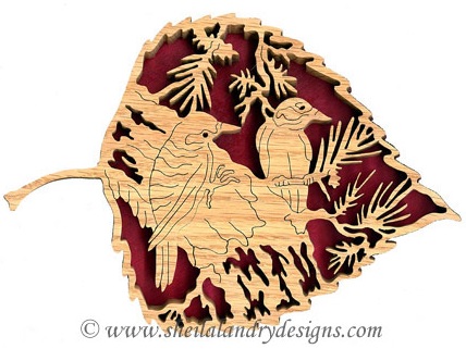

Popular Post Frank Pellow Posted September 9, 2016 Popular Post Report Posted September 9, 2016 (edited) These patterns can be found at: http://www.sheilalandrydesigns.com/category/wildlife-plaques/forest-leaf-patternsThe series contains 74 patterns and I like most of them. So far, I have ordered 10 patterns and have completed 3 of the 10. I'm sure that I will complete all 10 and that, eventually, I will order more of the patterns.The three that I have made so far, that is a loon, a kingfisher, and a heron, have been gifts and these gifts were very well received. I'm also sure that I will be making additional loons, kingfishers, and herons.I'm going to use the thread to record my progress in the series. So far, I have increased all the patterns by 10% in size, I have cut them all from 6 millimetre thick. Baltic Birch plywood and have backed them all with Oak-veneered fibre board. Photos are attached. Edited September 9, 2016 by Frank Pellow Fab4, TripleJScroller, Be_O_Be and 7 others 10 Quote

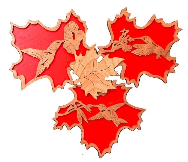

Frank Pellow Posted October 2, 2016 Author Report Posted October 2, 2016 Three Hummingbirds (part 1 of 3):(note: I seem to be unable in insert photos in-line into the text, therefore I am splitting this post into 3 parts in order to accomplish that effect.) This pattern is Sheila Landry's catalogue number: LL1007. I'm attaching a picture of the item that she has posted on her web site. I like the hummingbirds but I really dislike the red background. Quote
Frank Pellow Posted October 2, 2016 Author Report Posted October 2, 2016 (edited) Three Hummingbirds (part 2 0f 3): In Sheila's design, the three leaves are held together only by the maple leaf that is glued to the front. I decided to make a single backer in order to provide a little more strength. In my view, there are two problems with Sheila's background. First, it is red and second it has no texture. I opted to use red oak plywood with a very noticeable grain for my backer. I decided to stain (not paint) each leaf a different shade of blue. Three Hummingbirds (part 2 0f 3): In Sheila's design, the three leaves are held together only by the maple leaf that is glued to the front. I decided to make a single backer in order to provide a little more strength. In my view, there are two problems with Sheila's background. First, it is red and second it has no texture. I opted to use red oak plywood with a very noticeable grain for my backer. I decided to stain (not paint) each leaf a different shade of blue. I branded the back and attached hanging hardware. Note that, since the backer was so thin, I had to glue small pieces of plywood to the spots where the hardware is attached. Edited October 2, 2016 by Frank Pellow Quote
Frank Pellow Posted October 2, 2016 Author Report Posted October 2, 2016 (edited) Three Hummingbirds (part 3 of 3):The three leaves containing the hummingbirds are sawn out of 3mm think Baltic birch plywood.The backer-board is 4mm thick red oak surfaced plywood.The small leaf in the front has been sawn (and carved) out of 5mm thick figured maple. The front was finished by spraying it several coats of Tremclad (oil based) clear satin. Edited October 2, 2016 by Frank Pellow Fab4 1 Quote
