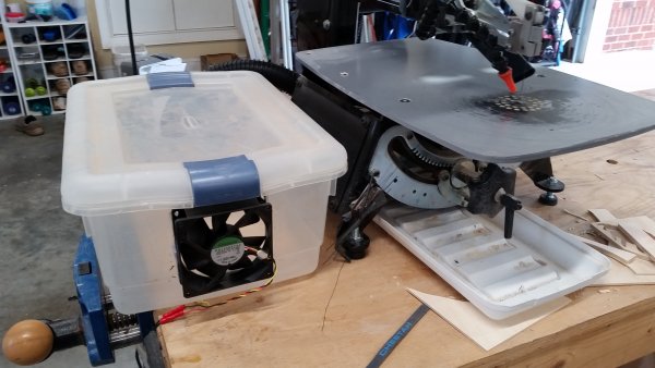

munzieb Posted November 5, 2017 Report Posted November 5, 2017 My wife said to clean up the attic and I had an old computer I pulled the HD and also the 2 blower fans (12vdc). Has anyone ever tired to make a vacuum from one of these fans? I have a 12vdc power supply and they both work. Smaller fan diameter mount is 3.25". I can manufacture a mount and cobble together assorted hoses but what's the point in reinventing the wheel if someone has already done one. Phantom Scroller 1 Quote

munzieb Posted November 5, 2017 Author Report Posted November 5, 2017 OK! I dove in with both feet. I had a bunch of clear plastic containers and a piece of old shop (small) vac hose. A little hot glue, some wire splices and switch a computer fan motor. I hooked it up to the foot switch. I'll probably put the container under my bench. Here it is. Not very strong but it does remove light surface dust and it is very quiet. I may need a smaller container and narrower hose nozzle but it's a first attempt. Heck, it took Edison a hundred try's for tungsten to light the way. Quote
Sycamore67 Posted November 5, 2017 Report Posted November 5, 2017 A little reality check is needed....... A shop vacuum generally has 75-120 cfm at up to 100" static pressure. That is a lot of suction and low flow. A good dust collector can give over 1000 cfm with up to 12" of static pressure. That is lots of flow at lower suction. There are lots of very high end computer fans and there are performance curves for them. But you probably have a fan that gives 35 cfm or maybe a little better. The real issue is the static pressure is maybe 2 mm or less than 0.1". It has almost no suction. The fan might be good for cooling you off but I think you might look elsewhere for a vacuum. tomsteve and amazingkevin 2 Quote
munzieb Posted November 5, 2017 Author Report Posted November 5, 2017 You are probably right. If I make a venture like a carburetor, Would it increase the suction? Quote
Sycamore67 Posted November 5, 2017 Report Posted November 5, 2017 Probably not at all..that fan blade is just not designed for suction and has very low power. Sorry... Quote
