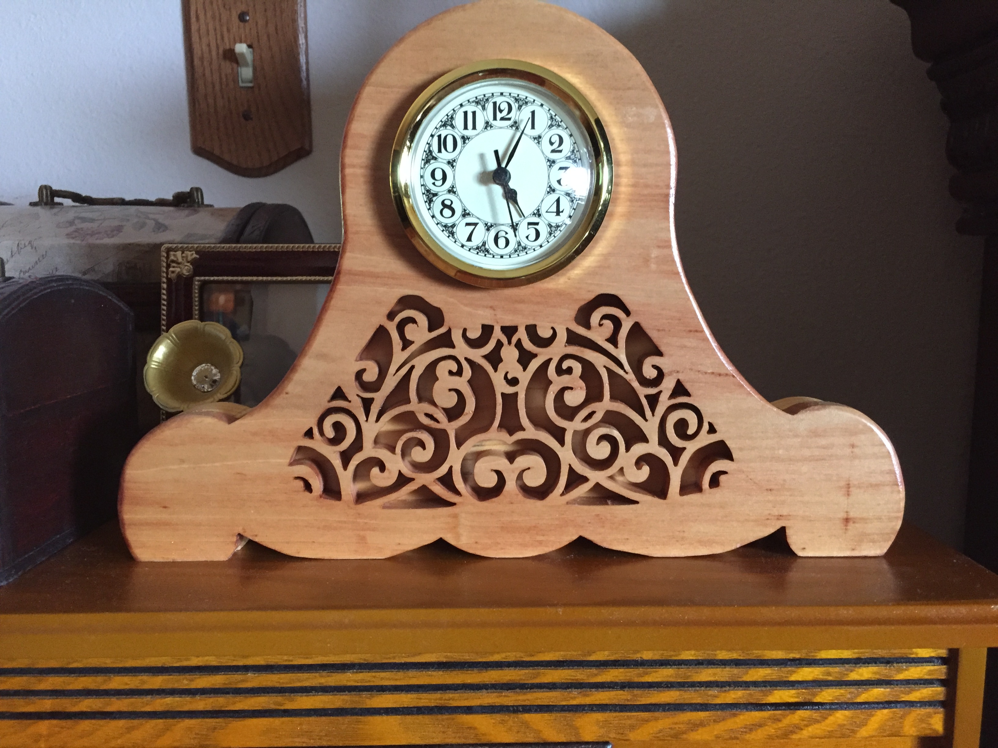

meflick Posted January 14, 2018 Report Posted January 14, 2018 I really can't give you any real advise on the saws. I will leave that to the experts on here who have been sawing a lot longer then me. However, first, I did want to say what a beautiful clock you have crafted and shared here. Second, once you get insight from the much more experienced scrollers on here on saws, I would start out looking for used saws (of any of those recommended by the experts) for sale in your area or in an area you are willing to drive to for pickup. Sometimes you can find a steal of a deal on a used saw if you are looking as shown by several of our friends here in the Village recently. If you can't find any used, then look for buying a new one. By looking first for a used saw, you may get a better saw for a lot less then a new one would run you. The other thing you need to know is your budget. There are saws out here in a large price range - decide what you can afford and look for one in that range, we all have different budgets so what works for one may not for another. There are good saws for all budgets. i will note that I started out with a Dewalt that we had for many years. I then bought a used Excalibur after using one at Judy Gale Roberts' studio when I took her beginner Intarsia class, and then hubby bought me a new Seyco for my birthday/mother's day last year (with in a week of each other usually.) I didn't ask for it, but I am hard to buy for in that I would rather have electronics or tools over jewels, shoes, or clothes so he saw it in the scrollsaw magazine reviewing it and thought it would be a good gift, I wasn't going to say no. The Dewalt was a good saw. I liked the Excalibur better then my Dewalt and have been very happy with the Seyco. The Excalibur and the Seyco are both setup in the workshop. The Seyco is my go to saw. amazingkevin and OCtoolguy 1 1 Quote
