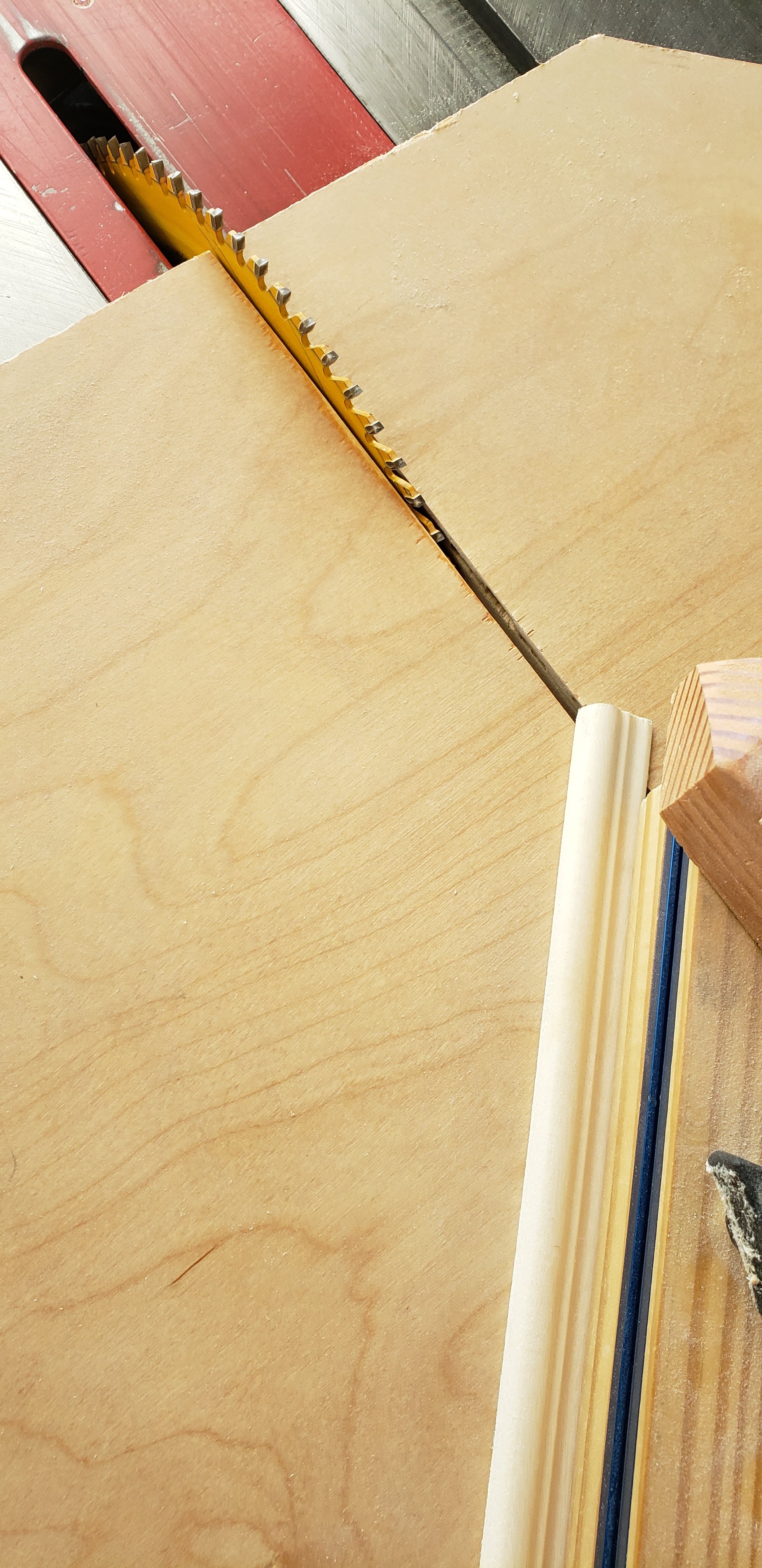

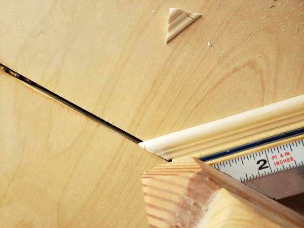

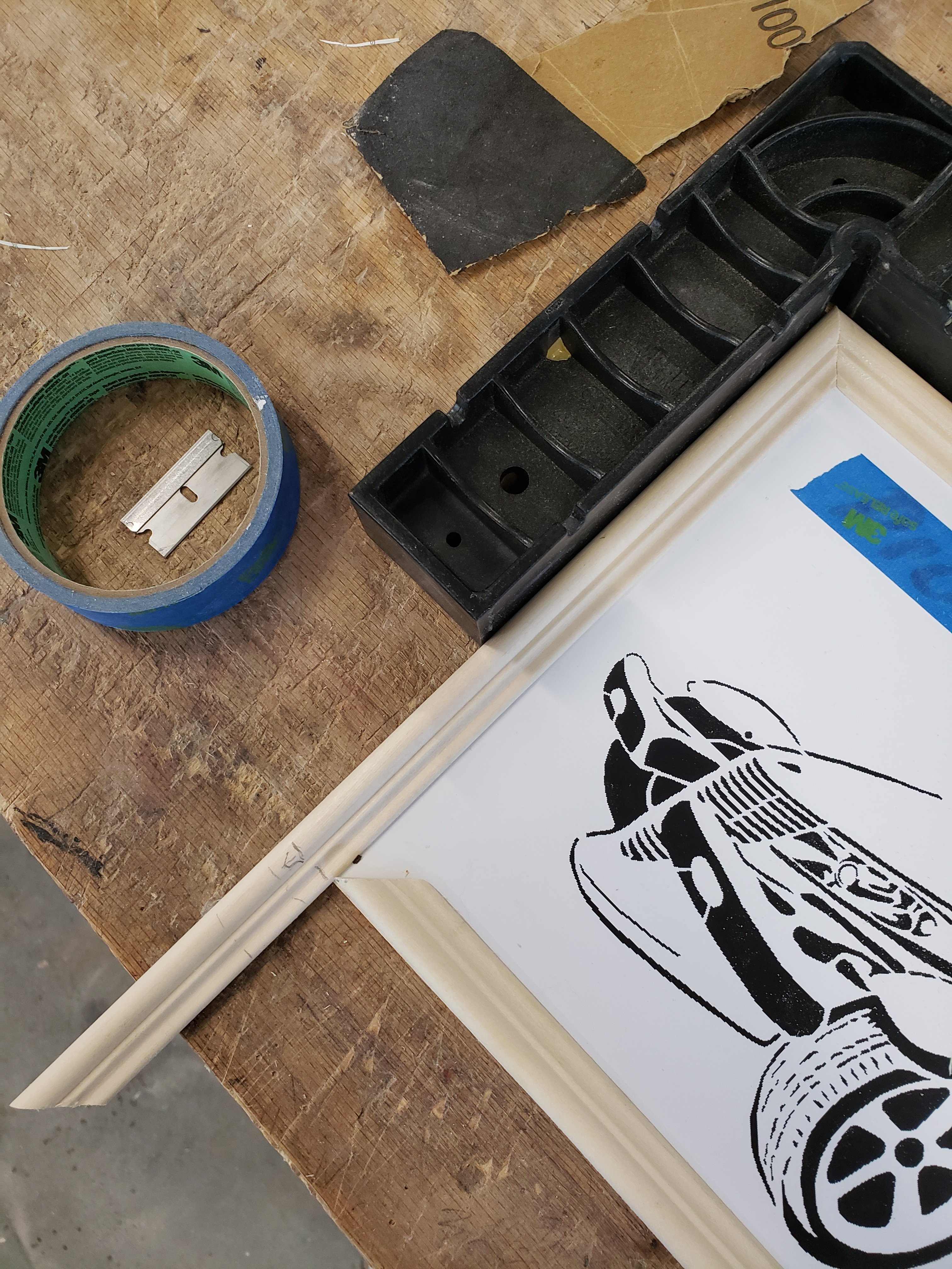

Boy, this can get complicated and there a few people on the site that do framing as a business and probably have tools to make it easier and will probably chime in with some help. For me, I figured early on in my scrolling career, that I would be making a fair amount of plaques that needed frames. Since I have an EX-16, my projects are limited by the throat of my saw. I decided to build a miter sled for my table saw with extensions and stops to make equal lengths. The vast majority of my frames are directly attached to the plaque and backer board with CA glue and pin nails from the back. The frame molding from Lowes, I use is 5/8” wide and 5/16 thick. My plaques are 1/8” and backer is ¼” and my pin nails are ½”. I usually measure either ½ or one inch away from the furthest point on the pattern and add the 5/8” width of the molding to that dimension and draw that out on the pattern before cutting the wood and also backer board. Now the hard part, I use the “sneak technique” for my cuts to get the right fit. I use my table saw with the sled or a good miter with a fence and a band saw with a fence will work also. A miter (chop) saw can work but tougher on small moldings. I’ll measure the length and width pieces of the plaque and add a good inch or 2 to the length and cut them on a 45 miter on both sides to start. I lay the 2 miter cuts (side and top) to abut and measure to the outer edge of the opposite side. (that gets you close to the sneak fit length) Hold down the fitted miters (flush to edges) with 2 sided tape or blue tape and place the other mitered side piece on the plaque flush to the edge and mark the long piece at the point of where the tip of the 45 miter cut touches the long piece (be a little proud to sneak up) and cut on saw. Once you have a good fit, cut the opposite side to the same length. Use the same technique for the side pieces. Once everything fits even, with no gapes and is square, attach to plaque (glue and or pin nail). For picture frame moldings with the ¼” rabbit to drop the picture in, I use the same technique laying the molding groove over the picture to make the same measurement. I know this isn’t that simple and frame stores charge and arm and a leg for the material and the tools they use but once I got the technique down, I can get them done pretty fast. I’ve included the Lowes P/N (8’) for the molding I use and some examples of the frames I have done.
I still haven't got the picture sequencing right yet but the 3rd from last is actually the 1st and move backwards from there until you get to the whole frame. The Lowes P/N and molding profile and some examples are at the end.

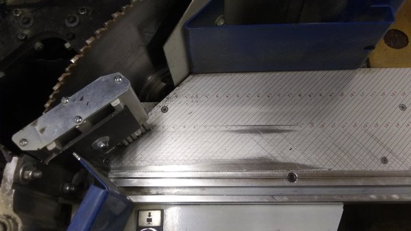

I work for a commercial framing shop. Right now we are about half way though an order for 8,200 7 x 10 art pieces framed with a display rack. That's right over eight thousand frames...ain't got time to screw around. The "secret" is the measuring system and stop. The measuring system is ( on our saw ) a series of diagonal lines (45 degrees from the fence, parallel to the blade (at 45 degrees)). The lines are graduated in inches to 1/8's. The stop is a reverse 45 so that it captures the corner of the frame. To use, the first miter is cut, then the molding is placed so the the portion of the frame that is being measured is lined up with the desired measurement (normally this is the edge of the rabbit) and the second (opposite) miter is cut.
The second half of the measuring system is a yardstick with a 45 degree wing on the left end. To measure, place the cut piece tight against the yardstick, adjust stop as necessary. When satisfied with the  measurement cut the second leg. Adjust stop for the other measurement, repeat. We normally add 3/32 to the nominal size to allow for movement.
Here is a picture of the out-feed table showing the diagonal lines and the reverse 45 stop:

This is a close up of the measuring system on a commercial saw, the same system is used on an ancient trimmer (uses a straight blade to cut, foot powered)  :
20200408_074712.thumb.jpg.070f5236587c2e166db0114d01b2a09a.jpg20200408_074659.thumb.jpg.605934c2d76a77698b46d0097fade7c5.jpg
