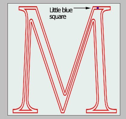

JimErn Posted May 11, 2020 Report Posted May 11, 2020 (edited) 28 minutes ago, don in brooklin on said: Thanks. Do you know how the amount of offset works? I wanted 1/4 inch borders and It did not work the way I thought. I experimented with 1 inch square that I converted to path. Changed preference to .25 inches. The new square was 1.667. added a 1/3 to each side. Thanks I create a square, at the top settings bar set the width and height to .25 inch, move the square so it sits inside the top edge of the figure, duplicate the image, then use dynamic offset and adjust the new graphic to touch the bottom of the square. Edited May 11, 2020 by JimErn Quote

don in brooklin on Posted May 12, 2020 Report Posted May 12, 2020 2 hours ago, JimErn said: See if this helps any Hi Jim Cool way to do this. I tried and changing the width to 13.49 px achieved the same results of the way I did it. Thanks for the tip. Fab4 1 Quote
