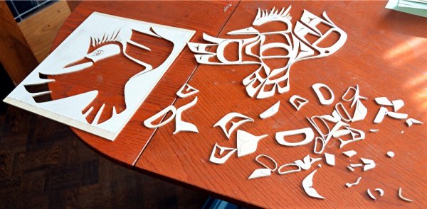

Parts Cut:
First of all, I decided to do this as a complete segmentation rather than resorting to a the use of cut-outs showing painted backer board in a few places.  This resulted in a few very small parts.  Cutting had to be very precise and I could not have accomplished this without the great pattern that FrankEV made for me using Inkscape.
Below is a photo showing all the parts.  There are about 65 parts and it took me between 3 and 4 hours to cut them..
    1528519559_Kingfishersegmentation-Allpartscut-small.thumb.JPG.8323efc6f03a92fe43807040d5d1750c.JPG
Here is a photo of the part that comprises the entire primary formline:
     2133283674_Kingfishersegmentation-Primaryformline-small.thumb.JPG.6ac88ddfa6c8d9e5e8ea5eb987008304.JPG
Notice that, as it should be, the entire primary formline is one contiguous part.
Edited by Frank Pellow
