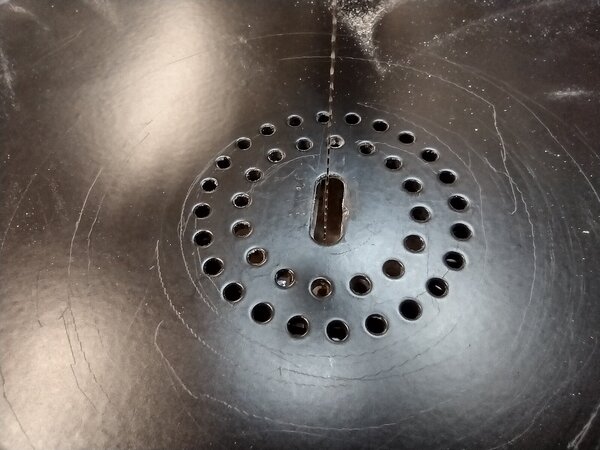

ronallo Posted December 15, 2023 Author Report Posted December 15, 2023 TL;DR: I think it was mostly a combination of the blade contacting the table (bad!) and the stand not being sturdy enough (cheap!). Thank you all for the helpful suggestions. When I took another look today, the first thing I noticed was what is pictured: The throat of the saw had a gash in it in the place where the blade evidently was rubbing when angled. I had to deburr around it a bit for wood to slide on the table without catching. So I think the blade rubbing directly against the table may have been part of the issue increasing vibration. The table was being cut along with the work piece. (Those modified geometry Pegas blades sure can cut.) While the table can probably be adjusted to the left or right a bit, I still don't see how it is possible to cut at anywhere close to 40 degrees without the blade contacting the table with as narrow as the opening is. While the dust collection is excellent (if super loud!) and there's no potential bump transition from the table to the throat plate, I'm now wishing the table allowed for replaceable zero clearance throat plates which could be swapped out for different angle cuts, similar to making zero clearance plates for the table saw. Maybe there's some adjustment or other misalignment I'm missing, but I can't see that there's enough clearance to cut at sharper angles. Do other scroll saws with solid tables without a replaceable throat plate have this kind of issue with the blade rubbing against the table? Are there other issues with tables with replaceable throat plates? Wondering how much this will annoy me and if I might try to get a different, compatible table with a throat plate, but that may have its own annoyances. Looks like some of the older Excalibur saws had a wider opening for the blade than the current crop of similar saws. Maybe I just need to resign myself to cutting into the table until there's a nice groove there for the angled cuts I want to do? It didn't appear as if anything else was rubbing when at an angle, except the "Protection bracket-Down" (part 94 here: https://qtena.com/images/90750 parts diagram A.jpg), which appears to be a bracket similar to the hold down bracket on the top. It sits in a different position against the table when tilted. That might have exaggerated the vibrations some. It seems as if this part isn't necessary for the saw the function, but it does appear challenging to potentially remove it without other disassembly. Seems fine to remove if I can figure out how, right? I did try running the saw while slowing tilting the main body under the table to the left away from the dust collection port. The vibration did pick up once I got past about 15 degrees and continued to increase through the arc to about 30 degrees where I stopped. I didn't want to mar the throat of the table any more by tilting it further. I cut some scrap at 30 degrees. Even at 30 degrees with a bit of pressure on the blade to the right and the blade appeared as if it would touch the table. The vibration while cutting was not as bad as I experienced the other night, so seemed possible to stay on my line. Still not as vibration free as at 90, but workable. With this test I did find that the stand the saw is attached to was shaking more as the head was angled more. The stand is mounted to a universal mobile base of which two wheels still contact the ground, and the wheels are in the same direction as the motion of the saw. Being on wheels can't help any, especially in that orientation. The metal of the stand legs vibrated; it just doesn't seem sturdy enough for that lateral motion. I think I need to work out a better stand. I had the speed up about half way, which has been where it has been most of the time I've had the saw. It has felt comfortable enough for anything I've done before. I lowered the speed some and that helped a bit with the vibration at the expense of speed of cut and potentially, at my skill level, accuracy of cut. Finally, I checked the upper arm distance to the table and it appears to be so close to perfect that I dare not try to mess with it yet until I try addressing other issues. In any case, the tiny ash bowl I started which brought me to all of this is coming along nicely. With as rough as the cut was, I sure learned a lot about how to sand inside a bowl. OCtoolguy 1 Quote
OCtoolguy Posted December 15, 2023 Report Posted December 15, 2023 Regarding your stand, both of my saws are on stands that I built out of 2x4's with a plywood top that tilts. The read legs have 7" wheels. The saws both sit on foam rubber fatigue mat rubber. Zero vibration. After looking at your picture, I see the problem. The pass through hole is far smaller than either of mine. Mine are not worn. They are just larger. I think yours is either made wrong or that's how Pegas is making them. I'd take a die grinder and hog it out. But before doing that check to make sure the table is not mounted upside down. The hole should be beveled on one side. Quote
