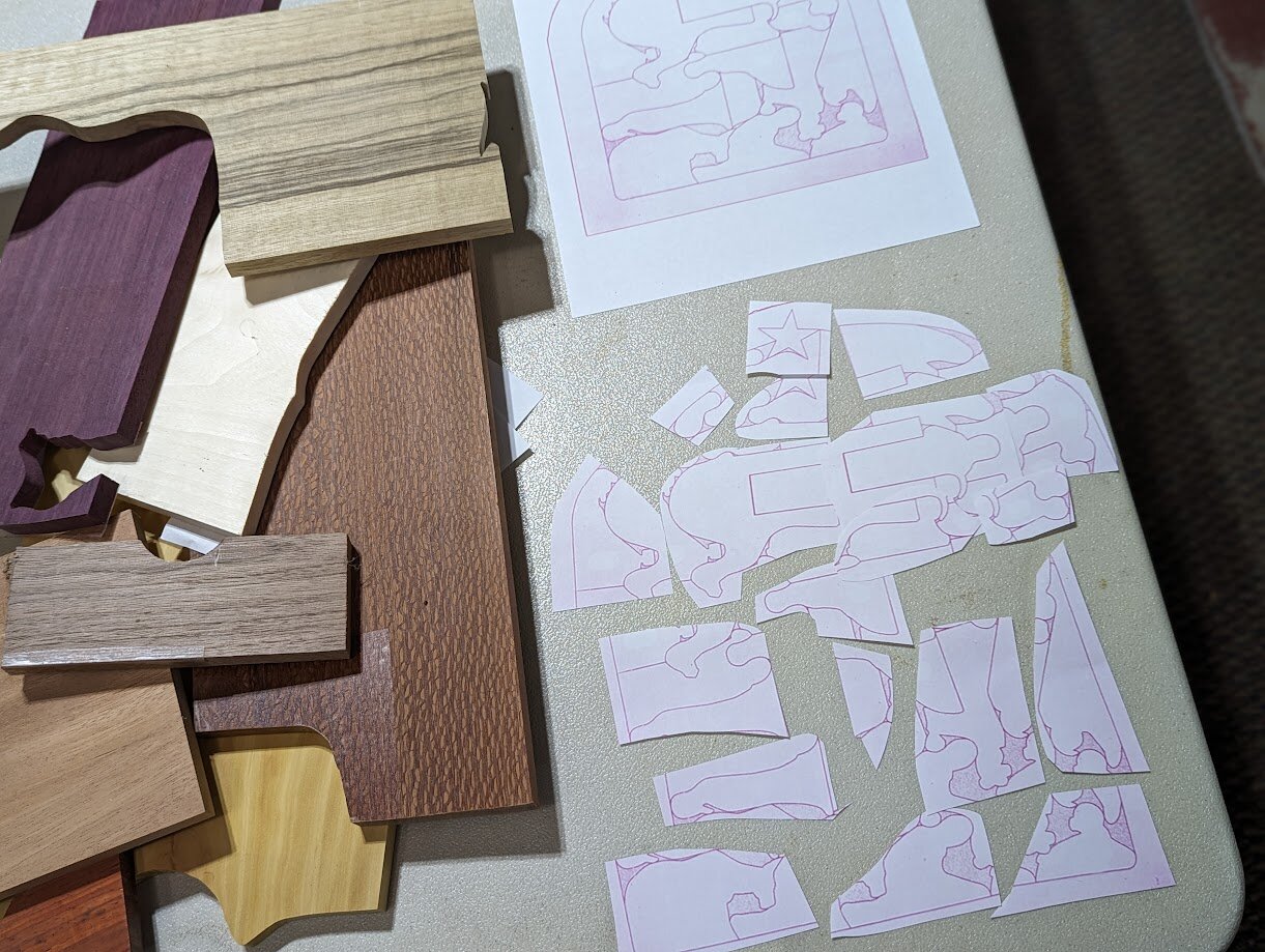

rafairchild2 Posted August 30, 2024 Report Posted August 30, 2024 I am taking 5 days leave from work, as I am #1, tired. Also, come September things are going to get nuts at NATO, per usual this time of year, as new military personnel arrive, and other folk come back from leave. So this is not Intarsia or Segmentation, but I use some of the same techniques, thus my posting here. In particular, I use intarsia cutting techniques, so the exact line cuts so pieces fit as if they were cut from one piece of wood. In reality, this is how I cut all my work. I strive to cut my lines accurately. This is a nativity puzzle that will be a gift for my grandson. I will use 11 or 12 different species of wood for this one. It's a great way to thin out my cast-off pile. As you can see by the photos, I start with 5 or 6 copies of the pattern and then cut out and glue up each piece with a pattern part. I am using Elmer's repositionable glue, as I did not want to use shelf liner and #m spray. I put the pattern on, cut, then immediately take the remaining pattern off. I am using a #9 Flying Dutchman Ultra Reverse blade. This gives me a very large kerf, so all I need to do is split the line and it will all fit together as you can see from my stopping point tonight. Each piece will have its edges profiled slightly on both sides, as that visually makes it look better vs the 90-degree that you see right now. I intend to show you the progress of this nativity, as I work my way to the finished product. TAIrving, JackJones, ChelCass and 2 others 5 Quote

rafairchild2 Posted August 31, 2024 Author Report Posted August 31, 2024 Okay, got all the pieces cut out, and will be profiling them shortly. But first is the frame/tray. I am going to cut the perimeter first as I have a 4mm piece of baltic birch as the backer. Then I will take them apart and do the inside cuts. I plan on trying to save the interior so I can have all the pieces from that 'scrap', perhaps I'll paint them. You'll see some pencil lines, I plan on cutting 'indexes' in what would normally be scrap areas, and blank. First, I am taking a nap! Quote

rafairchild2 Posted September 1, 2024 Author Report Posted September 1, 2024 So here's the frame cut out, just a few touch-up sanding points as it is a tight fit on a couple of pieces, then comes profiling which will make it look better, and hide my bobbles. You can see some of the 'indexes' I cut, this way pieces hold in much better and give a couple hints on some of the pieces. If you look at the 'scrap' wood, you can see where I used some of the waste areas for blade turns. I was using the 9 FD UR, should have gone with the #5 I would have gotten sharper turns on the star. I will be staining the frame once it is glued up. Pieces will get the linseed oil dip. JackJones and barb.j.enders 2 Quote
