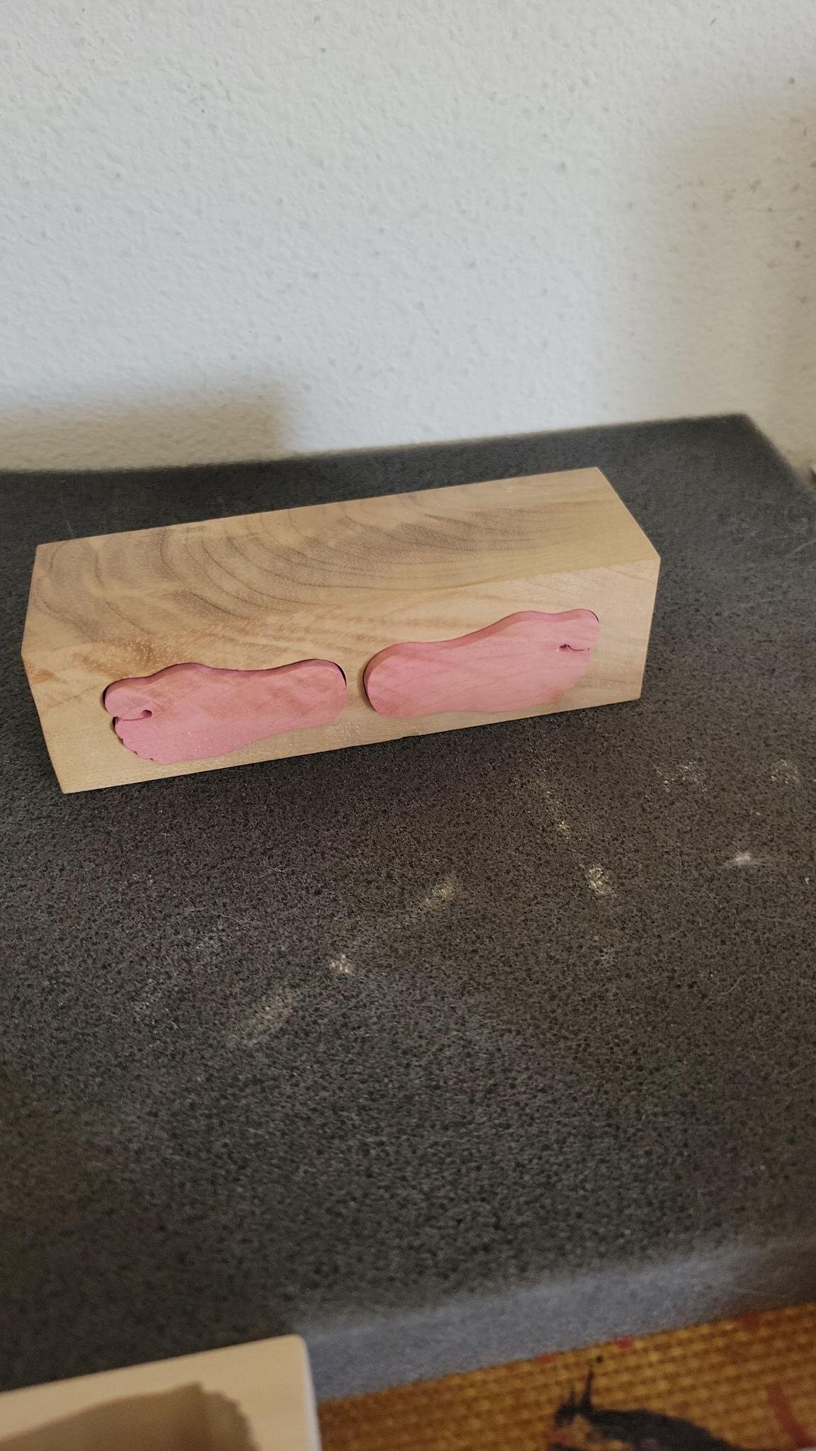

If it is for toys for younger kids I used food coloring.  Birthday cake coloring for pink. I actually had to soak the piece of wood overnight to get the color deeper.  The pic of feet drawers used this method.  Myrtle was the wood I used.
