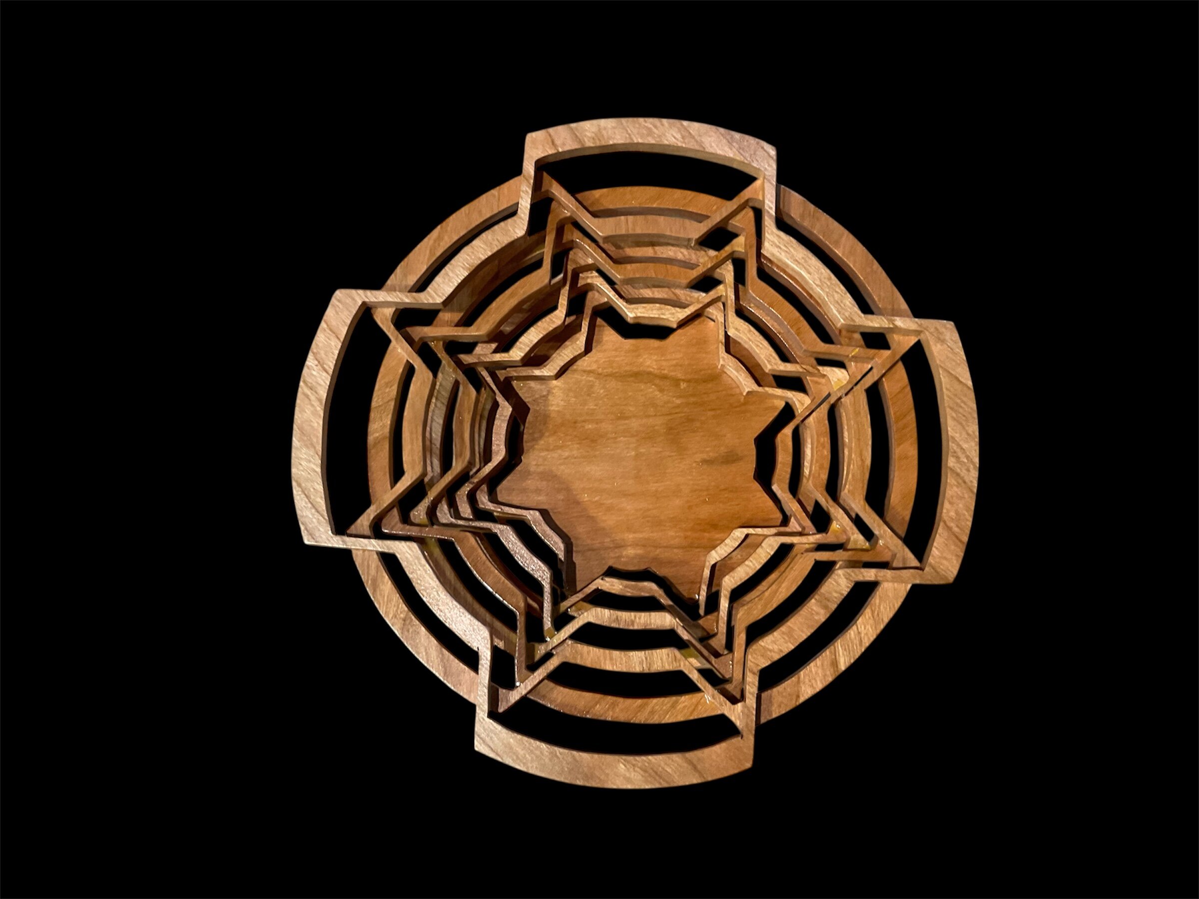

Popular Post Denny Knappen Posted September 2, 2025 Popular Post Posted September 2, 2025 Another Alex Fox Basket C275. This is my favorite design which is why I took the picture from the top. I used 1/4"solid Cherry 8" square. Cut on the Pegas Scroll Saw using Pegas #0 Super Skip blades. After sanding, glue each ring, let dry, then glue another. A coat of spray Shellac, another sanding with a Mac Mop, and a final coat of spray Lacquer Clear Gloss. Comments welcome. BadBob, Dak0ta52, artisanpirate and 9 others 12 Quote

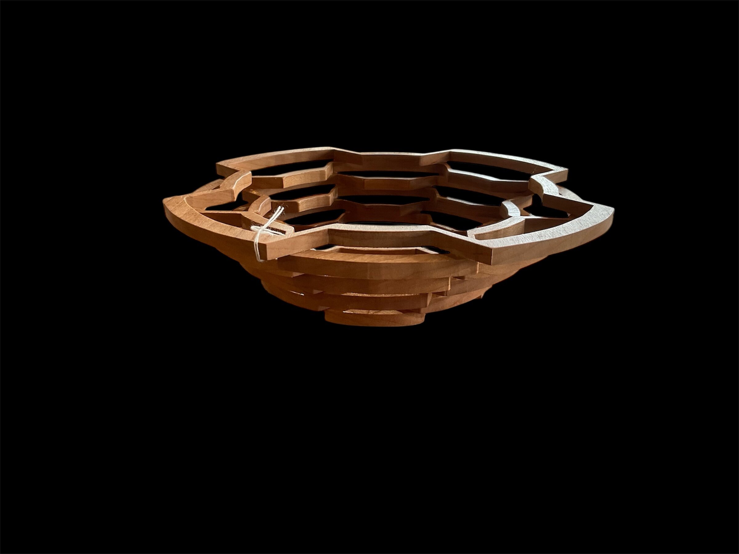

MarieC Posted September 5, 2025 Posted September 5, 2025 Denny, that looks like a great basket. Can you post a picture of it from the side. Thanks. mc Quote
Denny Knappen Posted September 5, 2025 Author Posted September 5, 2025 23 hours ago, Matt B said: I just ordered this pattern. Is there a reason that you use a #0 skip tooth blade? I normally use a MGT 3 for almost all my cuttings as it is the most comfortable for me. Hi Matt. I wanted the smallest kerf possible and the #2/0R MGT tends to break. They don't make a #0 MGT, so I went to #0 Super Skip blade, About the same tpi but no reverse teeth. This is not a problem as I have to sand each ring separately. Quote
Denny Knappen Posted September 5, 2025 Author Posted September 5, 2025 11 hours ago, MarieC said: Denny, that looks like a great basket. Can you post a picture of it from the side. Thanks. mc Hi Marie. Just for you. MarieC 1 Quote
