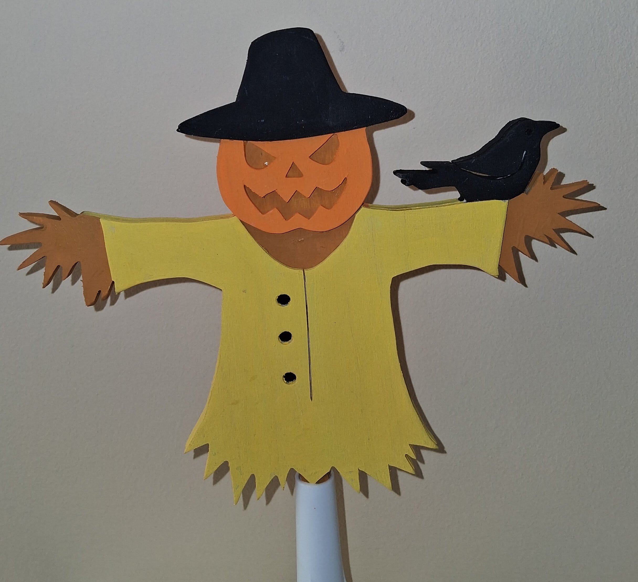

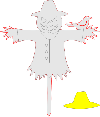

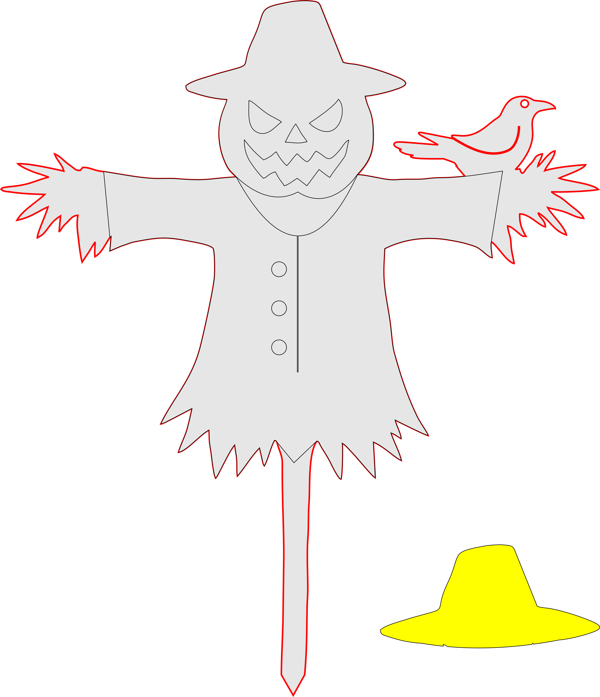

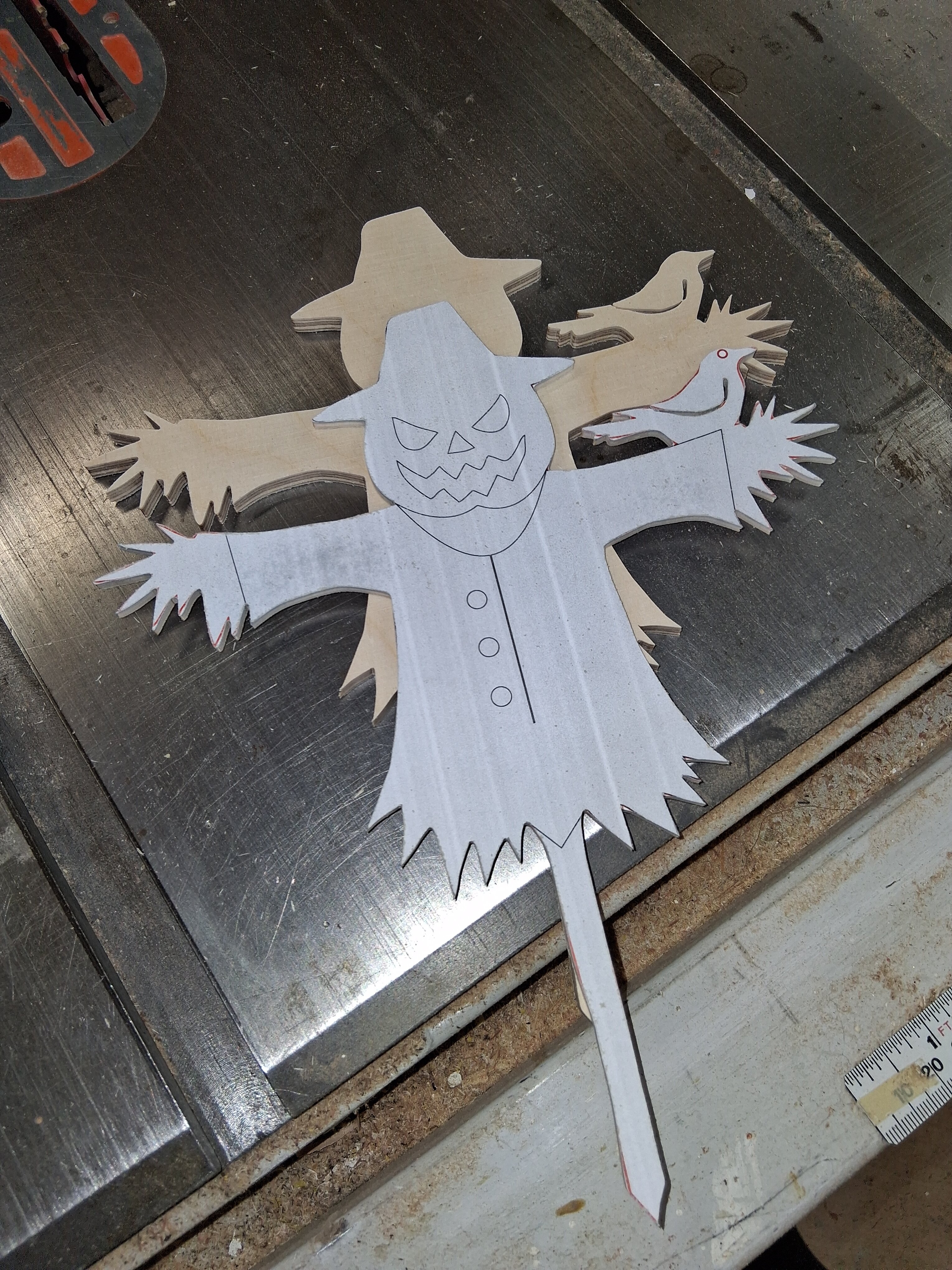

don in brooklin on Posted September 20, 2025 Posted September 20, 2025 (edited) I recently made the Steve Good's scarecrow below. (it is not in the catalogue but link is https://www.stevedgood.com/scarecrow2025.pdf The original pattern has a backer and the coat, hat and pumpkin are overlays. If you are careful and cut exactly they will match but if you go off the the line a bit the glue up will be off. So when ever I can, I cut the outline of the overlays at the same time as the backer. This is how I did it. 1. Import into Inkscape the pdf (pages 6 - 7 for the larger version.) 2. Set snapping on and move the overlays to the appropriate locations. 3. Select the background only, I change the stroke from black to red with a width of 2 px. 4. Stack -(I tape edges) add pattern to 1/8 in and stack with 1/4in. Now cut the red line and separate. , 5 Cut the 1/8 on black stroke. When you glue up it will match Edited September 20, 2025 by don in brooklin on Dave Monk, BadBob, Be_O_Be and 6 others 9 Quote
Dan Posted September 21, 2025 Posted September 21, 2025 Good details. I've seen where someone would cut put the pattern on the 1/8", cut just the interior cuts (eyes, mouth, etc.) then glue the 1/8" to the 1/4" and cut the outline. Either way would get the job done. Quote
JTTHECLOCKMAN Posted September 21, 2025 Posted September 21, 2025 (edited) I have always cut both same time. That is a scrollers tip that has been passed down for many ages. Seen that when I started some 40 years ago and it works well. Always good to repeat some of these type tips. Edited September 21, 2025 by JTTHECLOCKMAN Quote
BadBob Posted September 21, 2025 Posted September 21, 2025 9 hours ago, JTTHECLOCKMAN said: I have always cut both same time. I was wondering why he didn't do that. Quote
JTTHECLOCKMAN Posted September 21, 2025 Posted September 21, 2025 4 hours ago, BadBob said: I was wondering why he didn't do that. I do not know. It just makes sense. Quote
Hudson River Rick Posted September 22, 2025 Posted September 22, 2025 @don in brooklin on GREAT tip Don. Thanks for sharing. Rick Quote
Denny Knappen Posted September 22, 2025 Posted September 22, 2025 When the backer is the same as the pattern, I cut the interior cuts of the pattern, glue it onto the backer, then cut the perimeter. Roberta Moreton 1 Quote
