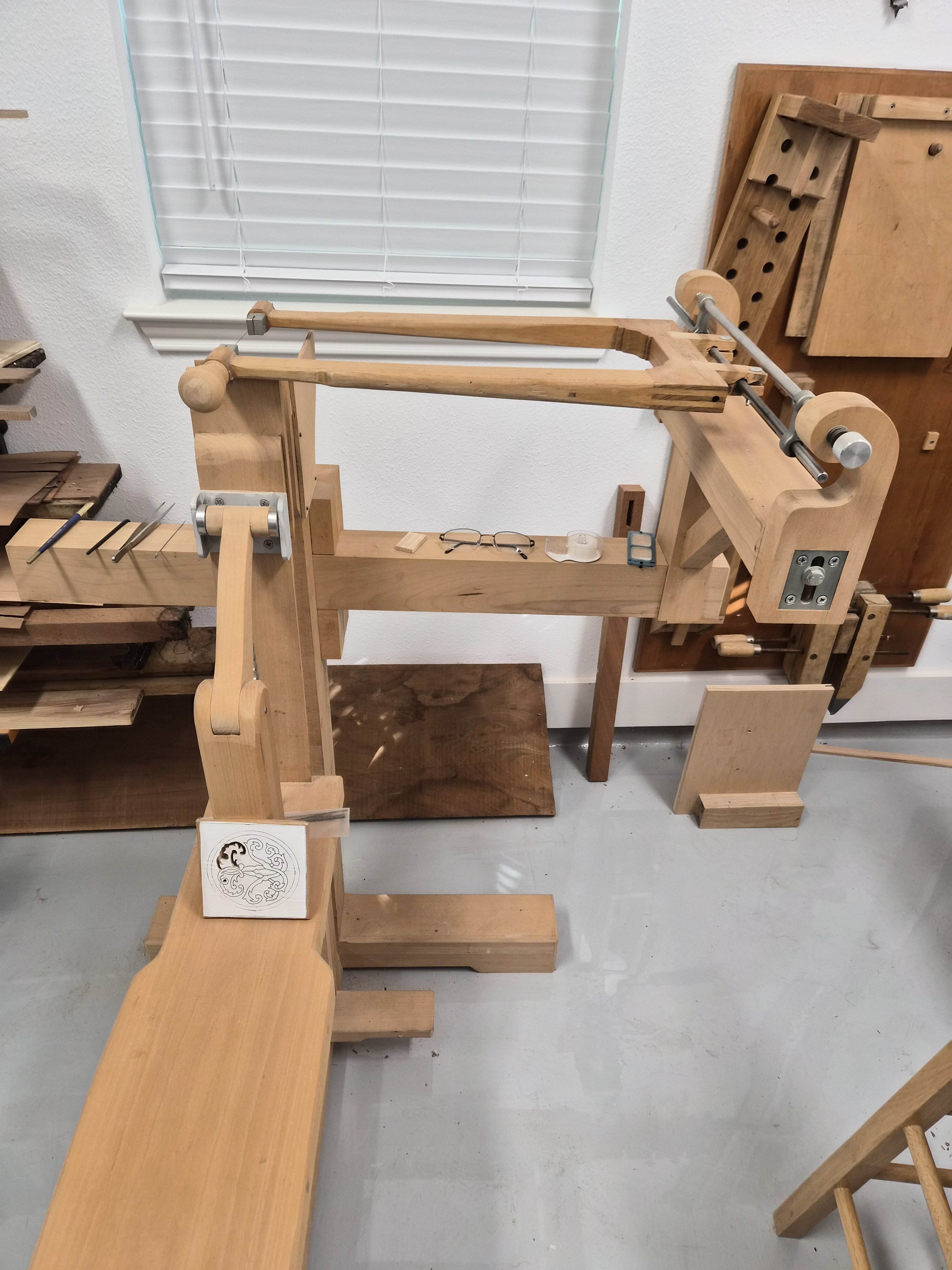

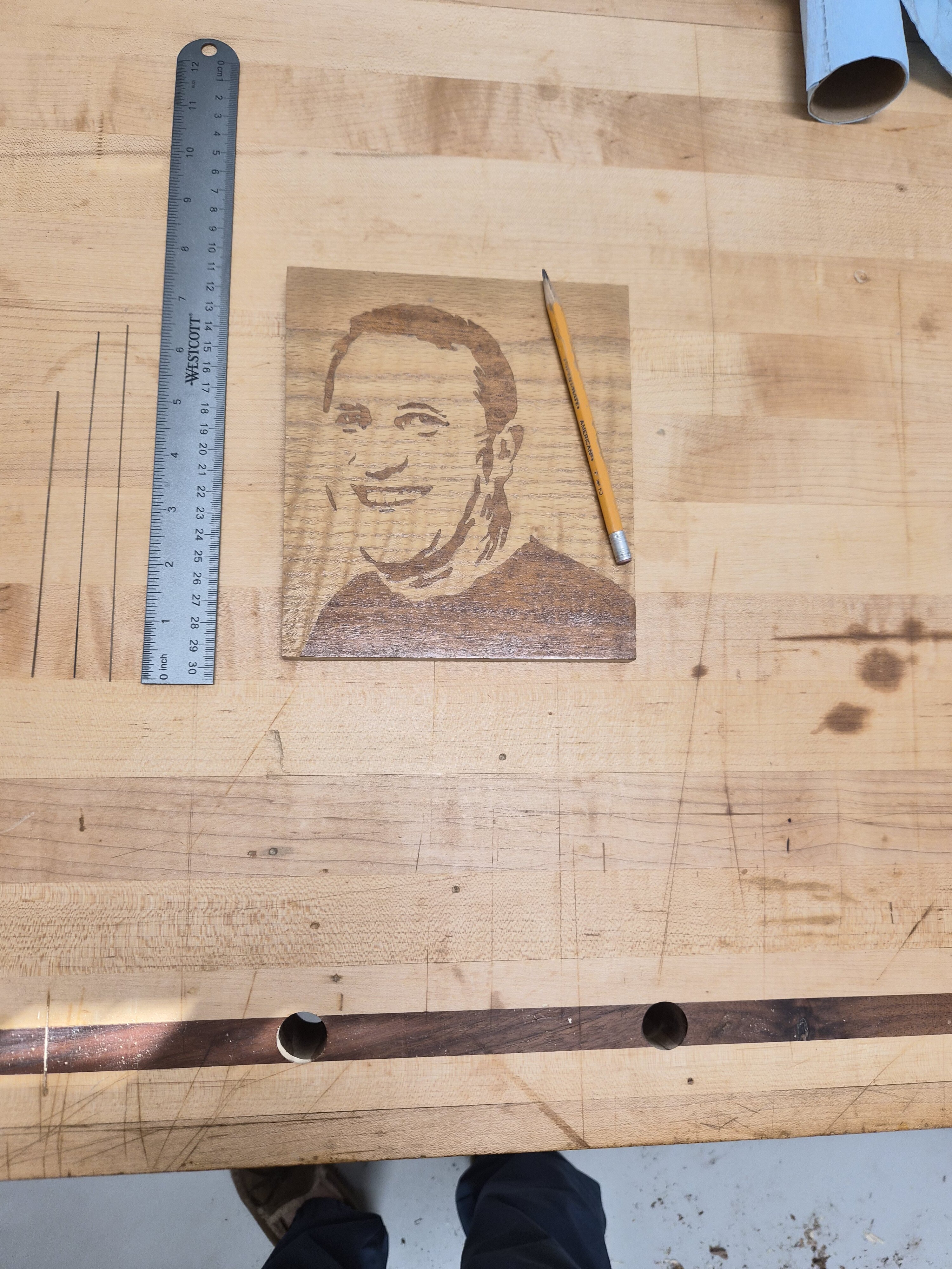

Timbo2 Posted November 14, 2025 Posted November 14, 2025 Hi there, I would like to learn how to add detailed Marquetry onto furniture pieces much like Silas Koph does. If you haven't seen his work, check out youtube or his website. Fantastic. So I've done a bit of traditional Marquetry on my Chevalet (sometimes known as a Donkey). The attached picture was one of my first pieces from 15 years ago. One can attain great detail if accurate. This tool is designed to cut multiple pieces in a single stacked 'packet' of say 6-10 pieces, with the packet being held vertically (saw blade horizontial). You wind up with 3-5 examples of the same picture, except that each piece will have different pieces (species of wood) making up the same picture. Although the blades are very thin, there's still a kerf between pieces due to vertical cutting, which is dealt with by adding a 'mastic' of sawdust and glue (hide glue in my case) to the back of the piece crammed into the kerfs. In any event, sawing a highly detailed and accurate piece (say 18"x24") on it would be very difficult especially since you can only use one hand to move the workpiece as the other one is used to move the blade back and forth. Hope this isn't too boring. Then I tried a 16" or so Craftsman scroll saw. While OK, it vibrated like a devil for the detailed work I like to do. Then I tried double bevel fret saw hand cutting which was much more satisfying, but might be very difficult in the larger pieces I hope to make. Which leads me to consider: A high quality deep throat scroll saw, like a Hawk 226VS which I have my eye on, but no practical experience. So questions: Is a saw such as this smooth enough to accomplish what I wish to do? I do note that Silas Koph uses an electrical scroll saw. And what blades should I search for to use? I envision perhaps building an 'outflow/overflow' area around the saw table to support the piece while cutting. Good idea? I note that the scroll saws use generally 5" blades. Note the 6 1/2" Chevalet blades in the picture (2 on the right). Could these be used in this type scroll saw without expecting them to break in a few minutes? JackJones and OCtoolguy 1 1 Quote

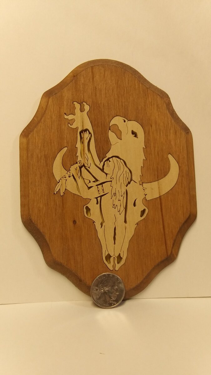

Wichman Posted November 16, 2025 Posted November 16, 2025 I would urge you to at least look at the Hegner scroll saws, available with up to a 22" throat, speed from 400 - 1700 spm and the ability to change between a short stroke (.47") for more control to a longer stroke (.75") for faster cutting/cutting in thicker materials. As for blades, blades are a very personal choice, you will need to try a variety of blades to see what style and manufacturer fit you and your style of cutting. Here are some numbers to consider #2/0 blades fall in the following range, about: Width 0.023" thickness 0.010" with 30.5 TPI. Jewelers blades are available in much smaller sizes #8/0 Width0.013 thickness 0.006 ( I'm not sure if I could see those blades let alone mount one in the saw ). And finally here is an example of what a #2/0 blade can do, 1/2" pine blank, the Native American design was cut out and removed from the blank, the blank was stained for contrast and the figure glued back in, quarter for scale. Cut with a Hegner @ 800 SPM, long stroke: OCtoolguy, Scrappile, JTTHECLOCKMAN and 2 others 4 1 Quote

Gonzo Posted November 16, 2025 Posted November 16, 2025 13 hours ago, Wichman said: I would urge you to at least look at the Hegner scroll saws, available with up to a 22" throat, speed from 400 - 1700 spm and the ability to change between a short stroke (.47") for more control to a longer stroke (.75") for faster cutting/cutting in thicker materials. As for blades, blades are a very personal choice, you will need to try a variety of blades to see what style and manufacturer fit you and your style of cutting. Here are some numbers to consider #2/0 blades fall in the following range, about: Width 0.023" thickness 0.010" with 30.5 TPI. Jewelers blades are available in much smaller sizes #8/0 Width0.013 thickness 0.006 ( I'm not sure if I could see those blades let alone mount one in the saw ). And finally here is an example of what a #2/0 blade can do, 1/2" pine blank, the Native American design was cut out and removed from the blank, the blank was stained for contrast and the figure glued back in, quarter for scale. Cut with a Hegner @ 800 SPM, long stroke: Wow, very impressive Wichman! Wichman and OCtoolguy 1 1 Quote
